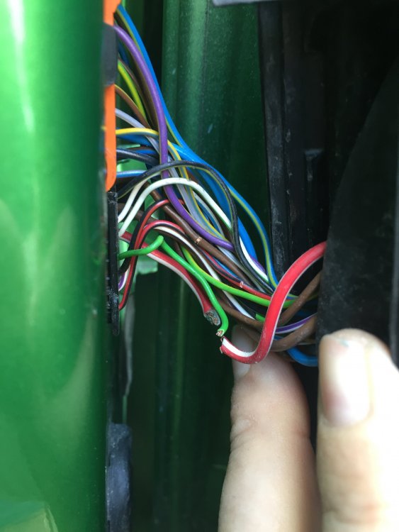

When I brought the car both driver and passager windows were working fine without any issues, after a while the windows stop working, so I have checked the fuses which were fine then I have checked the driver cable and I found out that some cables were broken, so then I replaced the cable with a new cable using the serial no from the old cable.

The issue only started after the cable got broken on the driver side, which is strange that inside of protection bunch of the wires were broken due to the hard plastic around the cable and some of them were the main power to the window motor, but this doesn't make sense why the passager side is not working, as I have replaced the driver cable + motor.

Hi its a while back for you but.....did you ever get a fix?  I have almost exactly the same problem   not tried the removing the passenger fuse to see if that affects the driver side..    All motors work - like you I can drive the windows down/up with the key in the lock.  stripped  the door switches - they are  clean and look good.   But windows dont work using either switch.     All since the wires broke at the door hinge....   I fitted a brand new door harness.
