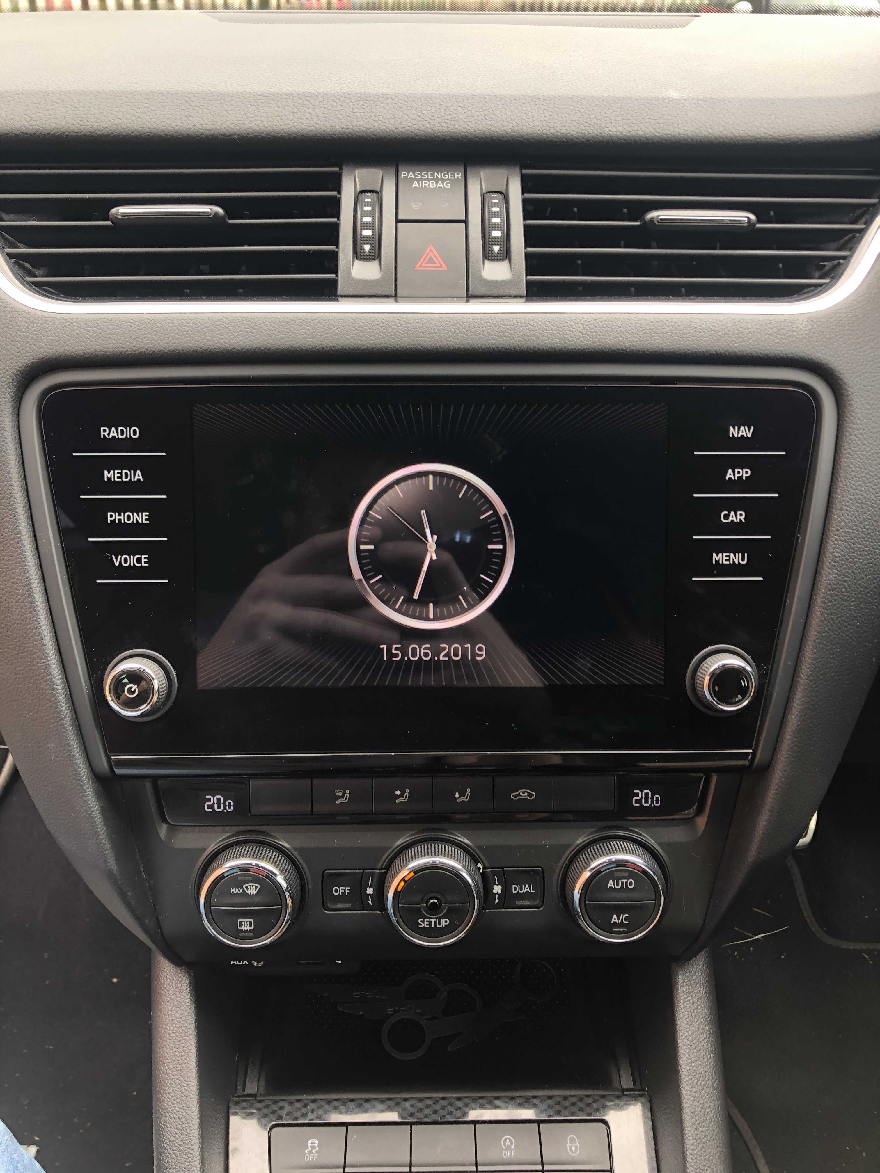

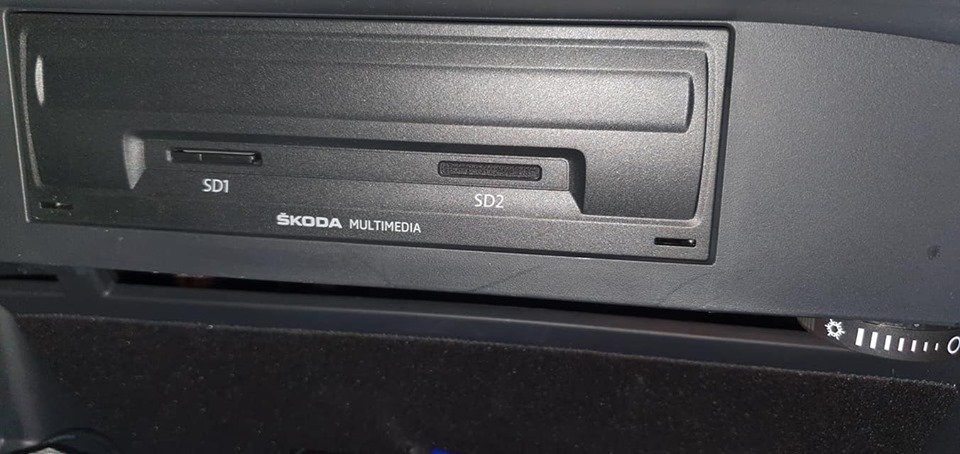

Component protection sorted this morning, how do I update the nav card, been on Skoda portal but it won’t show any nav updates as my vin doesn’t have nav associated with it, do I just need to use a vin number that does? Other than that everything seems to be working,
Edited by Dan77
You don’t need a VIN, you can do it form a link or go to VW as they have the new maps. Pawel will do that for you if you ask, just leave the card in it.

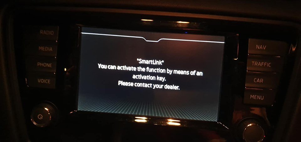

Got the radio back, the smart link doesn’t seem to be working when I plug my phone in, just says “please select a device” am I missing something obvious?
What are plugging in? IPhone by any chance?
Yeah,
Have you installed the new USB port? If so you have to change a setting in 5F from USB to USB iPod for it to work
Ah ok, so I just need to get VCDS on it then?
Yeah, it’s a 10 second change if you know what your doing. Think it’s Byte 19 possibly?
How do I get the nav instructions to display in the maxi dot?
1 - Box Module 17- instruments- Code (25327)
2 - Extended Coding
3 - Byte 10
4 - Enable Bit 6
Everything is coded and working now, thanks to Sasha for the advice and Pav for getting it working, only thing that doesn’t seem to work is the “App” button on the screen, I’m guessing this is supposed to open the smart link,
The APP button doesn’t work unless you have used the 5Q0035874C radio unit. You can get to SmartLink via the menu.

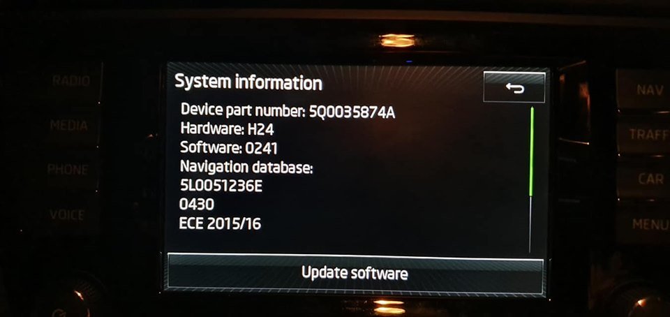

Hi sorry to jack your post, could someone advise me best course of action to be able to play video's or activate the smart link? Vehicle is an 2015 Octavia VRS and pretty sure its the 5Q0035874A Amundsen system.
