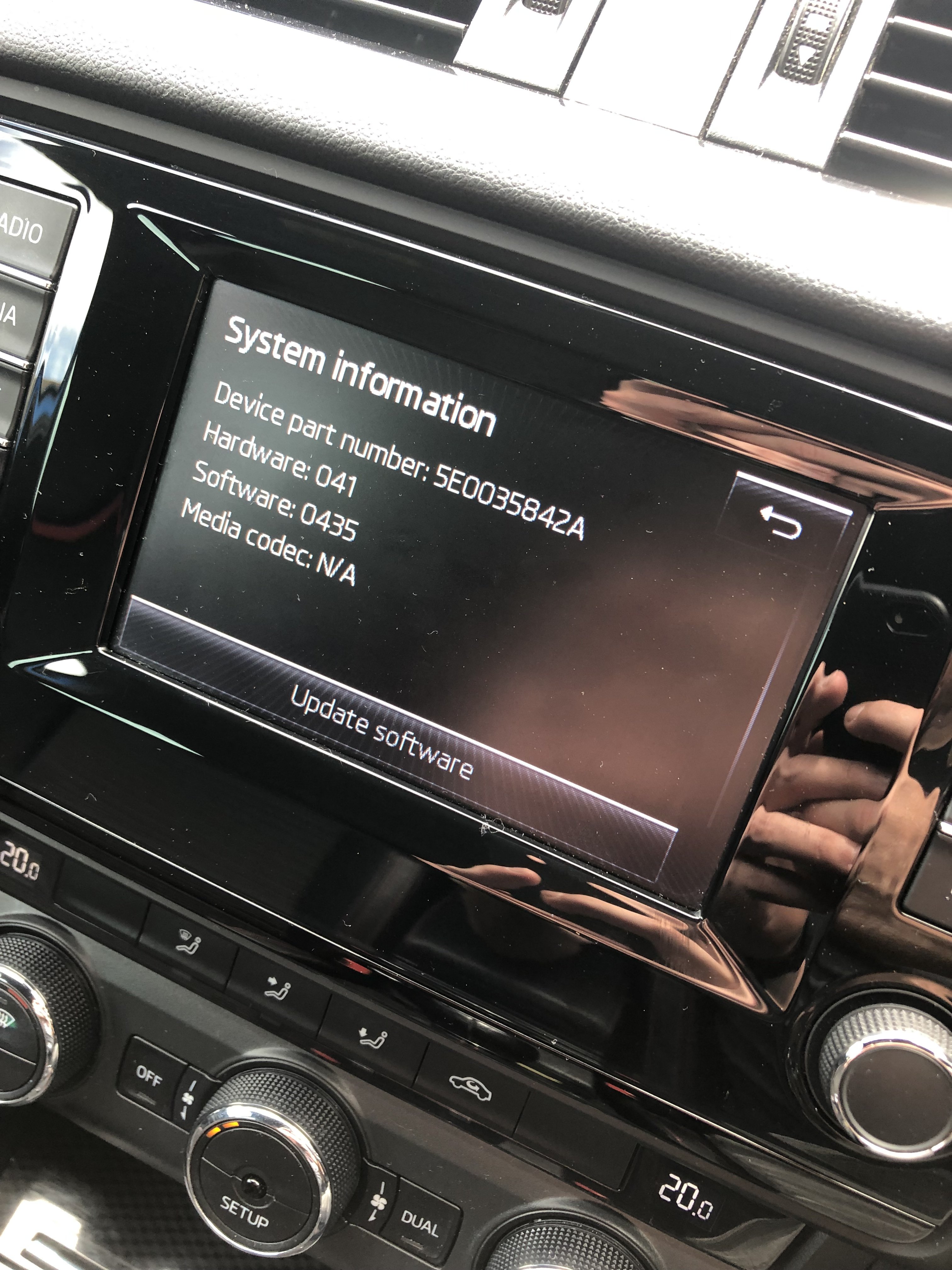

From what I’ve heard on here my car is not compatible with smart link, as the car doesn’t have sat nav either I’m thinking a smartlink upgrade is the way to go, is there any guides that anyone knows of that will explain what I need to buy, I’d like one of the larger screens if it’s possible, but don’t want to spend an absolute fortune, pic below shows what I’ve got at the moment,

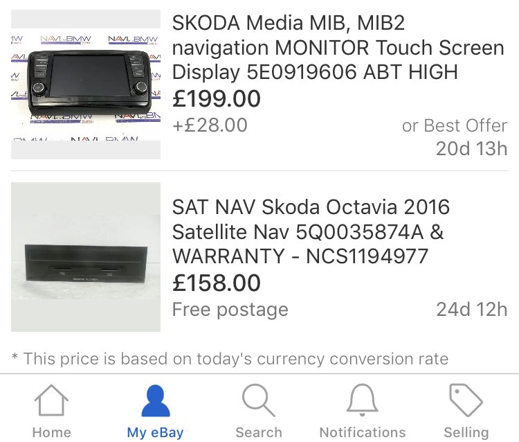

I’ve been doing a bit of reading on here, can someone confirm/correct me if I wrong, that these parts will get the job done?
eBay item numbers: 264305616150 and 401767109638
also does any have the part number for the USB plug as I see that that needs changing too
one more question, do I need to change the screen or will the current one be compatible with a MIB2 unit?

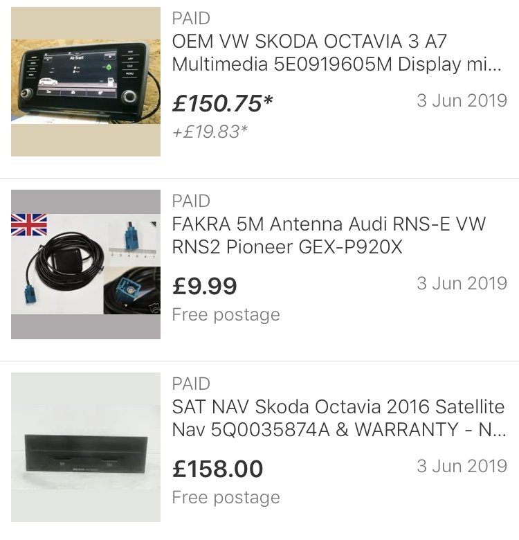

You need a 5Q0035874A Amundsen, the B revision one will not work, you should be paying about £1-140 for one of these and about £8 for a FAKRA GPS antenna from eBay. The screen you have linked is a MIB2 Bolero screen, if you want the best combo with an Amundsen you either need a 5E0919606 Pre FL Columbus 8 inch screen or a 5E0919605M FL Amundsen 8 inch screen. Both will work, expect to pay about £2-250 for one of those. You need a 5Q0035726E USB. Your current screen is not compatible with a MIB2. Once you have the right parts the radio needs to have the Component Protection removing and then I suggest you contact Pab567 on here and he will be able to sort the radio out to work :)
Cheers Sasha, just browsing eBay now, do these look good to you? Do both parts needs component protection removing?
Screen looks decent, radio could be a little cheaper but it’s not out of the ball park. Only the radio needs CP removal, the screen is just a screen.

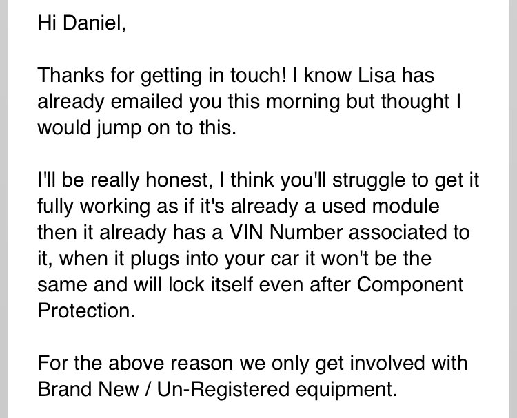

I’ve already messaged pav on here but I’d thought I’d try somewhere local as well, this was there response:
 Are they right? Or are they just not as good as pav?
They are probably right in that they cannot get it to work.  Doesn't mean it can't be done.  Send it to Pawel.  He is a genius with it.

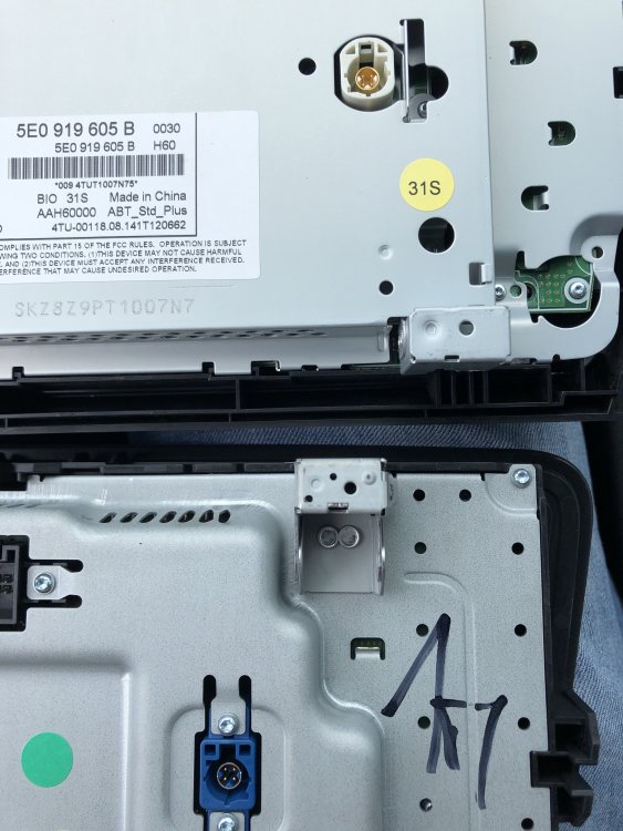

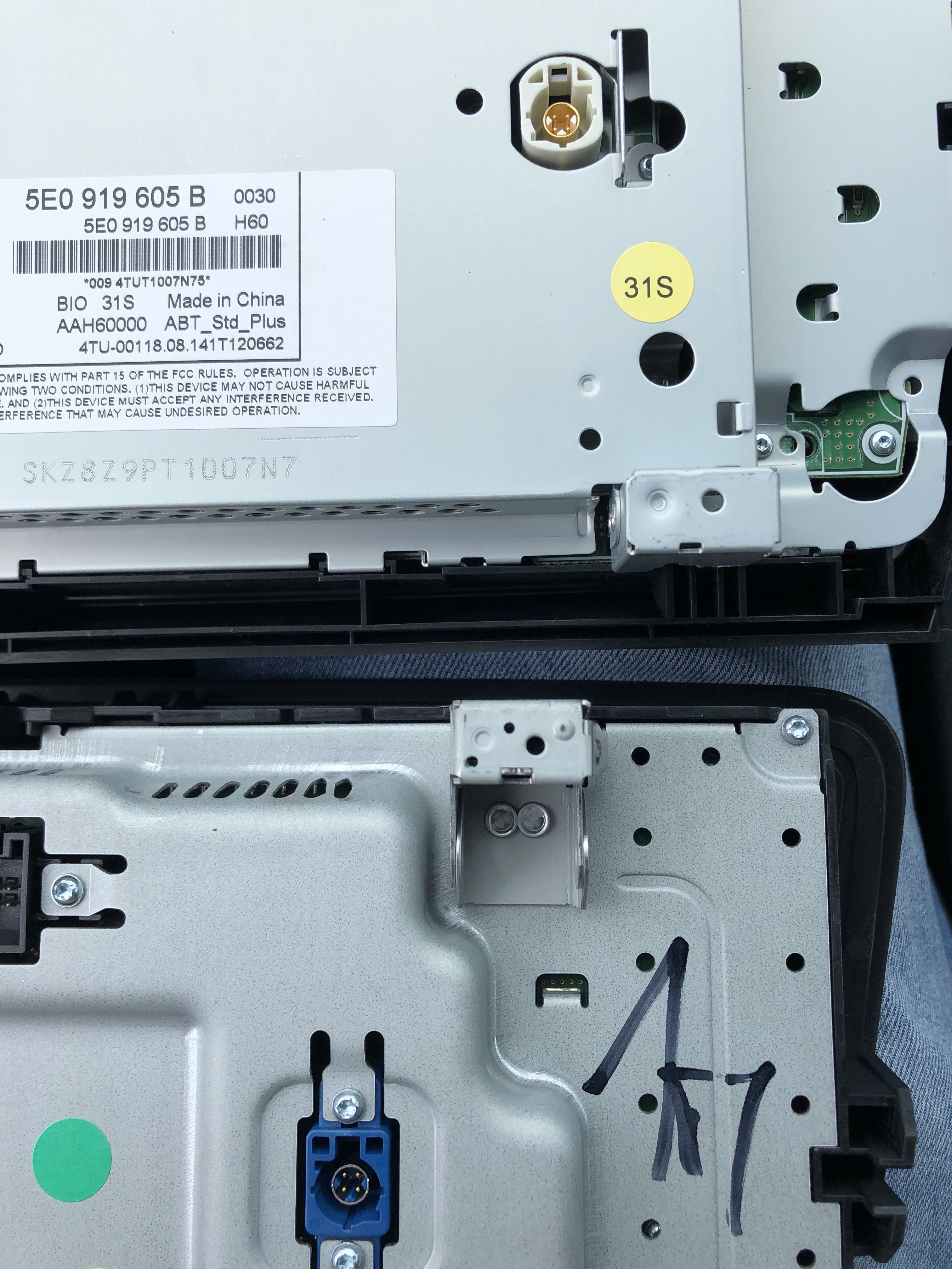

New screen arrived, but connectors are different? What do I need to do, thought it was plug and play? image.thumb.jpg.1ce4e3636b478b3857e37b9bb7bdcb12.jpg
You need to get your sharpest knife out and trim the plug on the cable.  Its just the two tabs on the 45 angles that need doing the rest can stay.  I guess its just another one of those things that they have done to get in the way.
Cool, no need for a new plug then. Just got to wait for it to stop raining!
