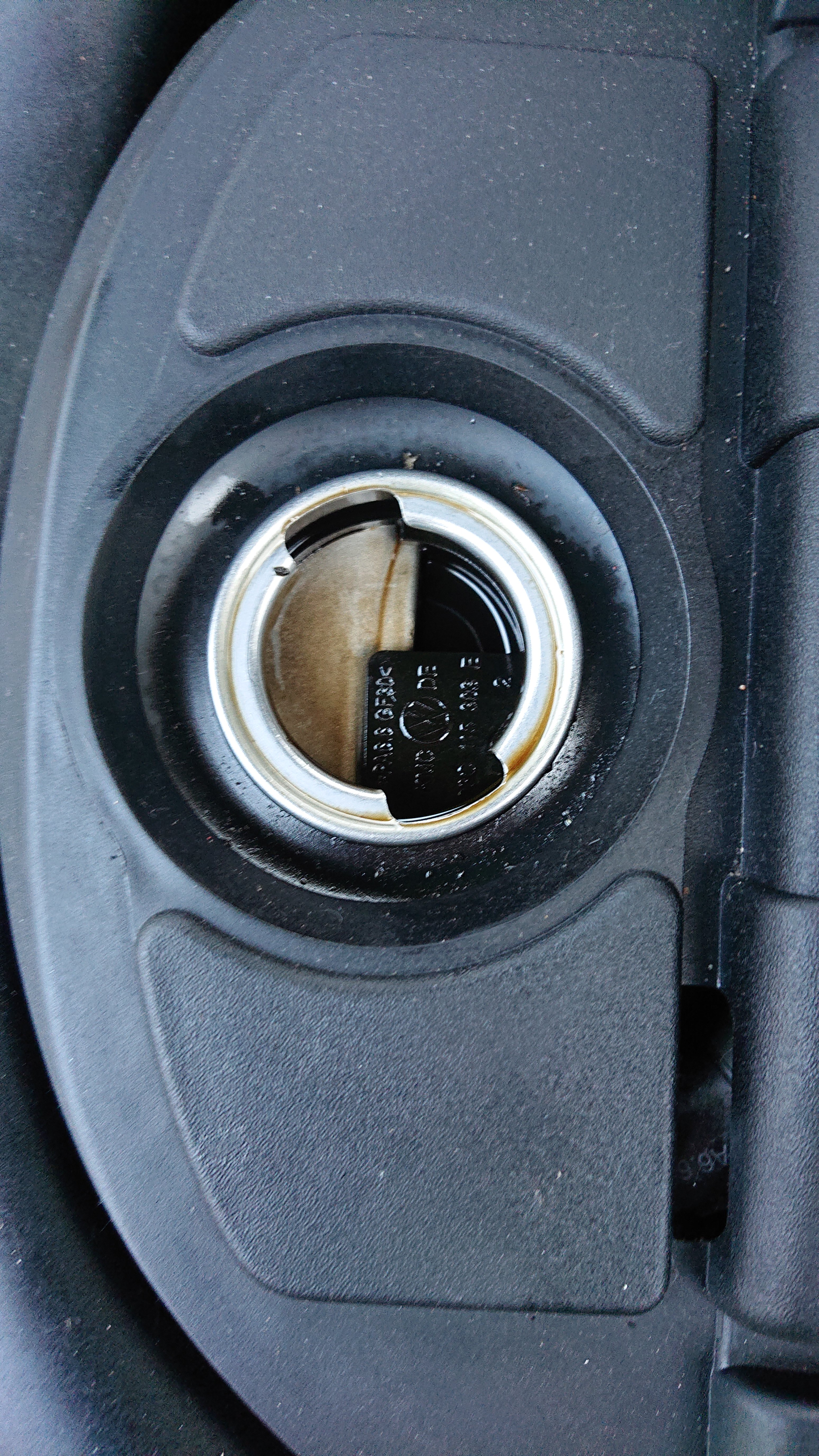

Hi,
I've come to top up the oil in the car and noticed this strange black credit card looking thing blocking half the opening.
Is anyone able to shed light on what this is?
Thanks
Don't worry its supposed to be there, Have no idea why mind you.
Thanks just going to have to be patient filling it then.
Welcome.
The 3.6 litres or a bit more if needed goes in just as quick as you top up any oil in any car.  Carefully.

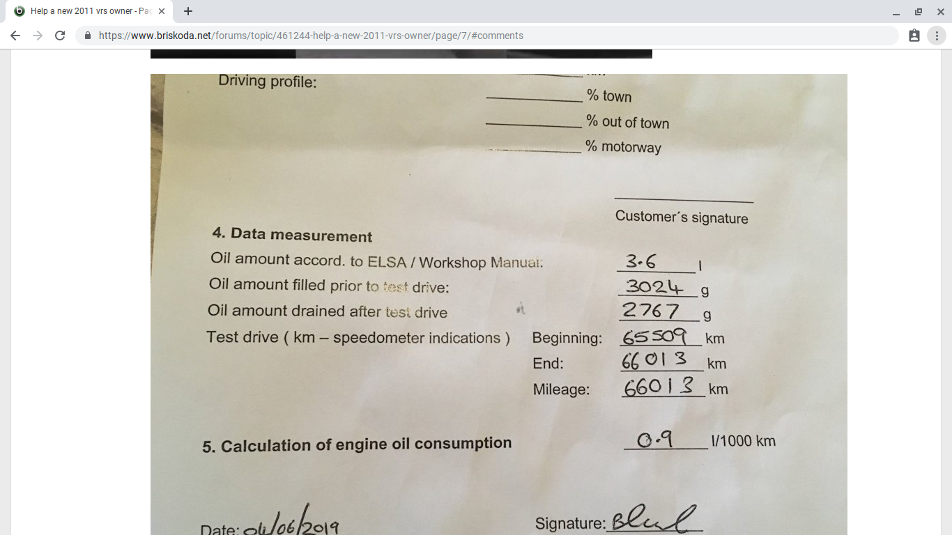

http://briskoda.net/forums/topic/461244-help-a-new-2011-vrs-owner
See page 7 and the Oil Consumption test that was paid for.
Some Dealerships have employees that are no more fit for purpose than the engines in cars they sell.

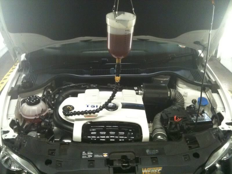

EXAMPLE
of an Oil Consumption test done by an idiot that did not know the actual weight of the engine oil.
Last week another member posted the report he finally got which was all nonsense as well.

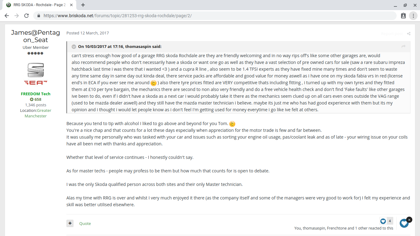

Dealer is RRG Skoda Rochdale, topped it up myself now and will probably be back there within a week again.
You had best Email the Dealer Principal, ask for a phone call or meeting, tell them you have an oil user.
They have enough experience of them.
They have replaced engines in cars they have sold and ones that came to them sold by others.
A member on here was a Master Tech and replaced engines, knew about them, knew his job but has moved on,
others will be getting great service i would expect where he works.
