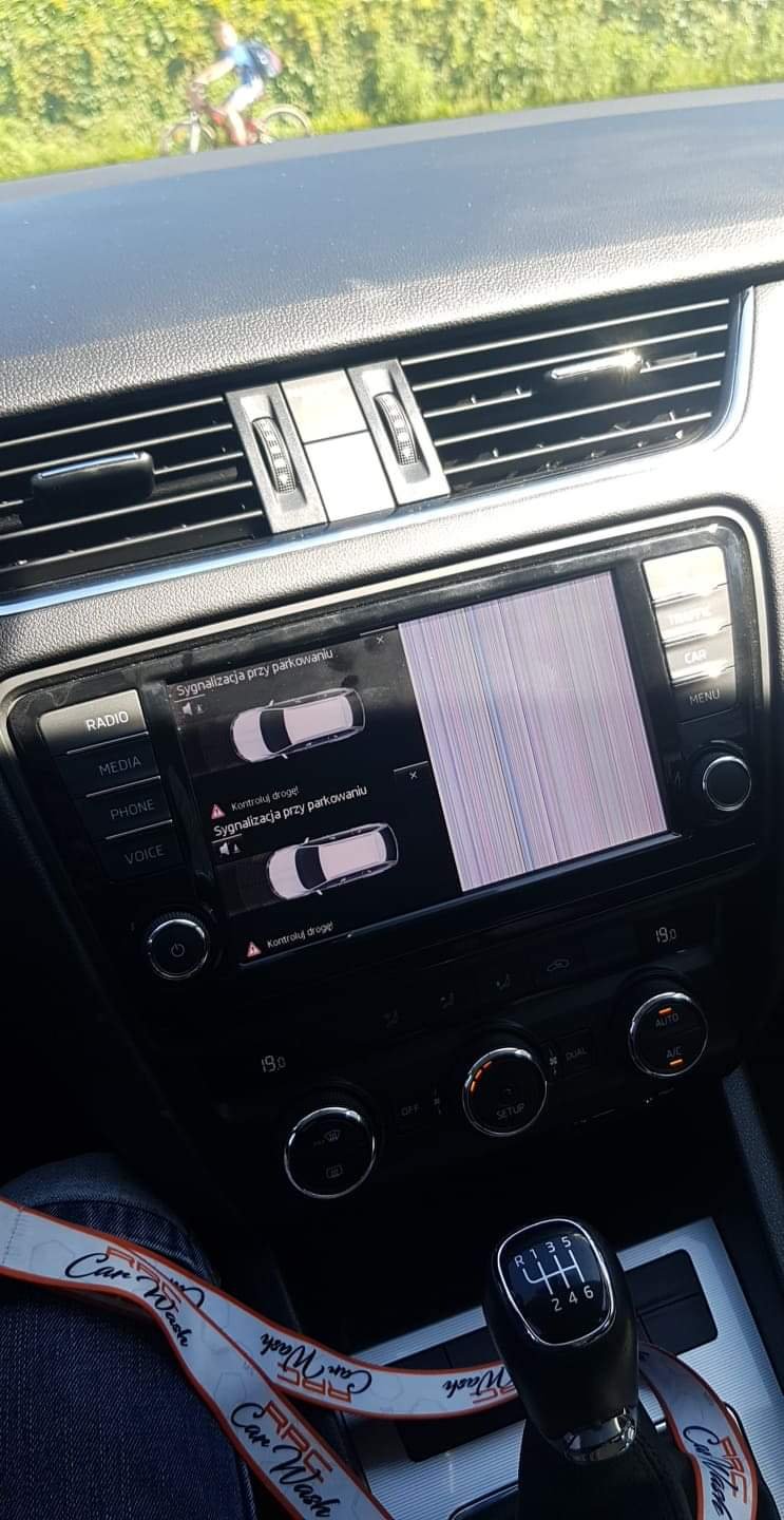

Hello,
I've changed my display Amundsen MIB1 to Columbus MIB1 but  the screen is divided.
I've heared that I must update my software and will be okay, but it's not. (This solution worked for others who has made change like me)
Any solutions how to solve that problem?
Cheers
Yes replace the screen for a MIB1 Amundsen screen, or retrofit a full MIB1 Columbus setup, or retrofit a full MIB2 Columbus or Amundsen setup. This cannot have worked for anyone changing only the screen on a MIB1 setup.
MIB1 Amundsen has half the resolution of a MIB1 Columbus, so what you see is expected; the output display is half that of a Columbus. Later MIB2 Amundsen had the same resolution as Columbus but on a slightly smaller screen, so it's fine using a Columbus screen to replace Amundsen for MIB2.

Amundsen MIB1 has 800x480 - same like Columbus MIB1. Always when you've made change like mine this screen is divided, but when you do the update after that all working perfectly - that's checked solution. I'm thinking about to do a downgrade my software and update again.

It isn't the same resolution for MIB1.

Becauase the solution you're looking at is not correct for you. Hardware differences between MIB1 and MIB2 mean you can't use a software upgrade to change the hardware.

Well, what's resolution is in Columbus?
Columbus is 800 X 480 for MIB 1 and MIB 2. Amundsen MIB 1 and Bolero MIB 1 are 400 X 240.
Amundsen MIB 2 is 800 X 480 same as Columbus.

As above, MIB1 Amundsen resolution is 240x400, Columbus is 480x800. This also happens if you plug a MIB2 Amundsen display into a MIB1.
