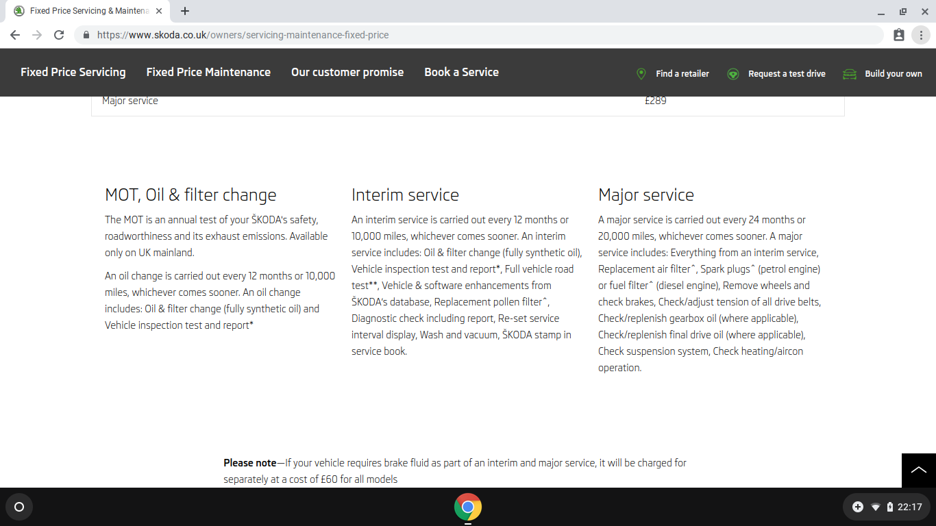

Main Dealership Servicing at Fixed or Variable Service intervals does not include doing anything to the the brakes other than a visual inspection.
(Major service says 'Check Brakes'.??? Is that at the road test, certainly not on a brake tester.  Usually comes with a recommendation you need new discs)
The Manufacturers Recommendations / Guidelines is the Brake Fluid changed at 3 years then each 2.
That is not part of the Service Regime and not part of Service Plans.
You have to ask for it and pay for it if not offered it.
As you have to pay to get Brakes Serviced.
UK Main Dealership Fixed Price Servicing that some might do, 3-10 year old cars.
Many cars never have wheels off for years unless tyres getting changed...
