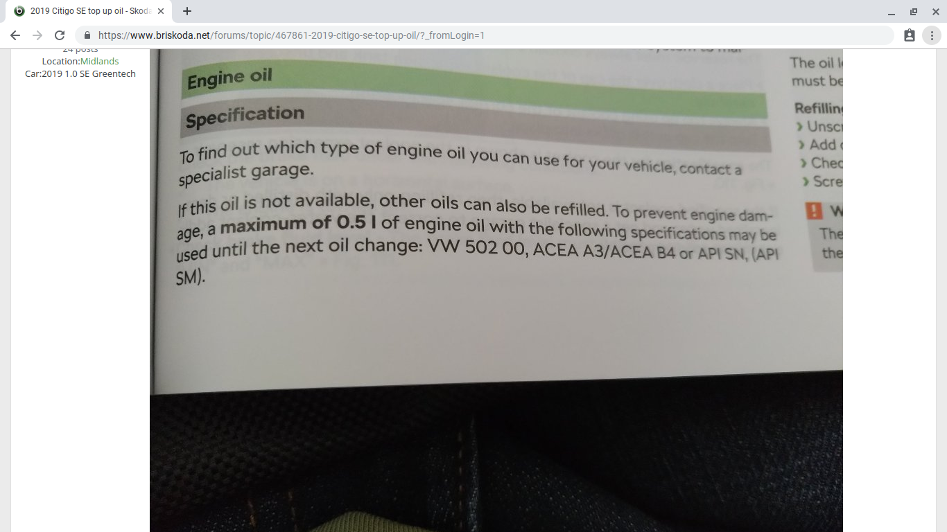

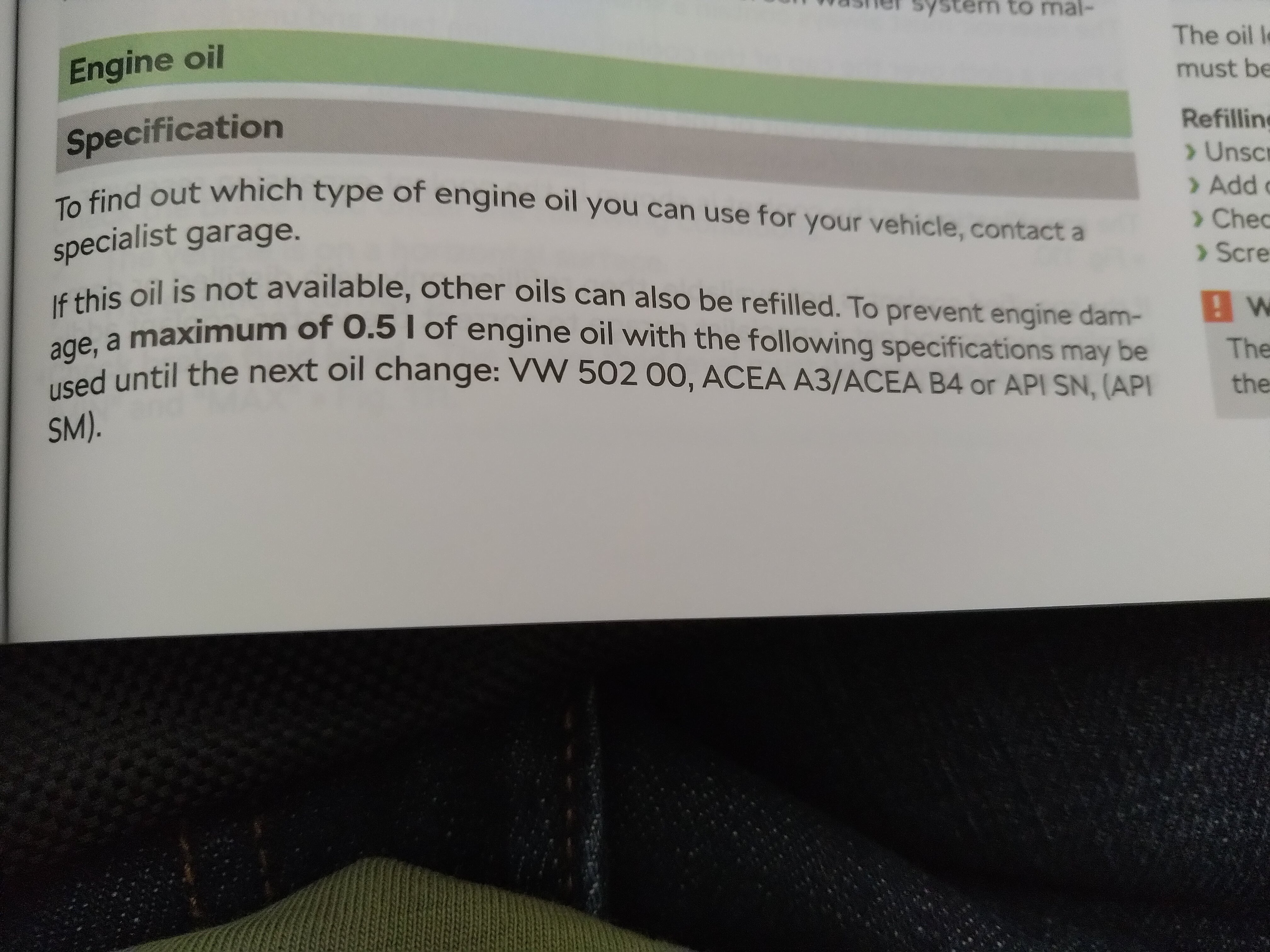

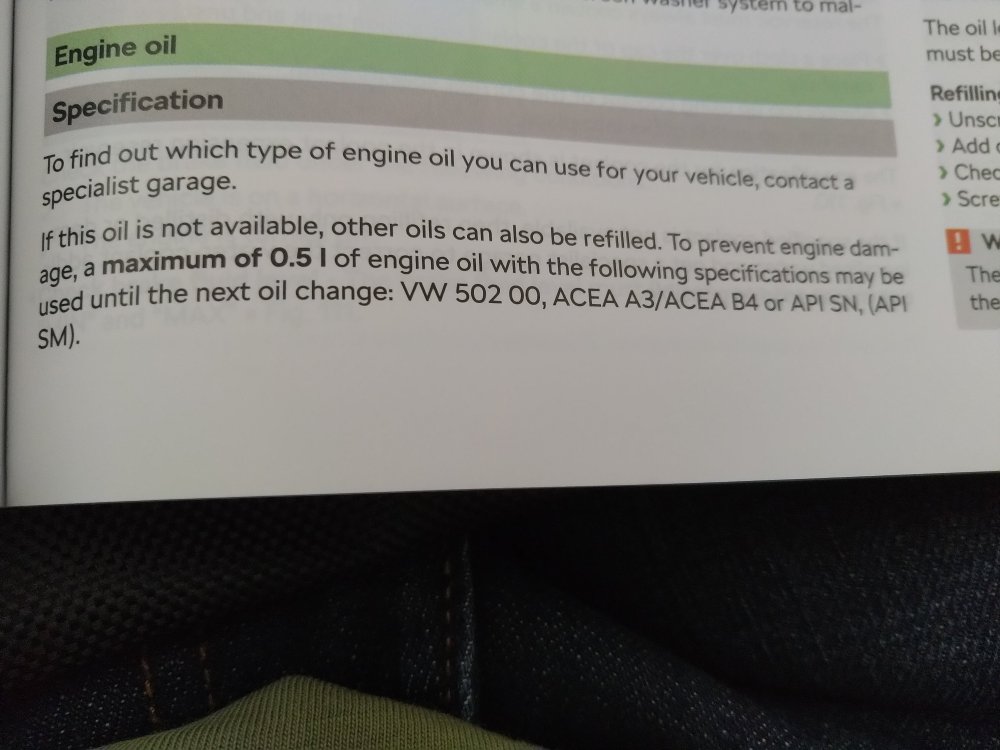

Have checked owners manual which states contact garage for correct oil ...
You might want to double check. Somewhere they should tell recommendations for oil specifications.
My Bad does state details below :-
Will get a top up kit ordered
topup kit
Thanks for your help  cheers Steve
Edited by steveeeg
