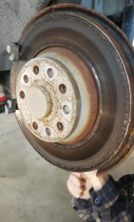

Anyone knows why this is the case with this model. I have a theory that ACC is using same circuit as the handbrake to control speed. Its a bad design since there are no warnings rear. On any other brand I've had I have used the front warning as an indicator to change brakes all around. However this is no longer the case. I mostly drive long-distance hence the ACC is actively in use.
What's the problem here in this picture you are trying to explain?
That looks terribly corroded. I have no behaviour like that. My rear pads are getting used as fast as front ones. Basically 16mm vs 20mm pad thickness is perfect choice to replace both pads at same time.
No the ACC does not use the handbrake. Unfortunately the rear discs are rubbish and rust/wear the pads quickly. When you get them replaced, avoid original discs and get after-market ones, they will be much better.

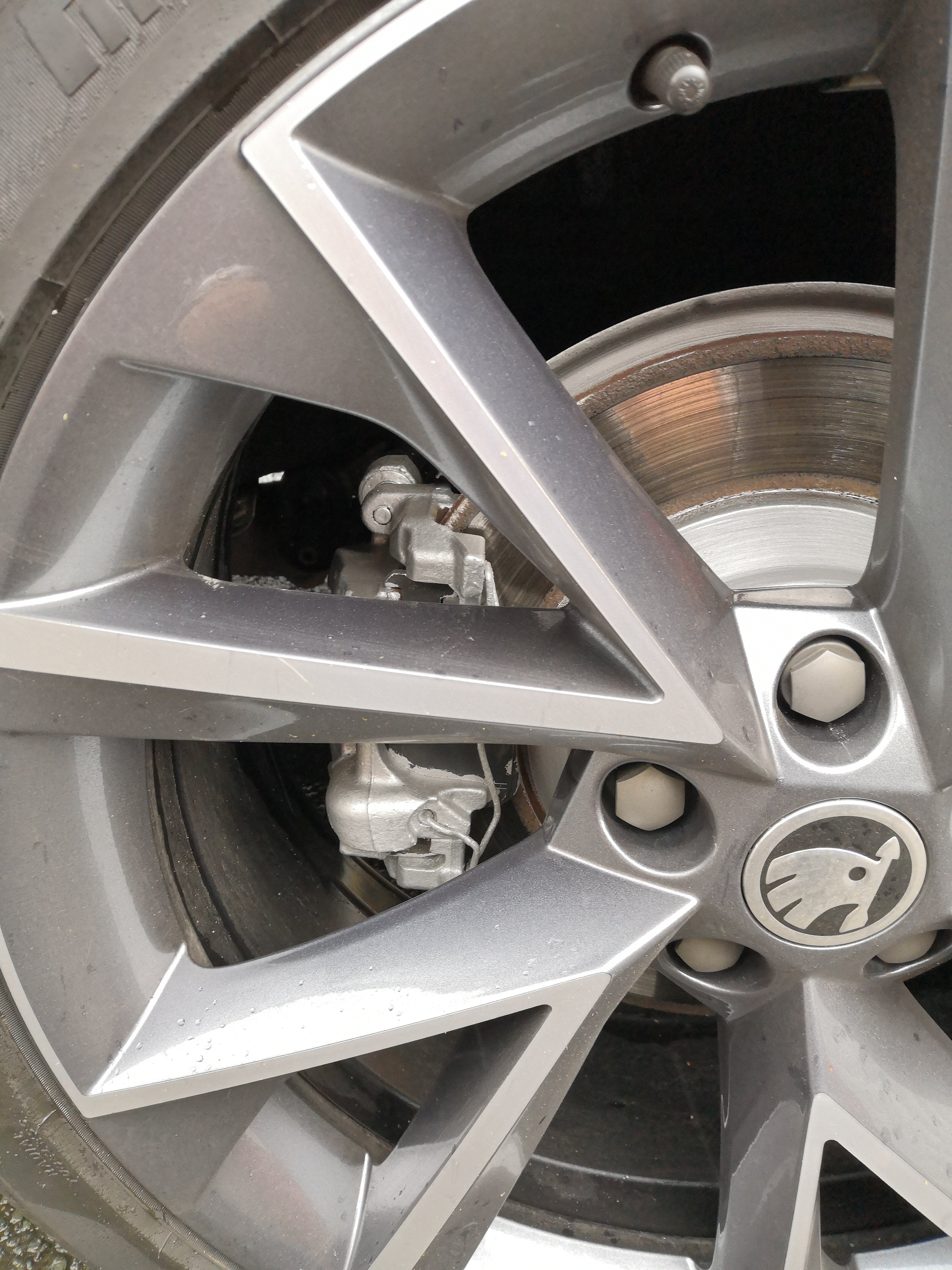

My 2016. Looking better after some paint. 14000 miles onky.

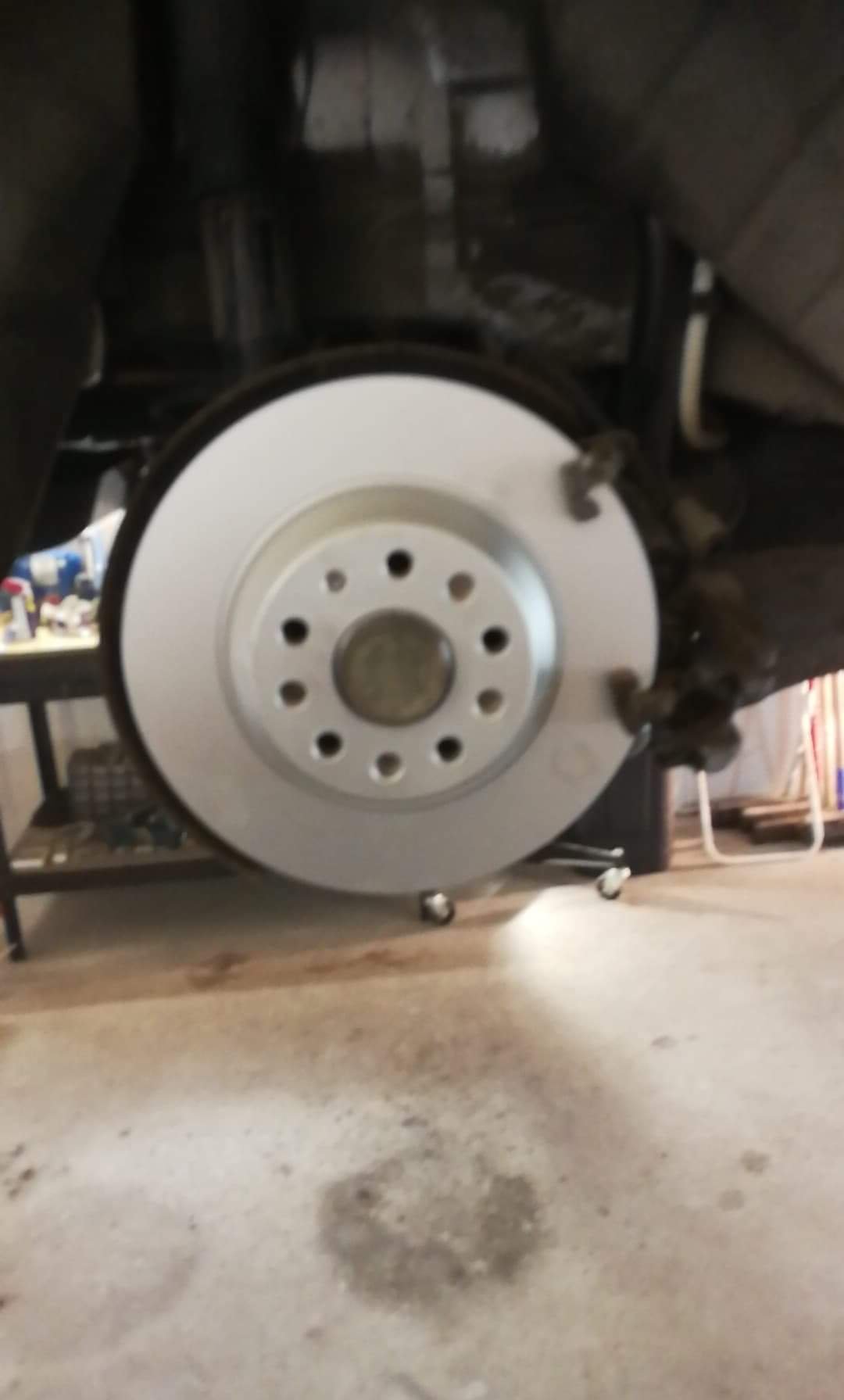

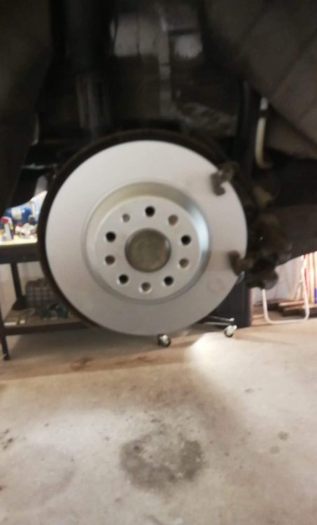

I have changed discs to coated discs to avoid some of the horrible looking rust. I'll post a picture of the front discs and pads so you can see the difference. Front discs and pads are good for another 10.000km, where as rear was totally gone.
New rear
2 hours ago, roarhag said:
New rear
Looks good when brand new. I wonder how long will they be rust free!
These look really good if they're old!!! Which brand did you get?

It isn't just the discs that have badly corroded, but the disc shield behind it too.
I've never seen a disc shield / guard as rusty as that before. There is something else at play here...

Premature corrosion of the brake discs can be due to a number of issues, but the corrosion to the brake guard is a sure sign of excessive external environmental conditions.
The rear discs on our late 2015, 30k miles Superb III are in a horrendous state - really badly corroded and pads are almost worn out, worst we've seen on any car we've owned.
And nowhere near the coast either...

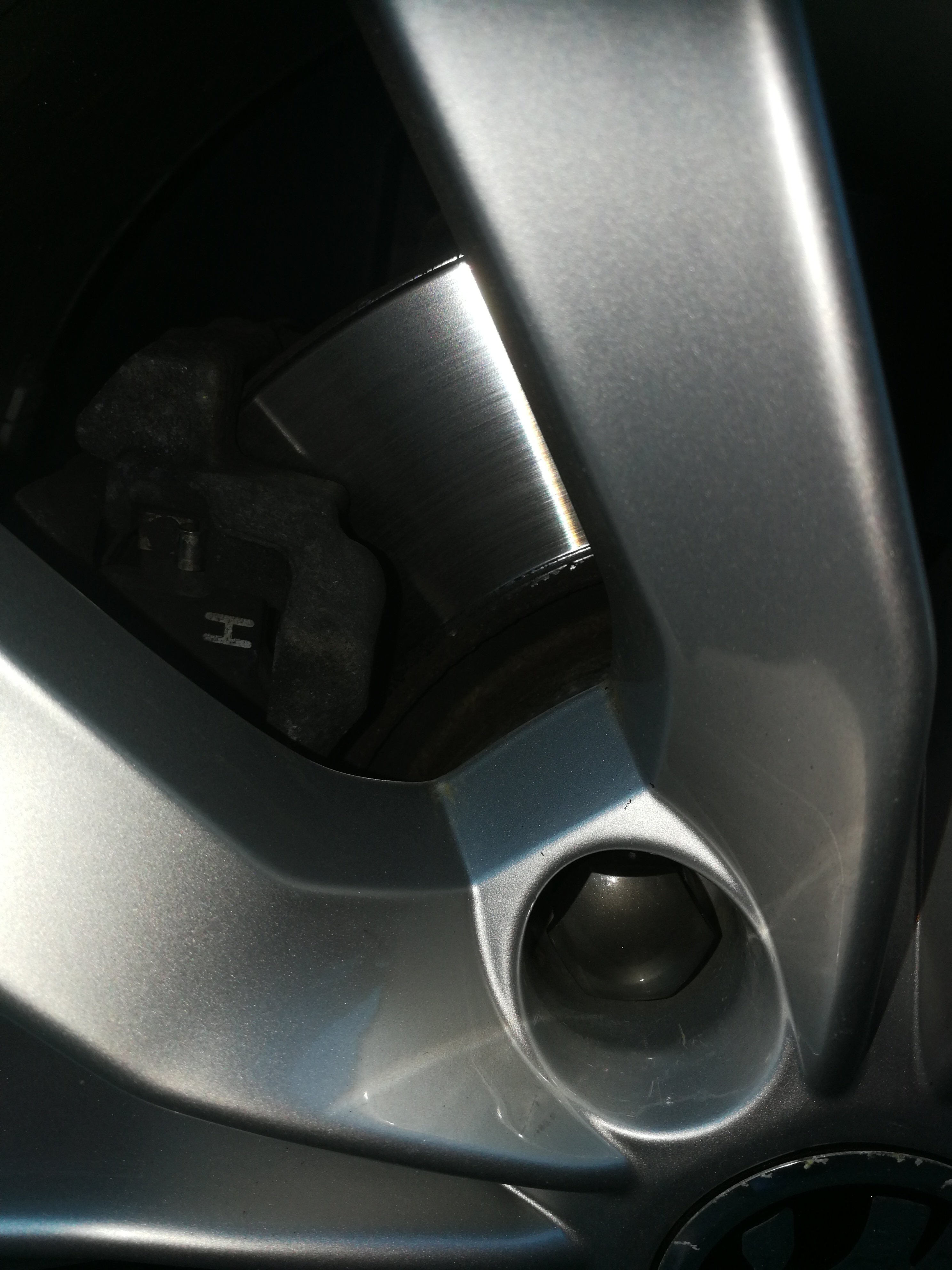

I'm getting my new disks soon so I will make some pictures of my disks. I truly don't know why some people have so much issues with rear. I don't. I did however activate XDS (which does brake rears softly) and I have ON function for water/rain thing.
