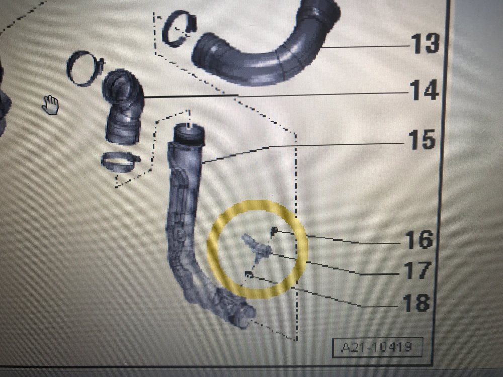

After looking at old topics I am still unsure where the boost sensor is located, I can locate the Turbo Boost  Pressure Solenoid but unable to locate the
Turbo Charger/Boost Sensor!
I have checked various diagrams but they point to various areas( No 6 on diagram!)  & a youtube video points to the Solenoid valve has the boost sensor!

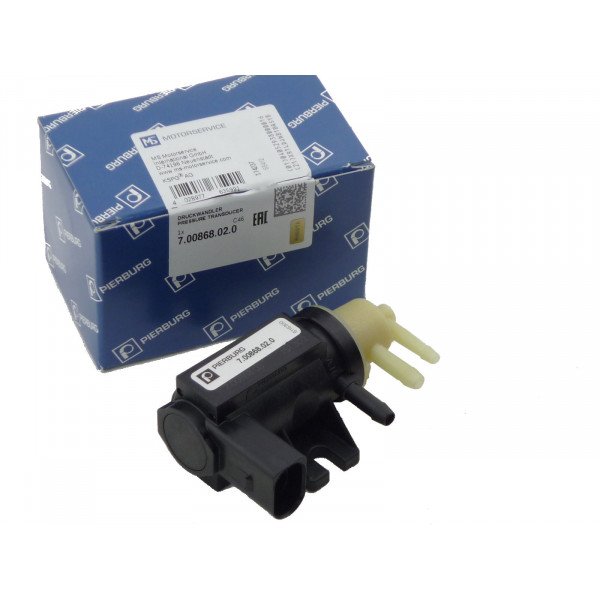

Pictures are a Boost Pressure sensor (top) and a Boost Pressure Solenoid (Bottom).
Any help would be grateful as if it's an easy fix I would rather DIY.

For my engine access is from underneath once engine undertray is removed.
Also look out for hidden broken wires under the pvc near the sensor plug, watch measured value blocks while moving the sensor loom to save wasting money on a sensor. The sensors do fail though. 9B1E573C-D860-48CB-8647-1BB06C7A79DE.thumb.jpeg.35ea478680b234c982e15798600bf91b.jpeg
As that code suggests signal too high, with ignition on engine off, see if the boost measured is close to the ambient pressure of the reading for the engine ecu, if it’s measuring boost way above what the sensor in the ecu measures, you know good chance G31 is knackered.
