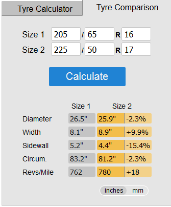

Sorry to be a bit thick but are "205/R65 16" tyres the same outer diameter as "225/50 R17" then?
3 minutes ago, PetrolDave said:
Cheers for that!
So just over 1/2" different but why not supply the same size spare as those fitted to the vehicle?
