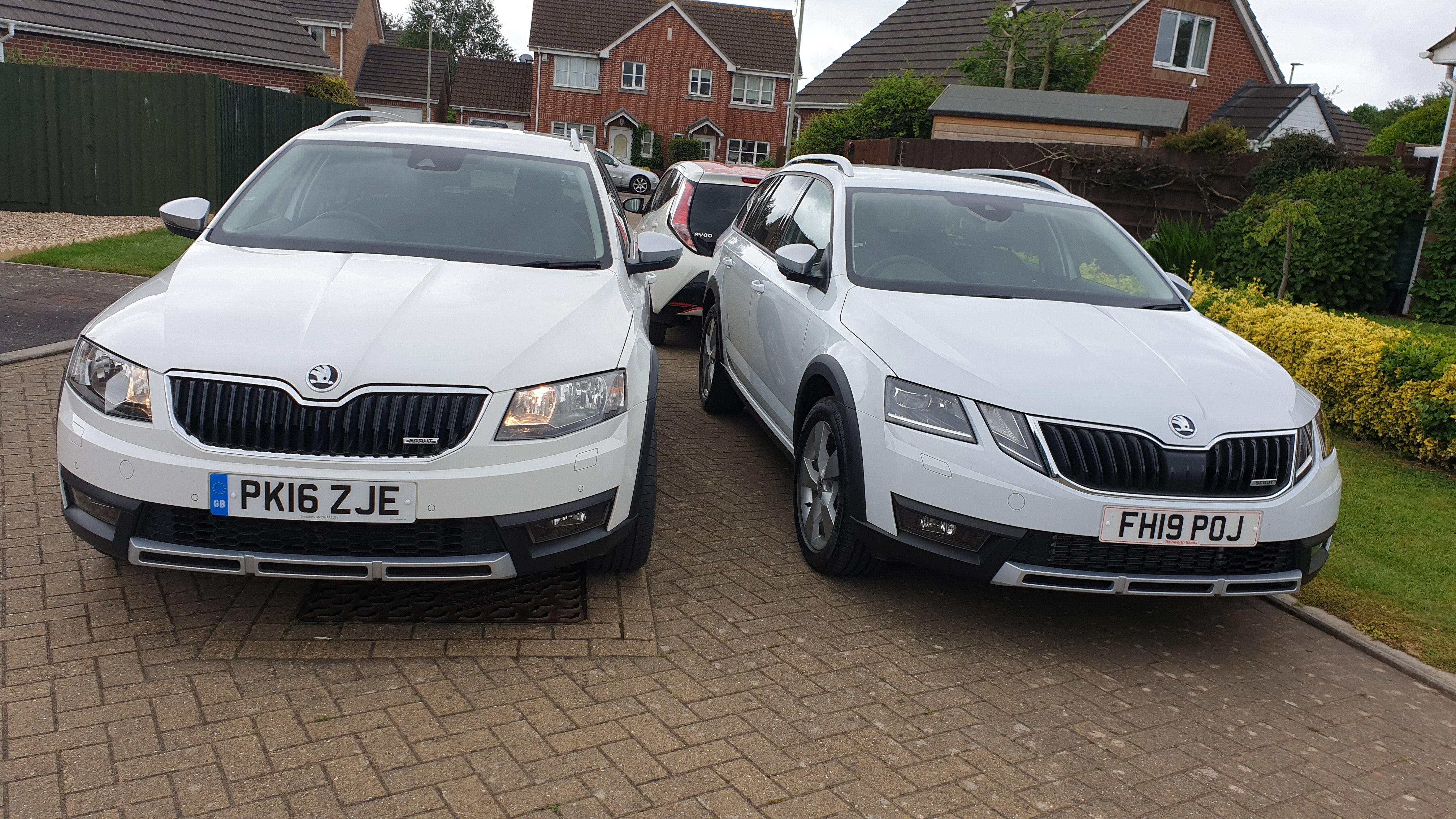

  6. Candy White left, Moon White right.
