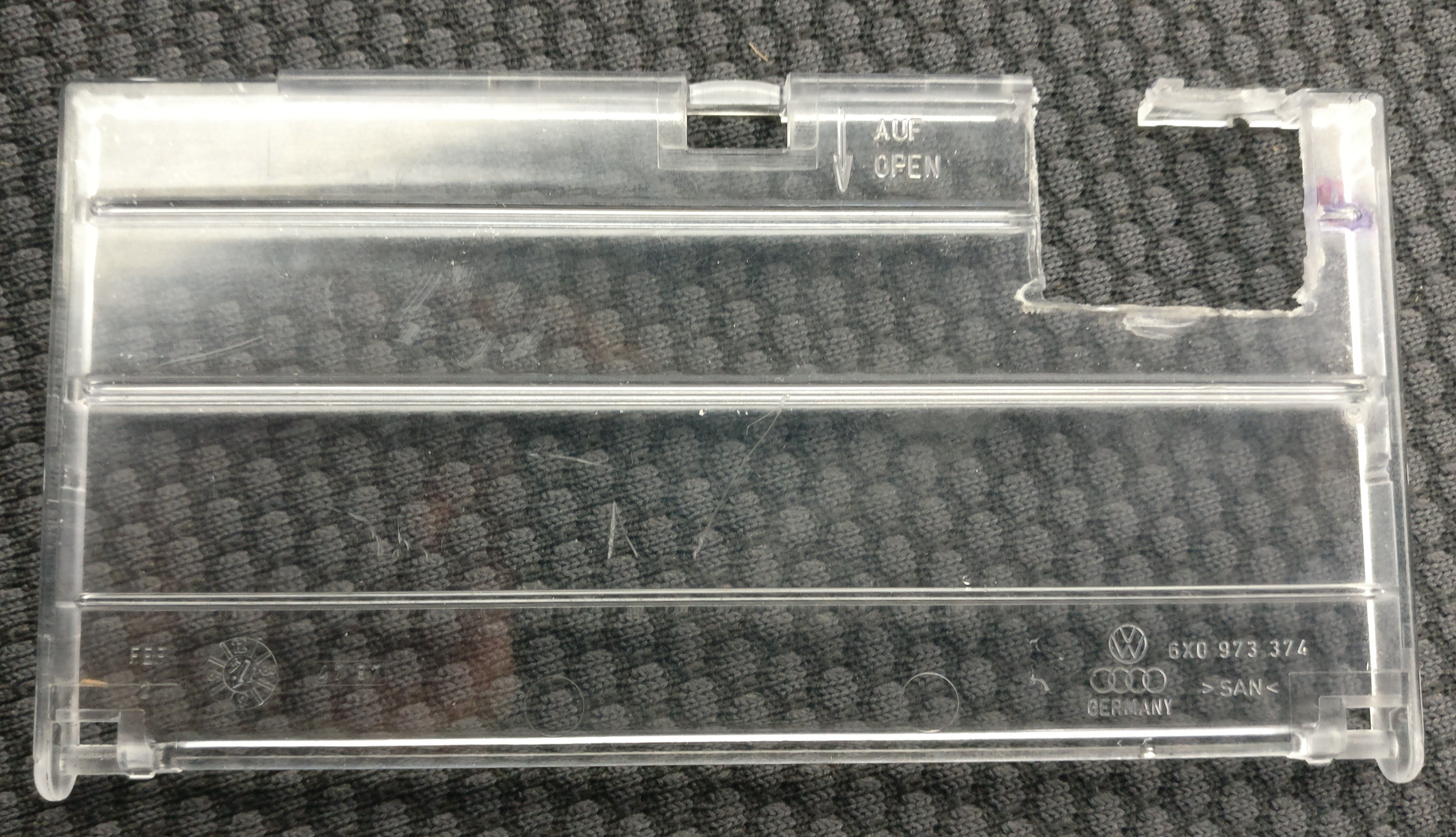

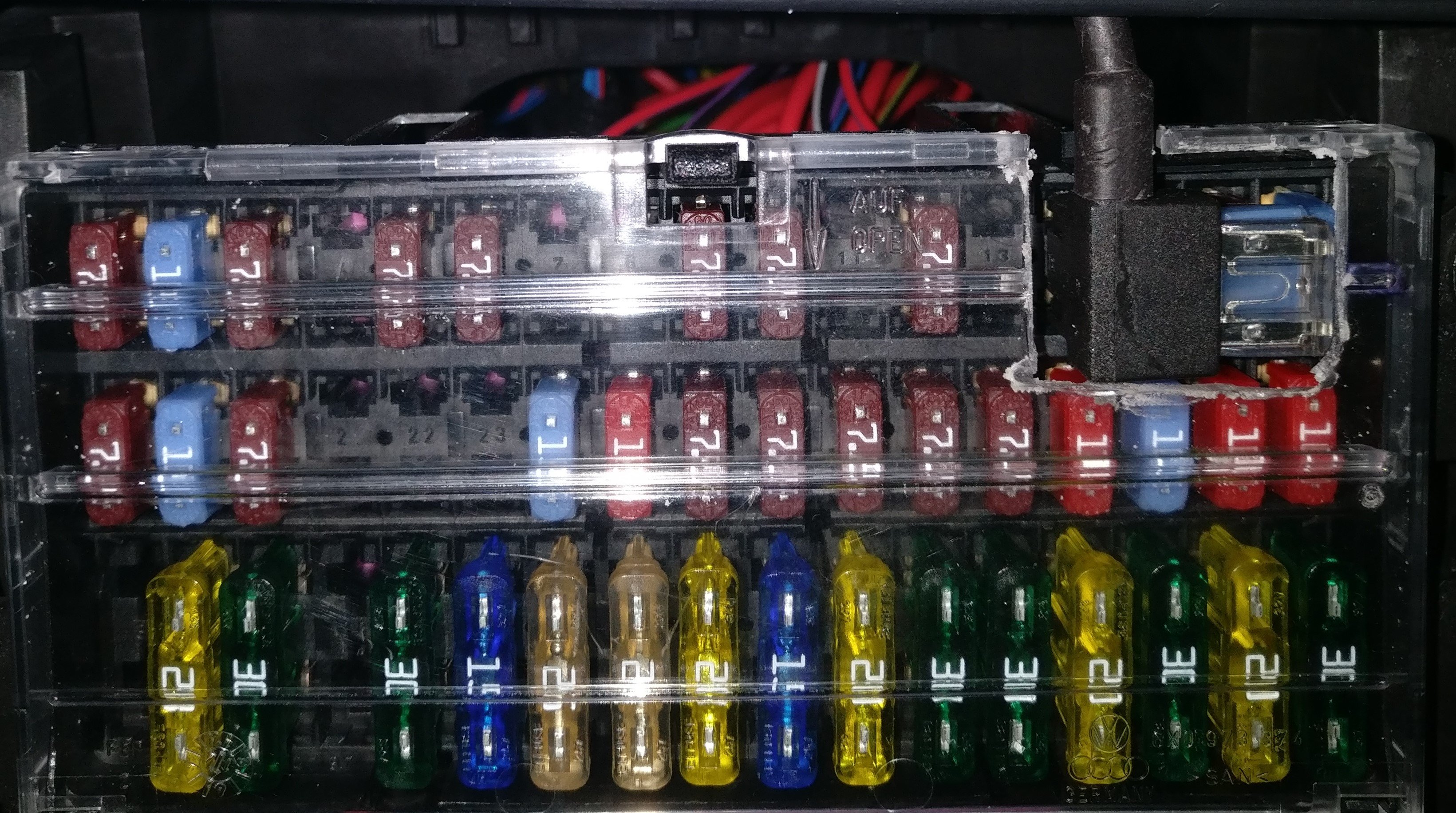

My fuse box has a hinged lid. There wasn't enough clearance to close the lid with a fuse tap in place. I cut a hole for the tap to poke through when closed. Will post a picture later if you like. Bear in mind that my car is 64 (late 2014) plate so may be different from current model

Just for clarification - I have only cut the plastic lid of the fusebox: see photos for detail and part number
Just to point out all those empty slots are powered by the relevant bus bar internal to the fuse box. You unscrew the fuse box and slide the purple bar to the side. Then insert a terminal and join that to whatever you are powering (obviously don't run 12v direct to a dash cam unless it is actually a 12v camera which is rare). Nice and neat, wont effect warranty and looks entirely factory.
