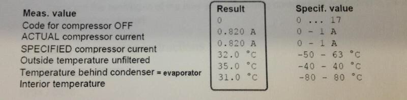

Hook up to self diagnostics and access the air conditioning control unit. Check live data and look at he following fields
If the code is 0, the compressor current specified and actual are comparable and so are the three temp sensors then the compressor is faulty.
