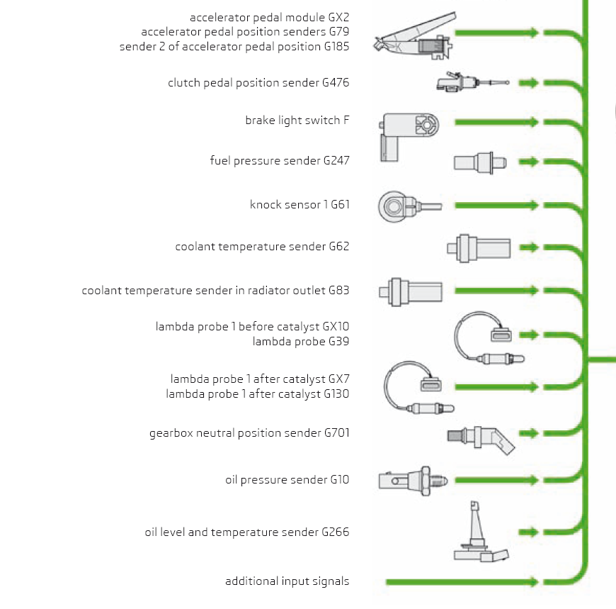

We have changed the gearbox neutral position sender G701 with new ,  located in the gearbox . But the problem persist
AUTO START STOP:ERROR
ODIS indicates the next sensor to be investigated  clutch pedal position sender G476
