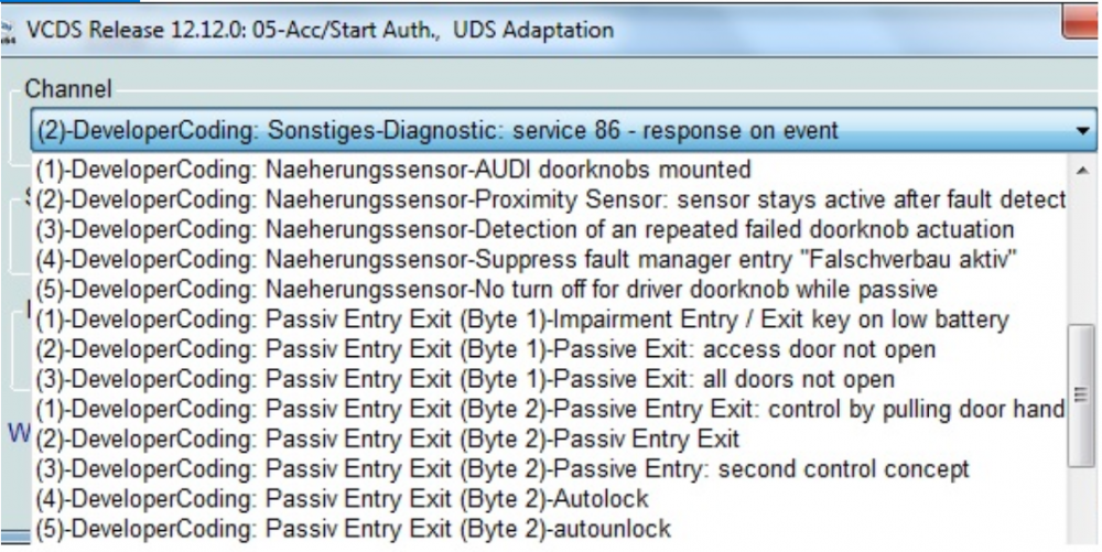

Hi,
I have a daceliftet superb 3t with kessy, and in the 05 assec module, i have byte 2 bit 4, exit door lock when slamming. I have enabled this byte, but it does not work. I read somewhere, that i also should enable an adaptation channel for passive entry exit door slam, but these are the channels i have. Which should i activate, and does anyone know the security code? The module is
Address 05: Acc/Start Auth. (J518)       Labels:| 5K0-959-434.clb
   Part No SW: 5K0 959 434 E    HW: 5K0 959 434
   Component: VWKESSYPQ35GP 092 1202
   Revision: 00092000    Serial number: 0334946443
   Coding: 030C0C

Security access code would generally be available to users of current versions of VCDS.
VCDS 12.12 is very out of date, have you considered updating to a genuine cable?
