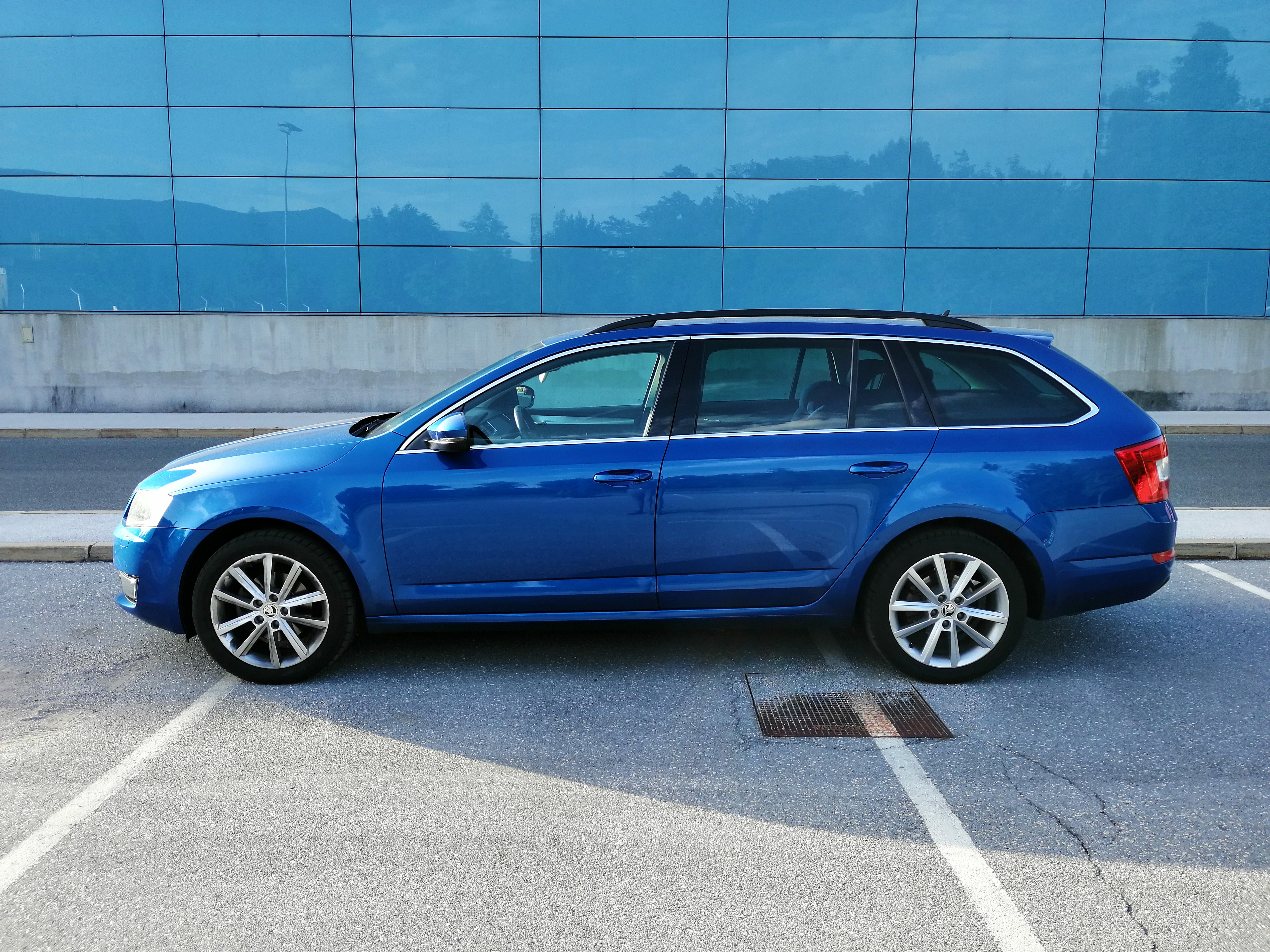

Today i ve installed B6 on my 4x4 2017 octavia.
So fsr done only approx 100 km, but love it.
I ll write some more in other thread on the feel.
So far i was suprised how the car is not harsh, but damps so much better.. Much more secure feeling.
Left original springs as i like the height for snow, curbs etc.
I need to check if tue height is the same. Should be as springs are responsiblecfor height, but i remember reading being slightly higher with b6.

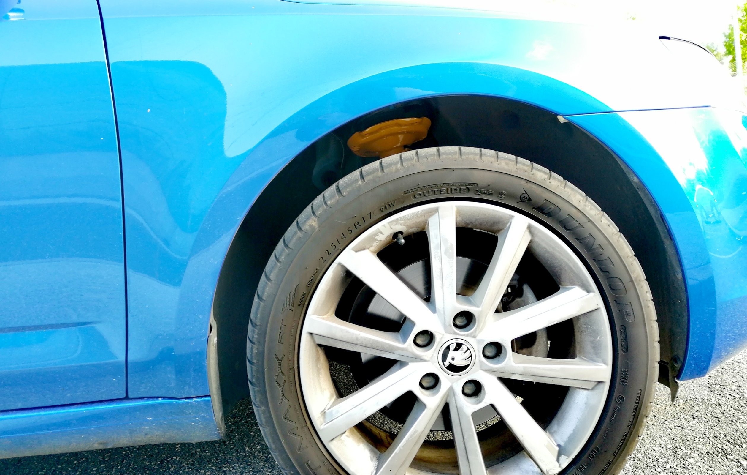

Is the 4x4 higher than standard anyway?  I know its not a scout but it could be a slight raise on standard octis.
Glad you like the ride.  I might be lowering mine in the new year so will see how the b6's feel on shorter springs.
I ve measured. I think the height is the same. Maybe 0.5 cm higher. I need to check once more better.
Ilas for the height of 4x4 comparing to "nornal" version. Actually i ve checked the catalogue.. It says (FL Oct III) that normal version is 141 mm and 4x4 version is 138 mm?! So its actually lower. Probably due to some elements in the suspension.
Previous versions of octavias 4x4 were i think at least 1.5 cm higher.
