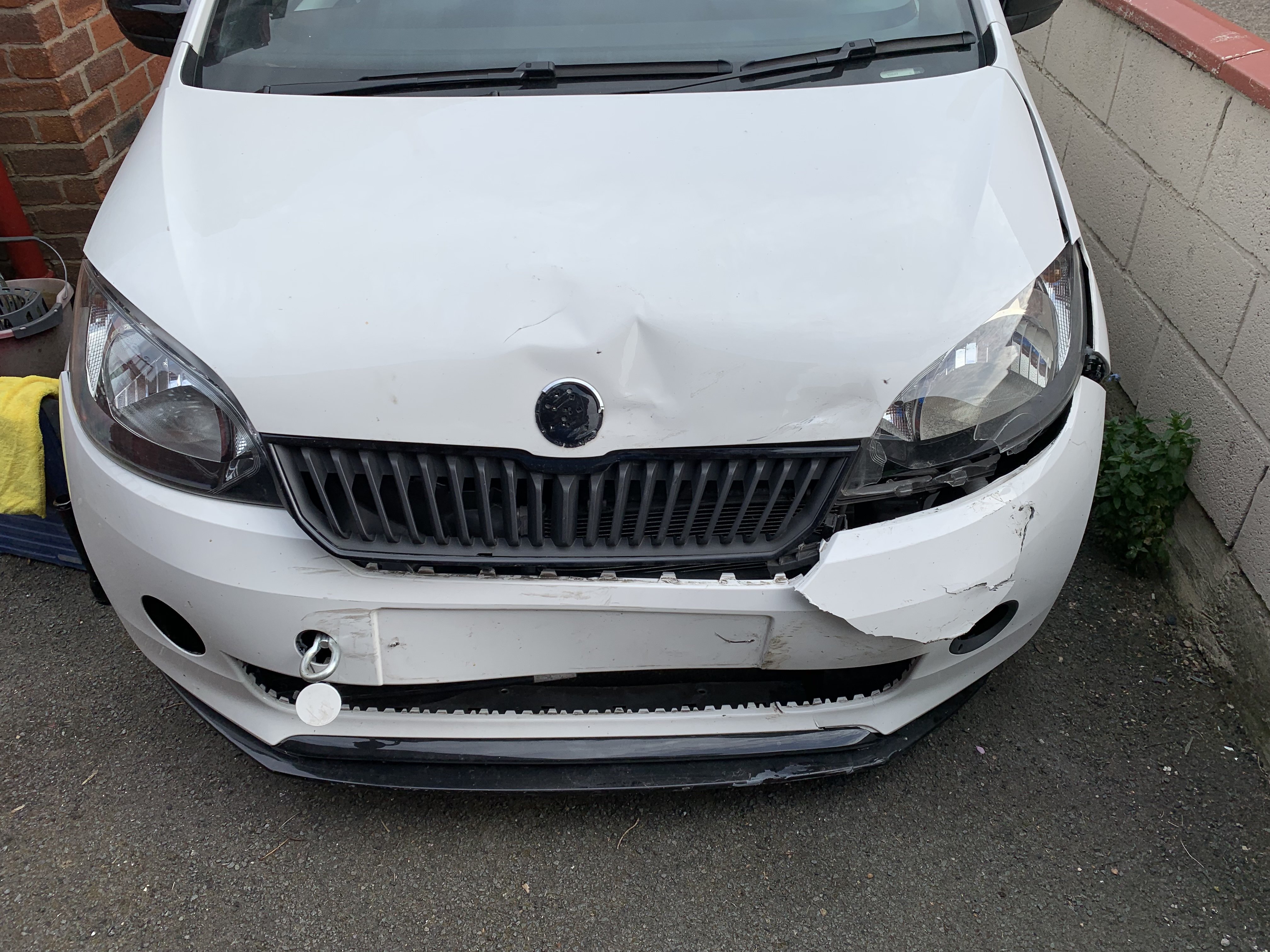

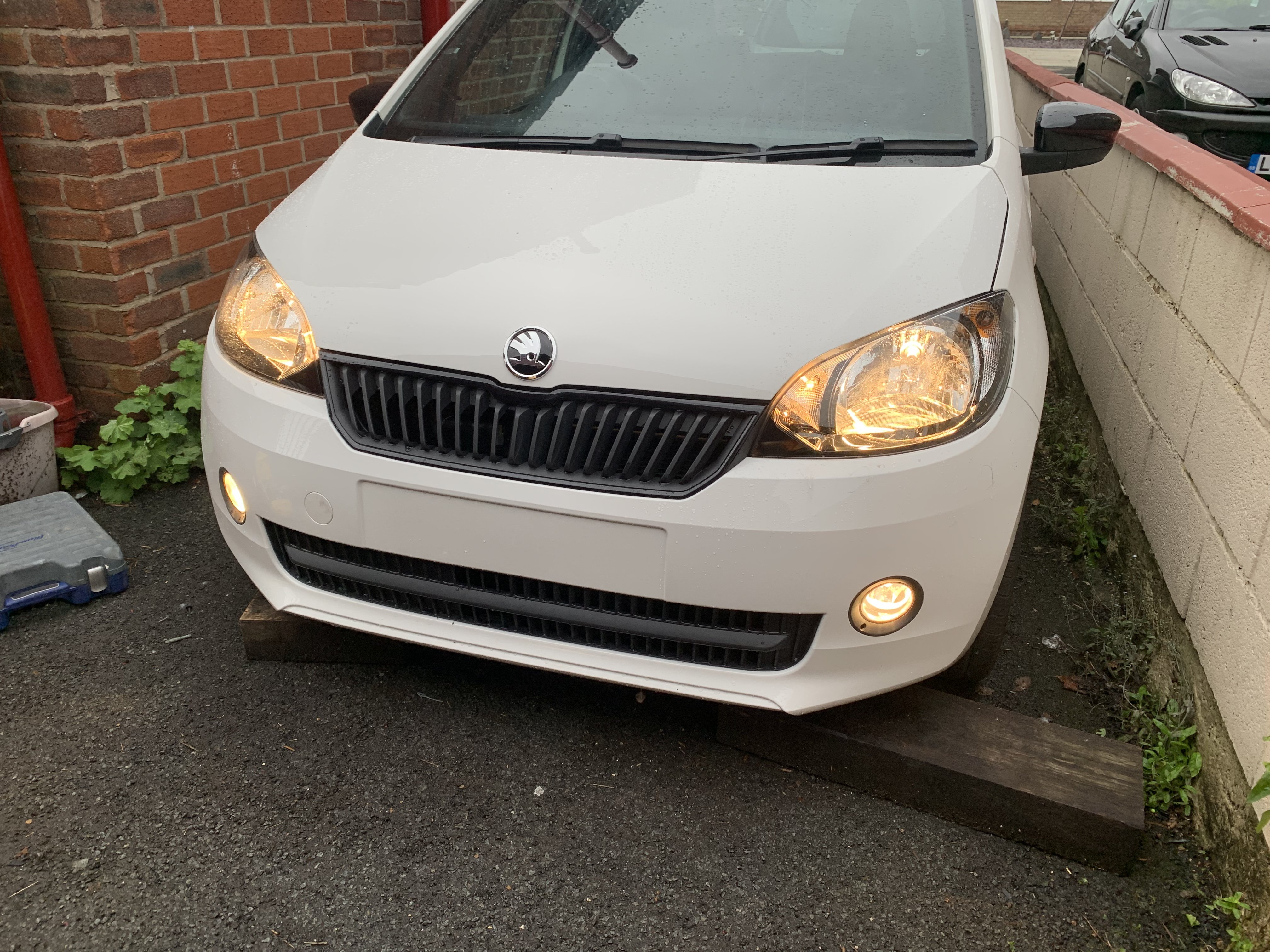

I’ve been finishing a Citigo Monte Carlo that had had a light front end collision. Airbags, front end carrier, rads, bumper bonnet all replaced an all codes cleared apart from the steering.

Before and after pictures attached
