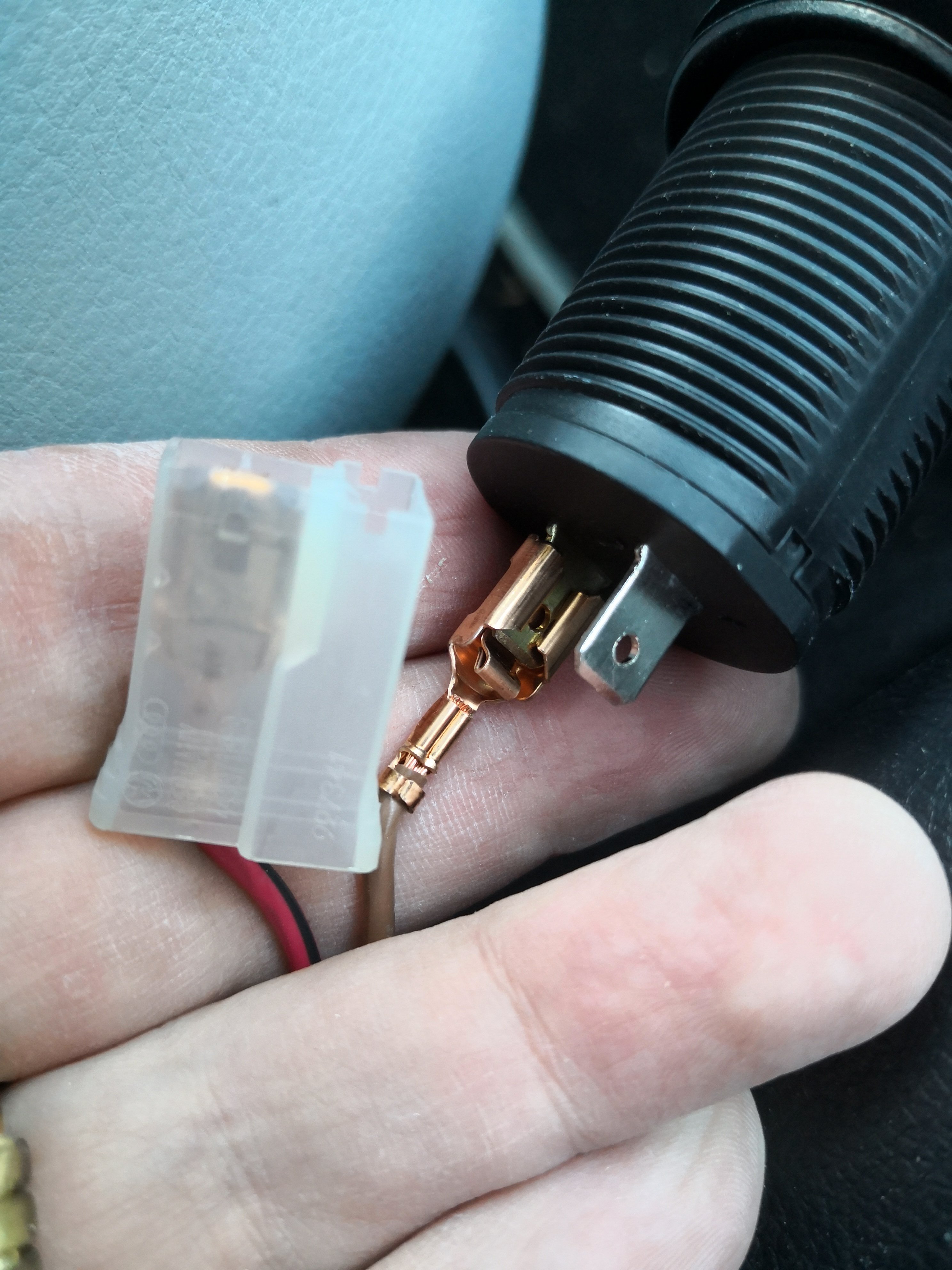

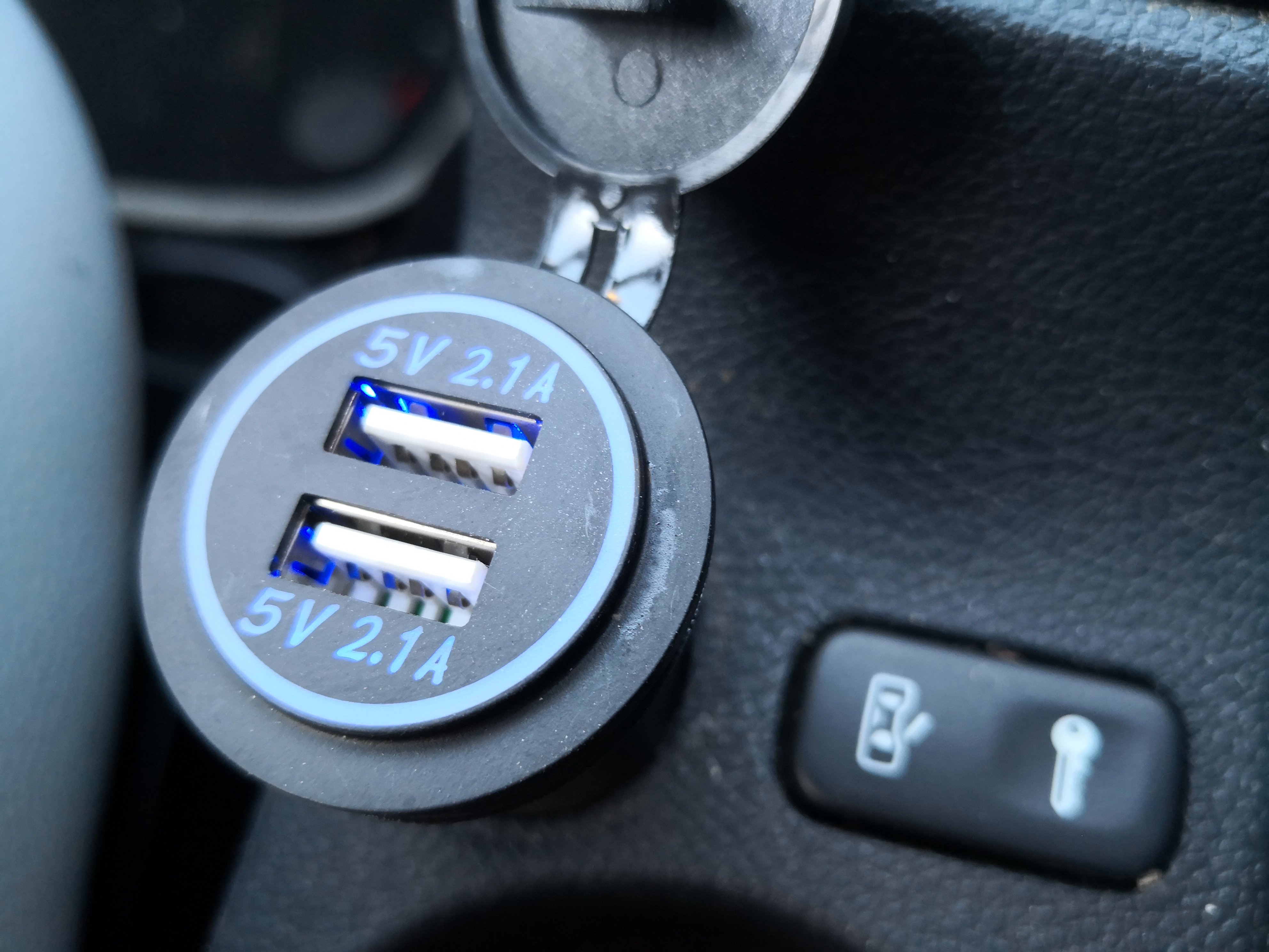

I've replaced the cigarette lighter power with a double usb port. Just pulled out the lighter and removed the earth connector from the plastic holder so that live is still insulated.
Before I widen the hole to push the new one down, do you think I should install a switch? Or will the current to power the light on the usb socket by so minimal that it does not matter?

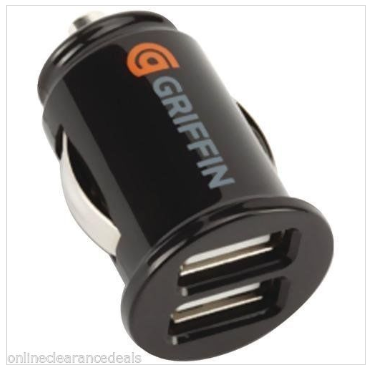

Well, actually, I'd use a small removable adaptor and not bother removing the 12v socket... That way it can be removed when not needed and also used to power other things car tyre inflators 😉

The current is 11.3mA (0.011A) when it's powered but not charging anything.
I'm thinking of installing a little switch still.
Mark
I'm not sure I see the point. Once you start cutting the centre console there is no going back. All to get the USB ports flush?
As suggested above I'd just use one of these...
They are almost flush and can be removed and reinserted at any time.
That's a good solution, I'm going down this route though as we only ever use usb and it saves the fiddle of an adaptor.
As you have found the current consumed is primarily the quiesecent current of the power supply to the USB sockets.
