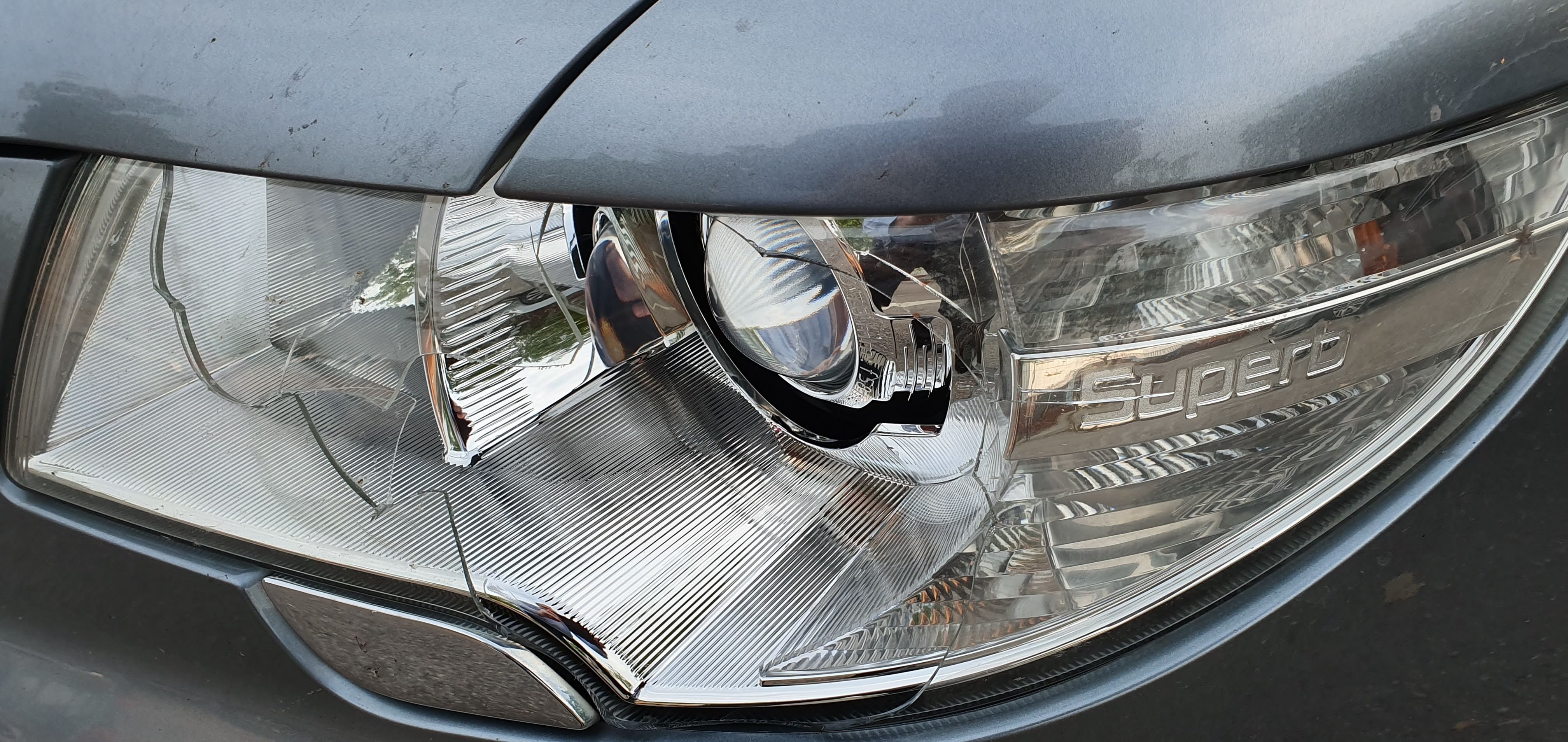

So driving along in the early hours for my 12 hour shift and a bird failed to fly away despite the use of the brake 😞
So as you can see headlight glass smashed and now the need for a new one.
I assume, going by the many searches that this will require to drop the front bumper to remove the headlight? Further more is just a shell that I buy and transfer the rest over or does the headlights remain in place as I have those "moving" lamps?

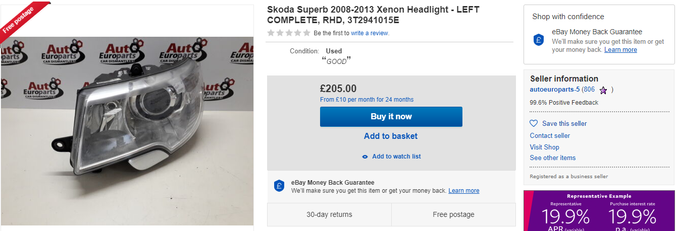

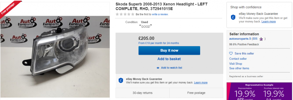

Your headlights are the bi-xenon's, an upgrade on the regular halogens, but more complex (and expensive) as a result.
Assuming it is just the lens that has smashed, then hopefully you can get away with a new headlight, and swap the expensive components over from the old light to the new one, bulb, ballast, ignitor etc.
https://www.ebay.co.uk/itm/Skoda-Superb-2008-2013-Xenon-Headlight-LEFT-COMPLETE-RHD-3T2941015E/202711779289?epid=1731129737&hash=item2f329047d9:g:G6kAAOSwoy9dB6WB

Indeed just the plastic lens so hoping just the case and as you say transfer over the gubbins to the new case.
Cheers for the eBay listing again tried to have a look but 12 hours today and back in again in the morning meant not much came up.
Shall Beaver away tomorrow and get this resolved.
Be aware some aftermarket units don’t have the Superb inscription. Someone posted recently that their adaptive lights no longer working.
This link looks like a genuine part so you will be ok, bonus it comes with the driver and adaptive ecu so just the bulbs and xenon envelope to swap.
