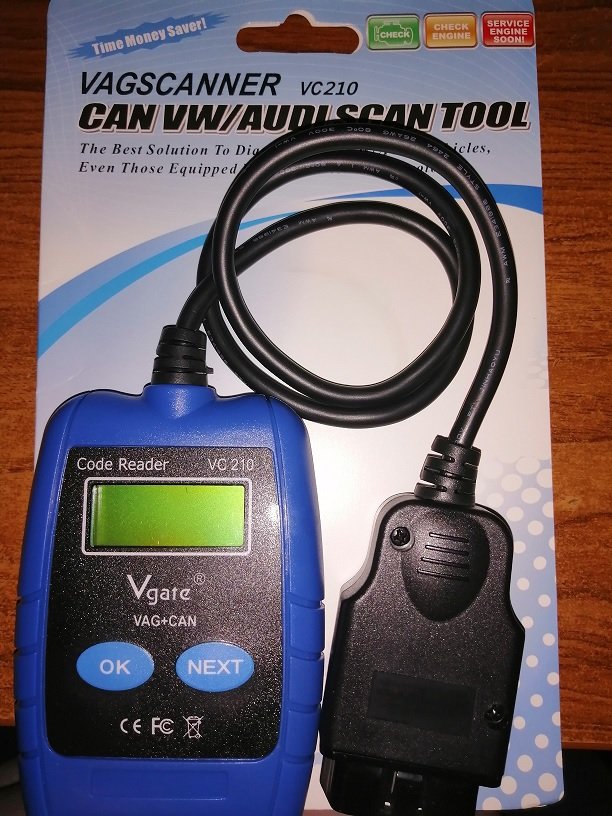

Apparently according to Carista, it will read airbag fault codes and reset them but only if there is no real fault present. So in other words, if the error condition has been caused by the disconnection of a part in order to gain access to something else, and that no real damage was subsequently done to the part or the connections to it, so when you reconnect the circuit again, it is as before no faults, then the Carista will reset the error. if the item that I have found and is currently on route to me from Amazon USA  https://uk.dhgate.com/product/vgate-vag-can-vc210-obd2-car-diagnostic-scanner/453570384.html#s1-1-1;uk|747458592  does not do the job, but I'm hopeful it will as it claims it will in the advertising and packaging, please note that I got it free delivery to the door for £12.20 and it was the very last one Amazon had it stock, then I shall be getting the Carista.

The scan tool I had ordered https://uk.dhgate.com/product/vgate-vag-can-vc210-obd2-car-diagnostic-scanner/453570384.html#s1-1-1;uk Arrived over the weekend and it did indeed clear my airbag error code and reset the warning light but I did notice that the error code it gave me did not match any listed in the provided manual, none the less I cleared the error message detected and the car was OK again so I guess maybe there are different code numbers for say European cars to those for North America, because the buttons are marked as OK and NEXT but the manual refers to them as ENTER and SCROLL? One thing I did notice that might be a clue is that the engine menu selection displays "Linking Error" and the manual states the following.
"If the "LINKING ERROR!" message does not go away then there may be problems for the code reader to communicate with the vehicle. Contact your local distributor or the manufacturer's customer service department for assistance.
No then question is, do you contact them (the sellers of this item) or the car?
