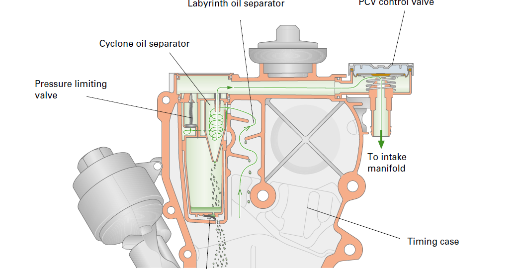

I think your oil separator is not draining the separated oil out of itself, so effectively doing nothing. I seem to remember there's a little flap valve at the bottom that should open under gravity if there's liquid oil on top of it. Maybe that's gummed up and stuck closed?
Item 9 here: https://skoda.7zap.com/en/cz/fabia/fab/2004-225/1/103-103004/
Image of separator internals:
  • Sponsor
The breather hose shown above as "to inlet manifold" goes to a fitting on the right side of the inlet manifold, and from there through an internal pipe to an outlet somewhere just under the throttle body. I doubt that's blocked but you could easily check by disconnecting it from the PCV valve and blowing down it.
I agree, looking at the state of the oil separator photo you posted, it looks as if the oil has been neglected and run for far too long and been cooked and coked up the separator which as wino points out has a drain back valve.
