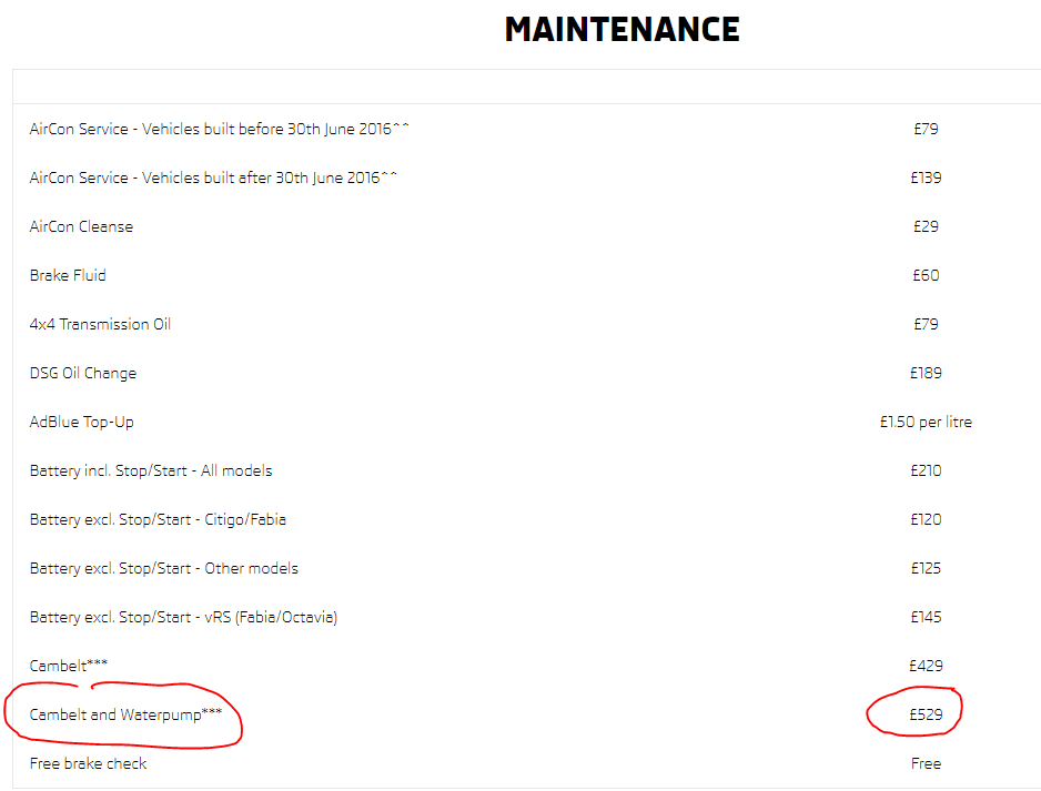

yup think ill get water pump done at same time! car costing quite a bit this month with garage visits! maybe persuade skoda to code the amundsen unit i got at same time! my skoda dealer is £539 water pump and cambelt
Ask them what the extra £10 is for, the Christmas party?
https://www.skoda.co.uk/owners/servicing-maintenance-fixed-price
In all seriousness though, now you're well out of manufacturers warranty you should shop around.
I got a cambelt and waterpump, using genuine Skoda parts fitted at a local trusted independent garage for a good chunk less cash (£340, albeit a couple of years ago)...
