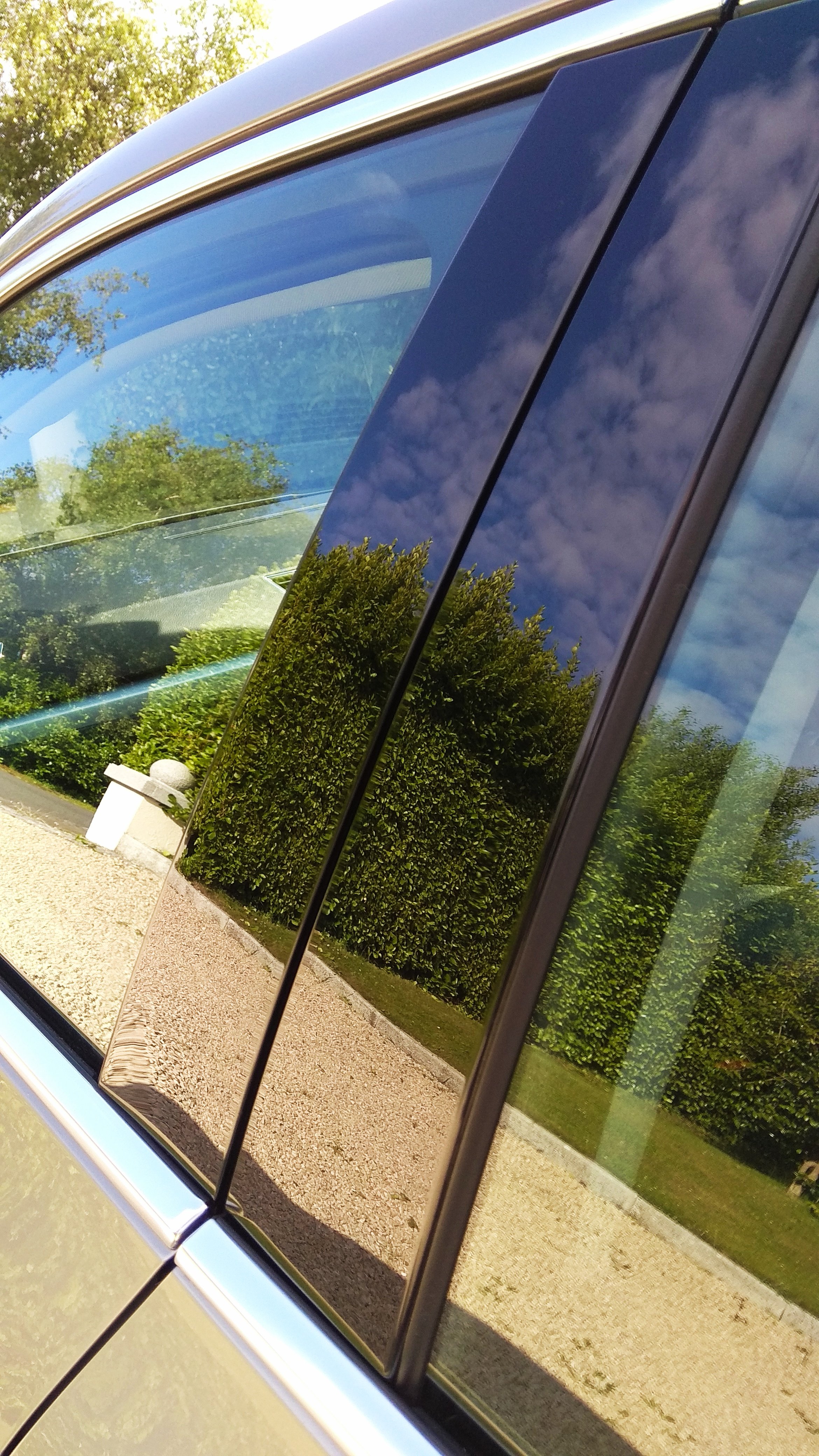

I primed the pad, spread the polish at speed 1, then made about 8 light passes with very light pressure at speed 4. I didn't use an IPA afterward so the oils could be complimenting the results. I will next time. For the second B pillar I swapped to Maguire's Ultimate Compound as it is more aggresive, but the results were much the same as the Manzerna.
Polished off with a Edgeless 365 microfibre which are unbelievably soft compared to cheap micro fibres.

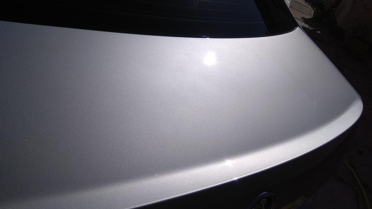

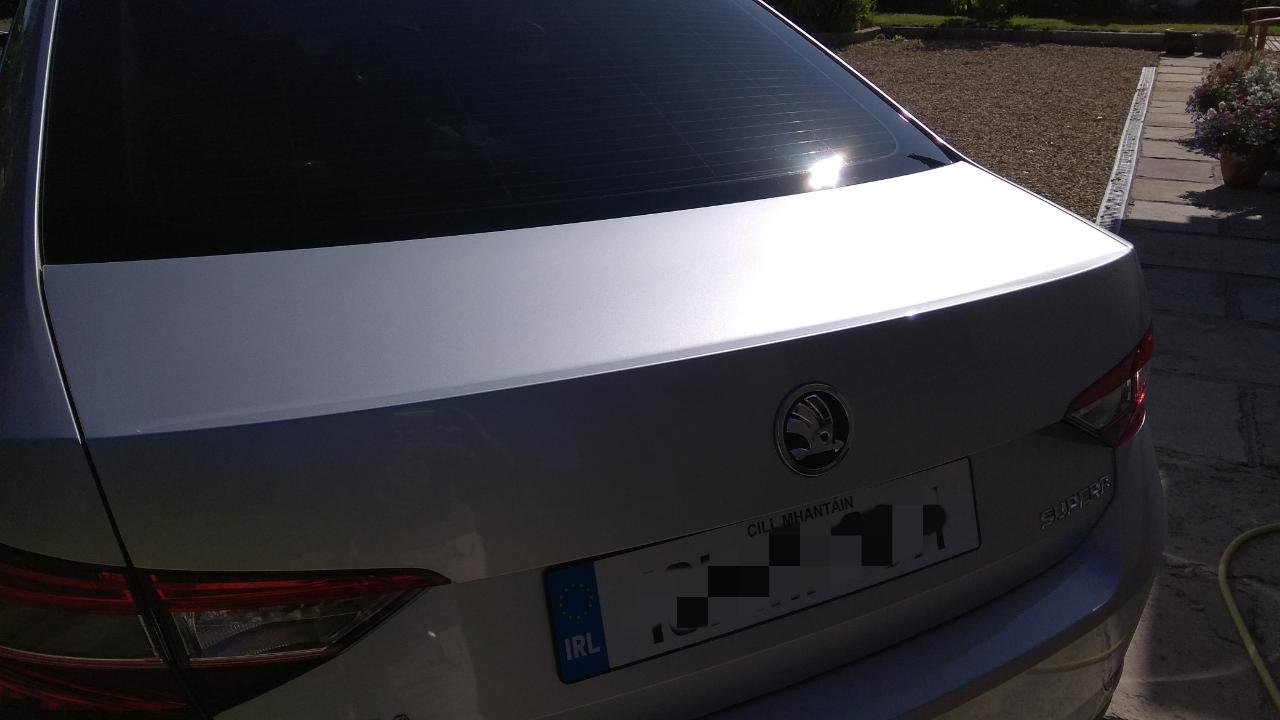

Couldn't resist tackling the wife's car today. While sunny the panels were not very hot, so went for it.
No tar on the car so washed, clayed and dried ready for machine polish.
Did half the boot first with S20 and a black waffle pad. Good results but not aggresive enough, removed about 60% of the swirls. Tip here is to open the boot, raise it an inche or so (wedge something in the opening). This way you won't burn the edges of the rear wings.
Next broke out the orange pad which was better. About 4-6 passes, a couple of inches a second. While much better, some minor swirls remain so may try the purple pad next, which is more aggresive than the orange. Pad was also clogging up toward the end so quick blast with a brush cleared it out.

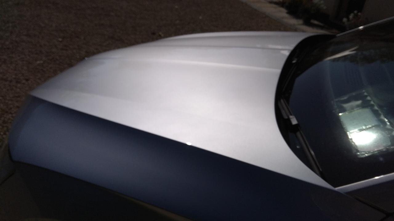

Then did the bonnet. Wiped down with IPA and waxed.
Good progress and learning lots already. Despite being warm and sunny the S20 stayed very nicely lubed and never dried up, dust was very low too.
Next up is roof, then onto the sides.

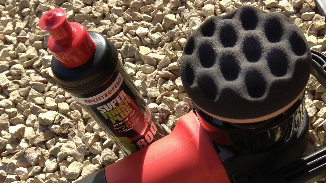

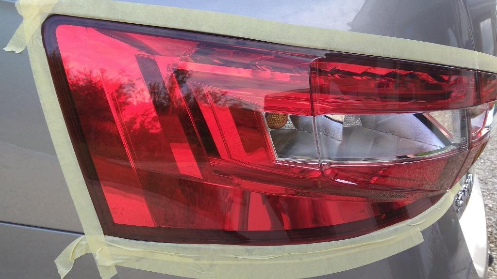

The machine polisher arrived today, along with an assortment of pads, polishes and microfibres.

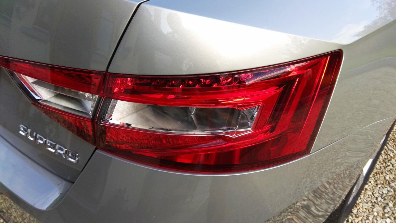

First up was the swirly piano black trim on the B pillars and taillights. Masked off and went at them with a 3" pad, Scholl black finishing pad, and Menzerna 3800. This was not an aggressive combination at all, so was interested to see if it would remove the swirls. It went really well, very pleased, removed about 80%, I'd say a slightly more aggressive pad/compound would have delivered perfect results.
This was very much a learning session, all the YouTube videos were great, and no surprises apart from how vibey the Das6 is, will take some getting used to.
Next up will be wife's car,  from head to toe with S20 black. Will keep this thread updated.

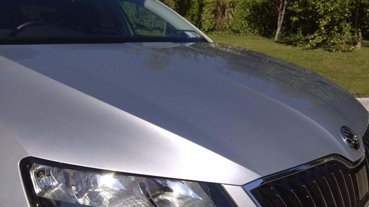

More today, roof and full near side. Machine polish, IPA and wax. Bloody hard work this!

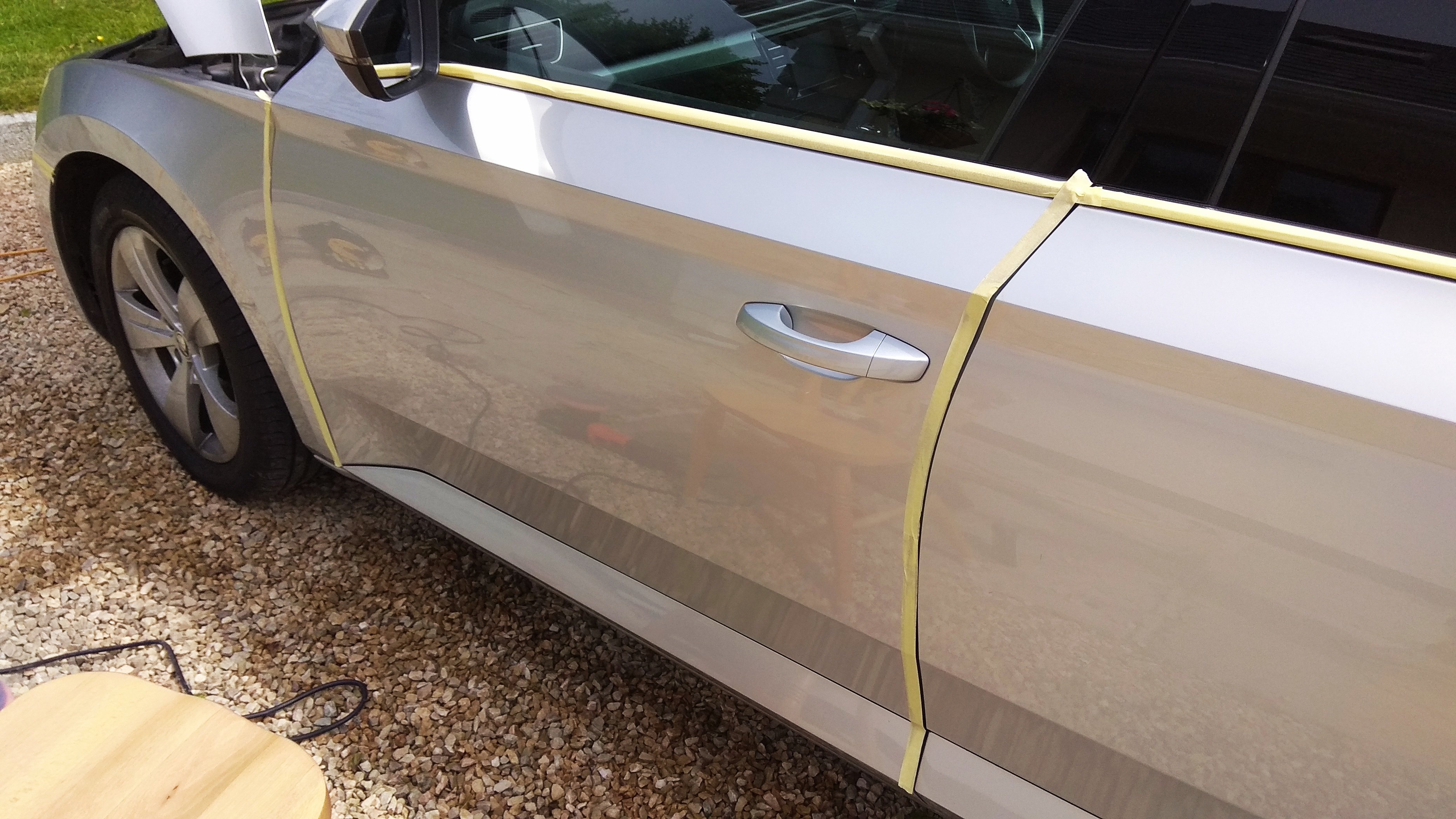

Today's lessons learnt:
Wrap masking tape around door jams so no risk of dragging glue onto the panel.  On that I have proper low tack tape on the way, the stuff I'm using is rubbish.

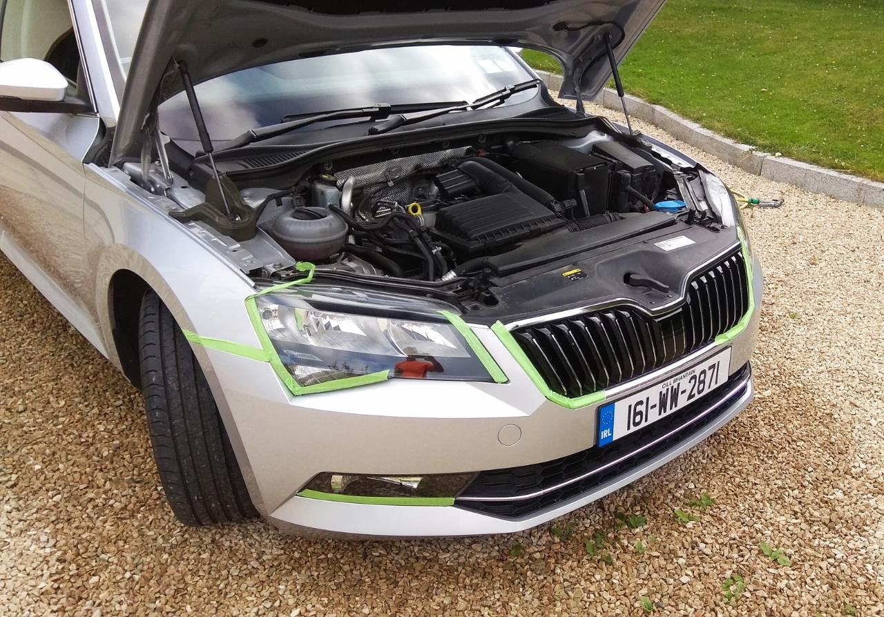

Finally finished this morning, N/S, front and rear bumpers. My green tape arrived so I now feel very professional! Removed loads of light scratches 90% of the swirls and generally the car looks as good as it has ever looked.
Absolutely delighted with the DA and the results, far better than any handwork would have done.  I would strongly recommend that if you like your car looking like new, you should invest in one.

Don't really understand why you went to the bother of masking off. Cant see anything that would have come to any harm if you'd touched it with your polishing pad. Perhaps I'm missing something.
Edited by mandp
^ Mostly to avoid polish going into the crevices, but also used on door edges to avoid burning the paint on adjacent panels (which are not always flush). It may have been overkill for the relatively light pad/compound combination I was using, but it provided a certain safety net which I was grateful for first time out.

Can I ask why the bonnet is up in a few of the photos? You'll just end up with more polishing dust under there :)
Cheers.
Scholl S20 is very low dust so no worries there.  The bonnet and boot were raised when doing the wings/rear 3/4 so I didn't have to worry about taping or burning those edges.
