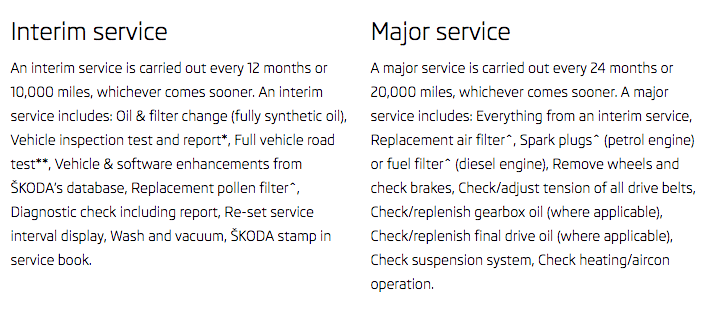

53 minutes ago, Woodside99 said:
I believe this link is for cars 3 yrs and older !!  Nothing for cars under warranty first 3 years.
I believe it isn't :smile: . The servicing regimes and work carried out/parts replaced is correct in that link (based on reading that and comparing it with what my local dealer has told me)
Ask another dealer for the maintenance schedule of the car.
IIRC (give or take a few K miles):
* DSG oil change every 40K miles
* Haldex oil is every 3 years (though it depends who you ask!!!!) - there's no 'official' filter change anymore but regardless of what a Skoda dealer tells you, find a local and reputable independent specialist who is familiar with the work required and ask them to remove/clean/inspect the filter.  Volvo owners were routinely told the filter is maintenance free only to find themselves with expensive Haldex failures on higher mileage cars.
* Brake fluid change every 40K miles

That's the prices.  I'm pertaining to the actual schedule/work carried out:
