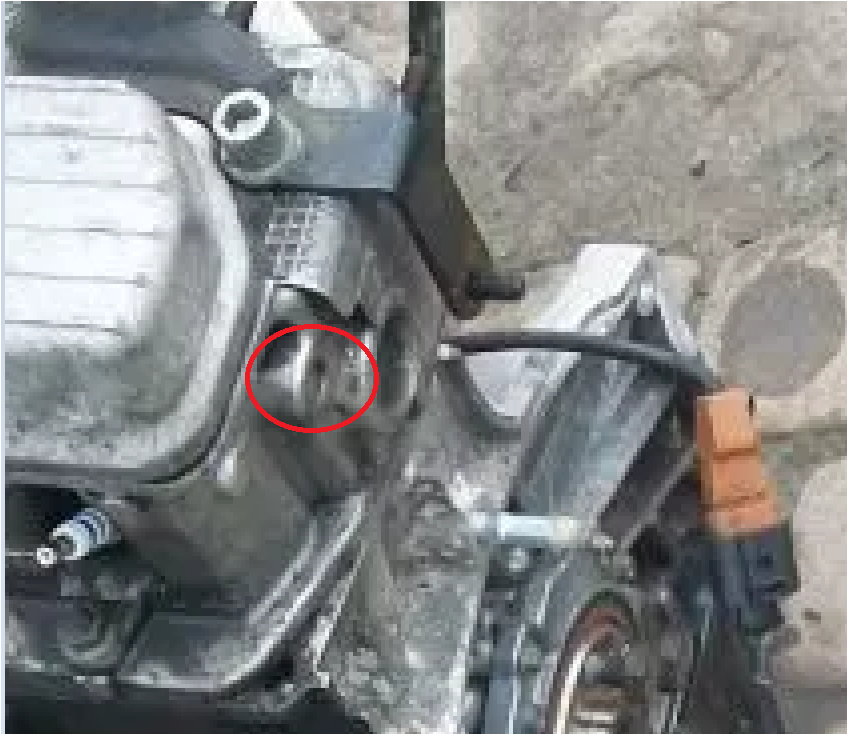

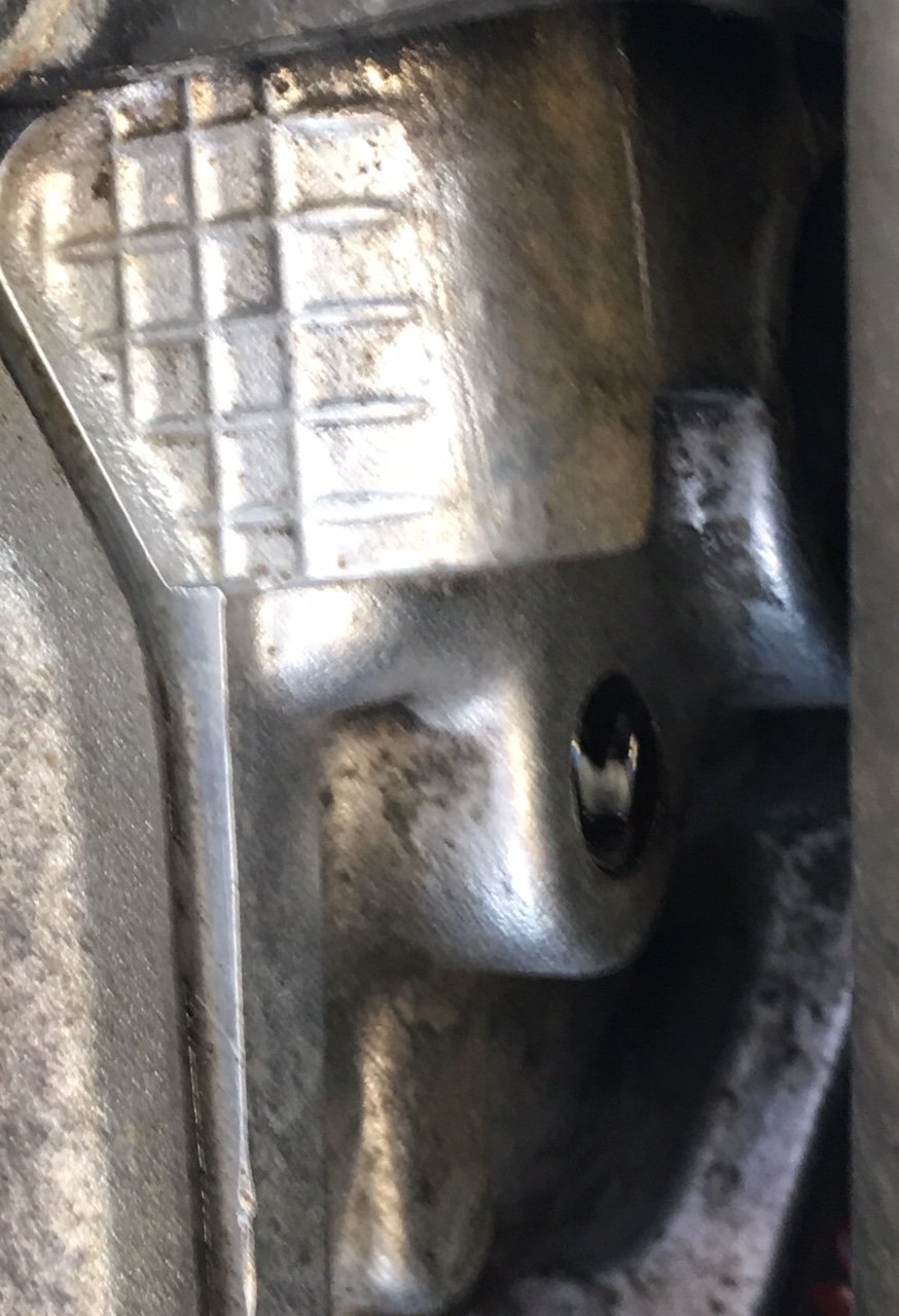

Oil seems to be leaking from here on my engine. First two pictures I've found online and circled the offending location, third picture is the location on my engine that's leaking oil.
Should there be a rubber bung or similar in place to stop this? I can't find it mentioned on any diagrams, workshop manuals, etc.
Closest I've come is that it *may* be OEM part number N90802701 but I can't get any confirmation.
Help would be appreciated!

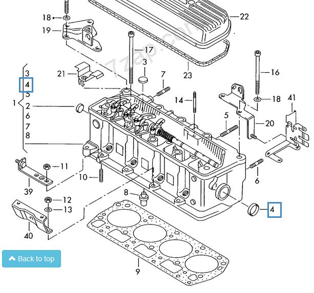

Oddly, it's only showing one plug on ETKA but there is two. It's giving a quantity of two for the same part number but they are different sizes so a bit puzzled about that.
Edited by TMB
Presumably the part number is for both items at once.
Ah, a kit you mean? Yeah could be!
EDIT: Just noticed it's showing the same plug at the other end of the head, so that accounts for the quantity of two. Looks like the one you need isn't shown for some reason but I found a part number below.

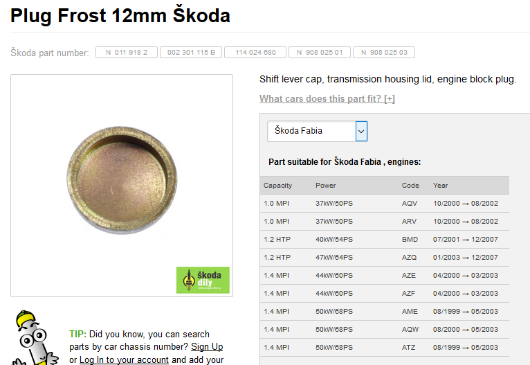

I believe the number of the single smaller plug you need is N0119182 (12mm).
Edited by TMB
  • Sponsor
Great work there Lee. How did you find that?!
Cheers :)
Looked up the part number for the old rear engined Skodas, and the Favorit and Felicia which have the same plug.
