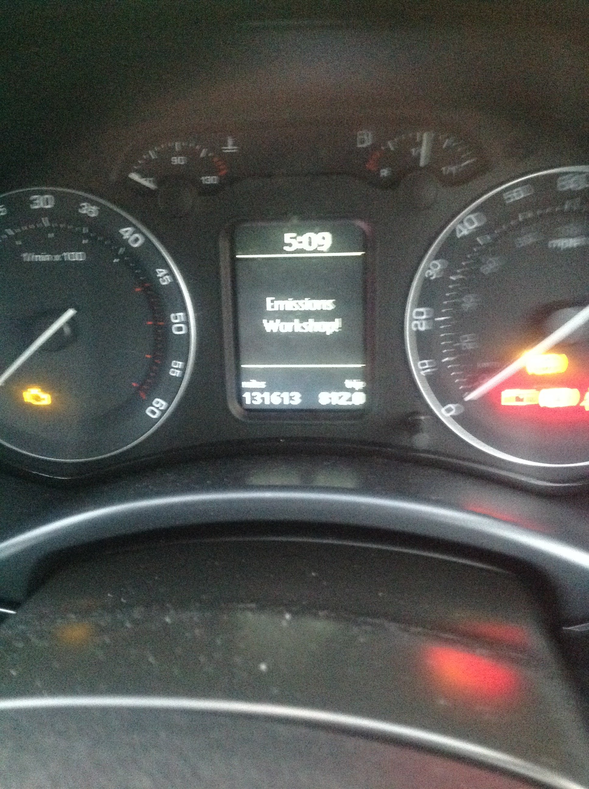

Hi Folk,
coming home last night I noticed my EML came on and when I switch the engine offf and back on I get a dialogue saying "emissions workshop"
Without paying for a second second scan and given my original scan mentioned an issue with the MAF and Glow Plugs could I assume it's the MAF that's gone and not something else ...I was planning on purchasing one anyway over the next few days
Are the MAF sensors available from the likes of  Euro Car Parts or GSF a decent buy and if so what's the best brand to look for ....
Regards
Peter
Best to stick with a Bosch MAF, I think Euro car parts do exchange ones so you will occur a surcharge if you don't provide them with your old MAF.
Hi willydog.... I'd a second opinion taken on the EML and he ran a smoke test which showed a leak in the flexi pipe coming out the rear of the MAF ... On removal it's got a hole in it where it's been rubbing the sharp edge of a metal clip under the pipe.... I've ordered a replacement from EBay as none of my local breakers had one in stock.....
its it's also shown a much smaller leak further down on the right hand side of the engine which he doubts is causing the issue and if it is it's going to a pig to fix as it's pretty inaccessible from above or below the car....
