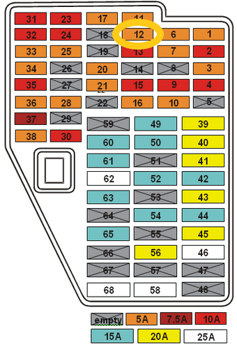

I don’t suppose you know which fuses off the top of your head? I’ve had the interior lighting fuse blow recently, I haven’t put a new one in as It’s not urgent.
Fuse number 12 in the dash fuse box (5 amp - orange colour)...

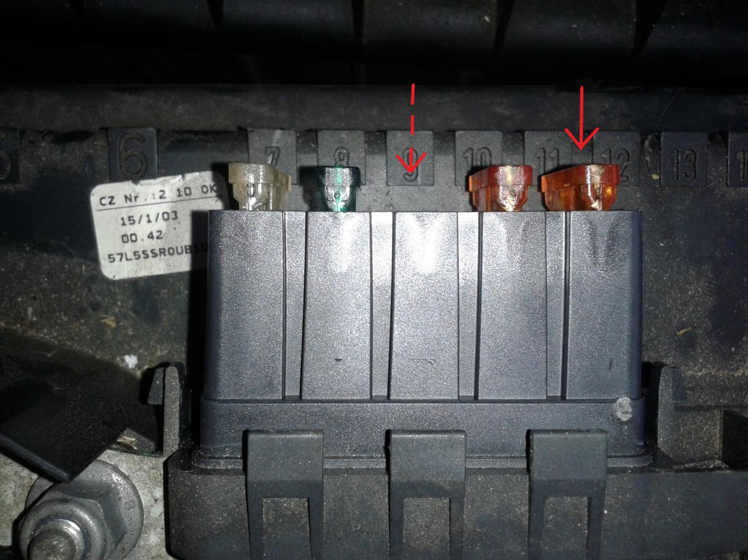

Also fuse number 11 in the battery box (fuse 9 from May 2006). Both 5 amp standard blade fuses - orange colour...
