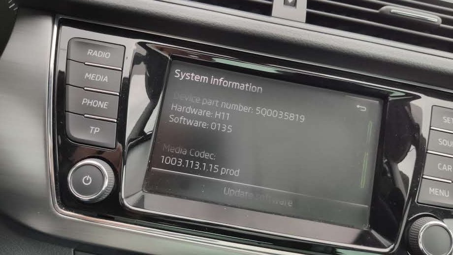

First of all let us know what is the model number and SW version of your current unit - you can check it in menu SETUP / SYSTEM INFORMATION.
No way for 8" screen in Fabia, only 6.5".
You may find that you only need the Skoda firmware/software upgrade package to get Android Auto. I believe it costs arount £150 from a dealer and takes 20 mins or so to install.
here is the system info
