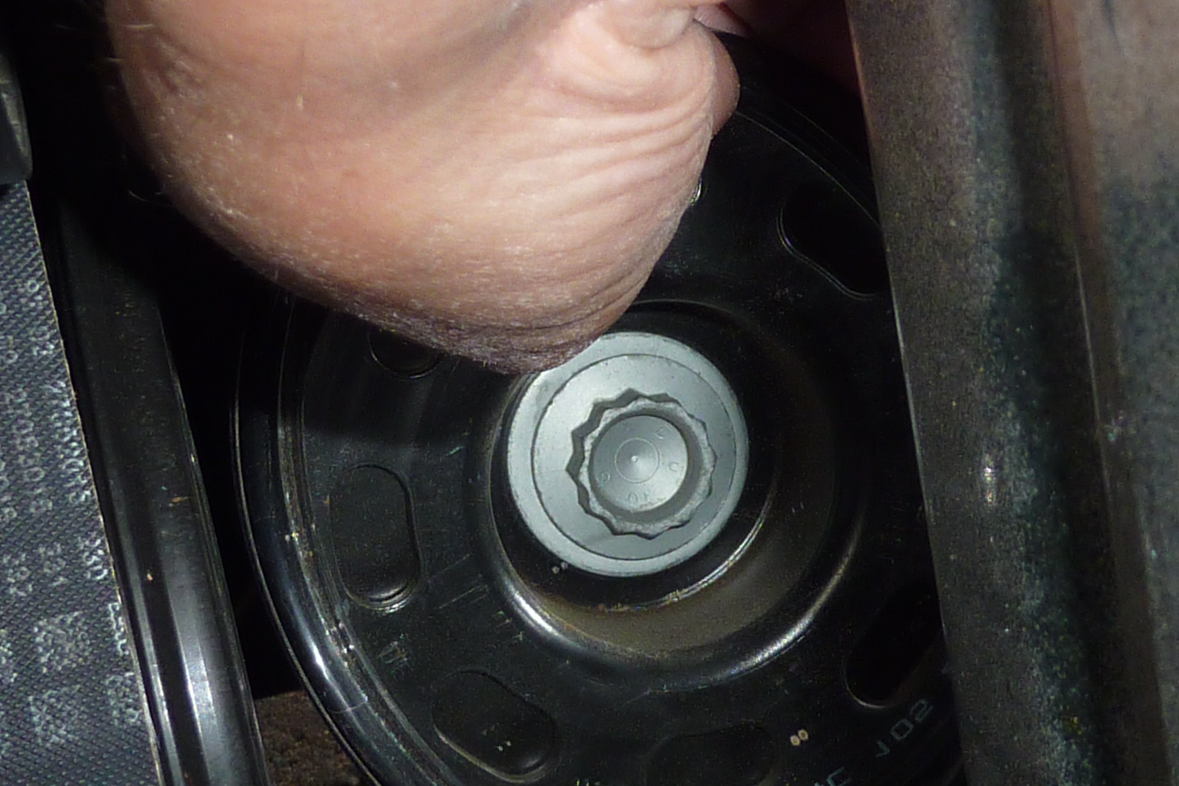

I want to turn my crankshaft by hand so I can inspect all of the cam-belt.  Using a mirror, I've managed to see the crankshaft pulley centre nut but I'm not sure if it is THE nut or a cover I have to remove first.
Can anyone tell me what size and type of socket I would need to turn the crank?

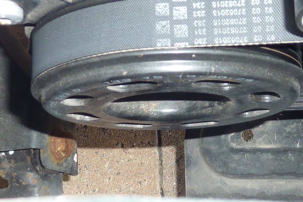

PS In the picture of the pulley, you'll notice a rusty bolt head.  Should I expect this on a 4 year old car?  There are also a couple of rusty bolt heads on the manifolds!

19mm 12pt socket
On 12/07/2019 at 20:57, Tech1e said:
19mm 12pt socket
Thanks Techie
Any thoughts about the rusty bolts?
Regards
Stewart
It’s not unusual, they are right in the firing line for crap, water, snow etc.
