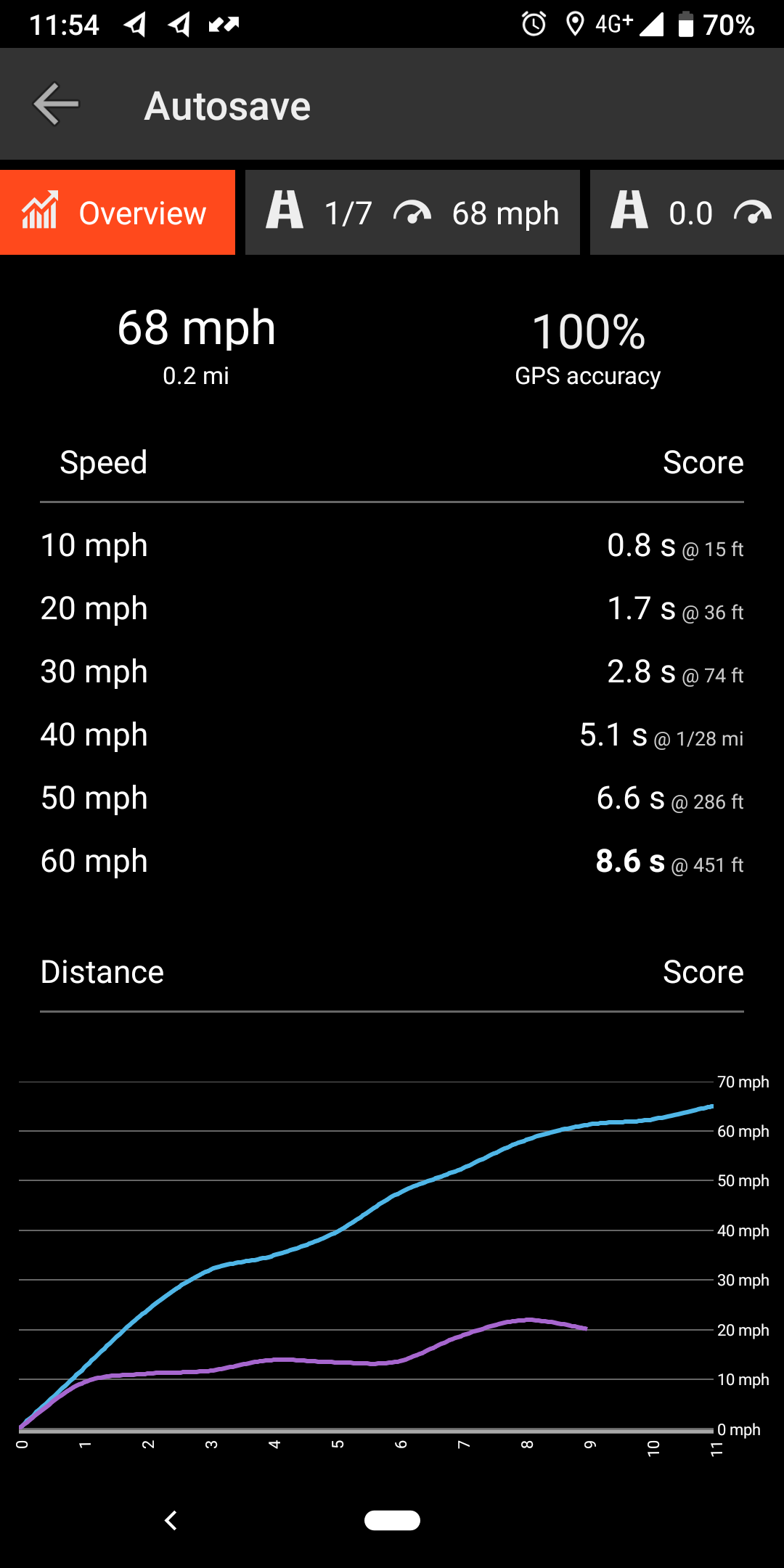

Ecomap returns 43-45mpg at 70 on Tesco 99. Drag Race App I got 0-60 in 8 6 sec from Skoda 11.1 sec.
