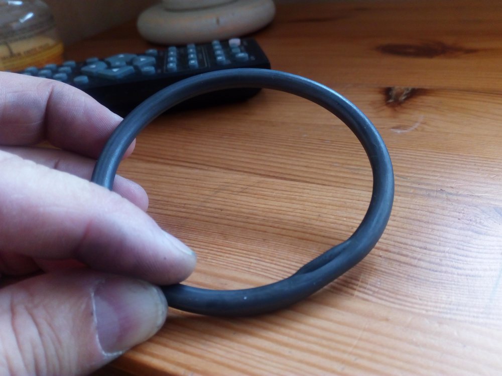

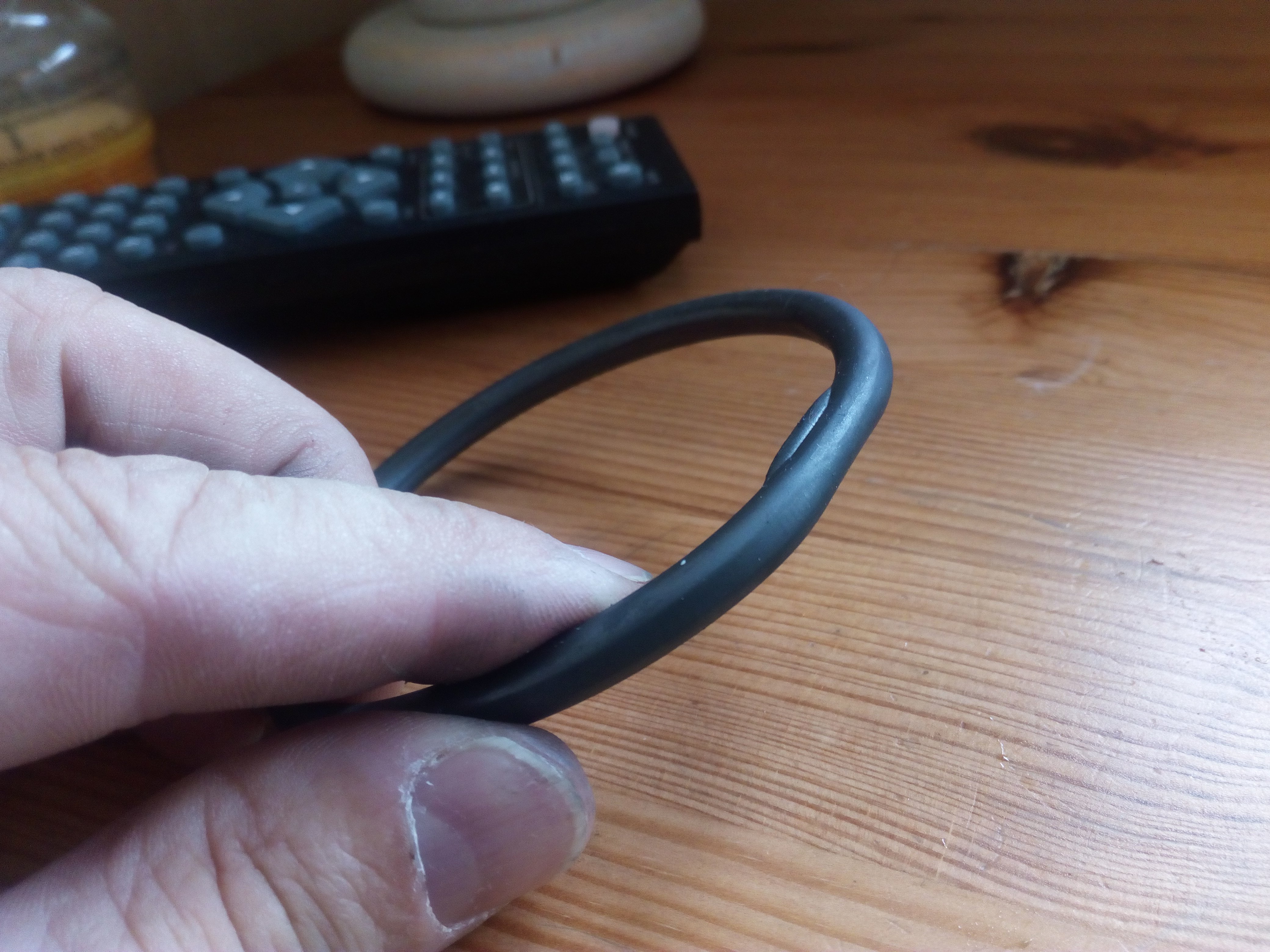

Well guys i Took the maf out to clean it and checked o ring on airbox side .looks like this could be the culprit what do you think?
all sorted now ,it was the o ring on the airbox side , weird but obviously enough to upset the maf..
