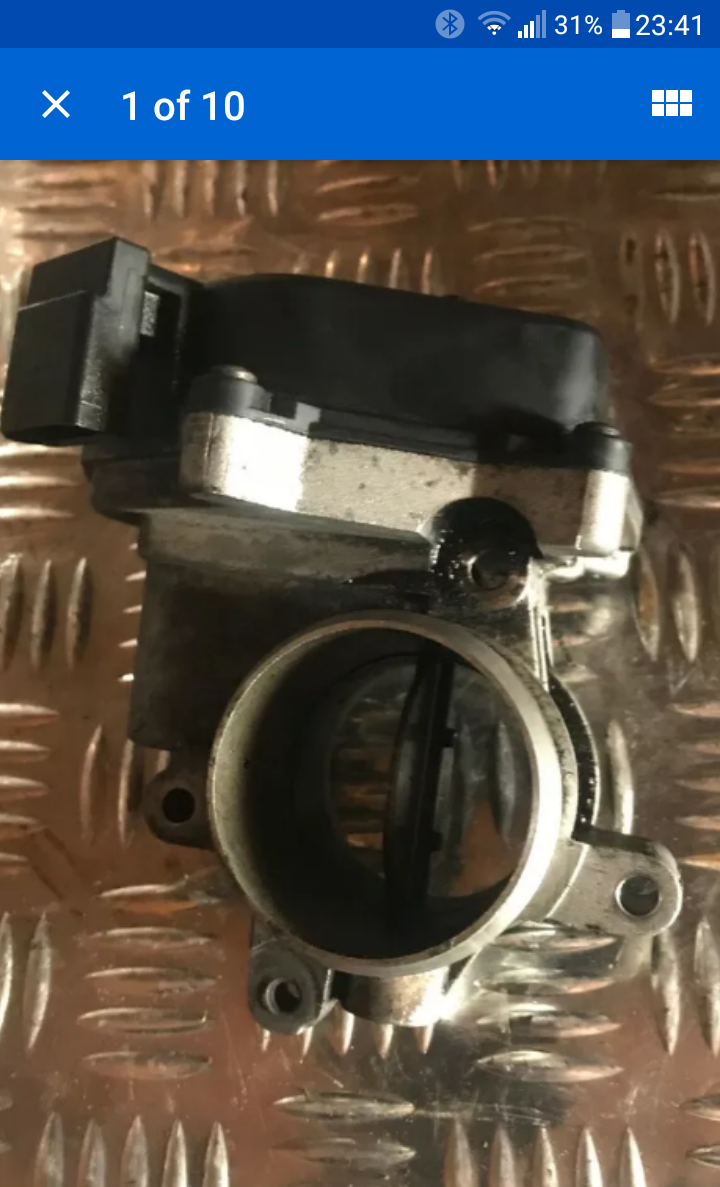

Can you tell me what this part is just before the inlet manifold.
It's listed as a CAYC 1.6tdi CR throttle body and is the same part on my 2014 Spaceback...............confusing.

I've already told you what it is, it has 2 functions to my knowledge and I agree it is confusing if you don't know much about Diesels:
  • Closes when you turn the engine off to give a nice clean shut down of the engine without it being lumpy and shaking the car to bits
  • On part throttle it will close by an amount decided by the ECU, this creates more vacuum on the exhaust side of the EGR to promote more exhaust flow into the intake.

Well it's still called a throttle body under the part number on all parts websites.
Im well aware of the fact that it has 2 functions and that the EGR transfer pipe feeds into it and it's an anti shudder valve of sorts but that is not my issue.
VCDS Ross Tech website and instructions still call it a throttle body and VCDS is programmed as such for adaptation purposes.
My issue is that the process only shows the fully closed and fully open voltages and the registered maximum variations.
I have been using Autel MOT Pro, Maxicheck Pro and Delphi Cars for many years and it's only this software/cable configuration that is giving me a hard time.
Whenever I attempt the learning process the software gives a Throttle Body Adaptation Not Running TBD message and it then sets a PCM fault code with a flashing glow plug light on the dashboard.
This erases immediately and doesn't reappear until the TBA process is attempted.
So, whatever part you wish to call it is immaterial;  adaptation following cleaning or replacement is still supposed to be able to be carried out.
