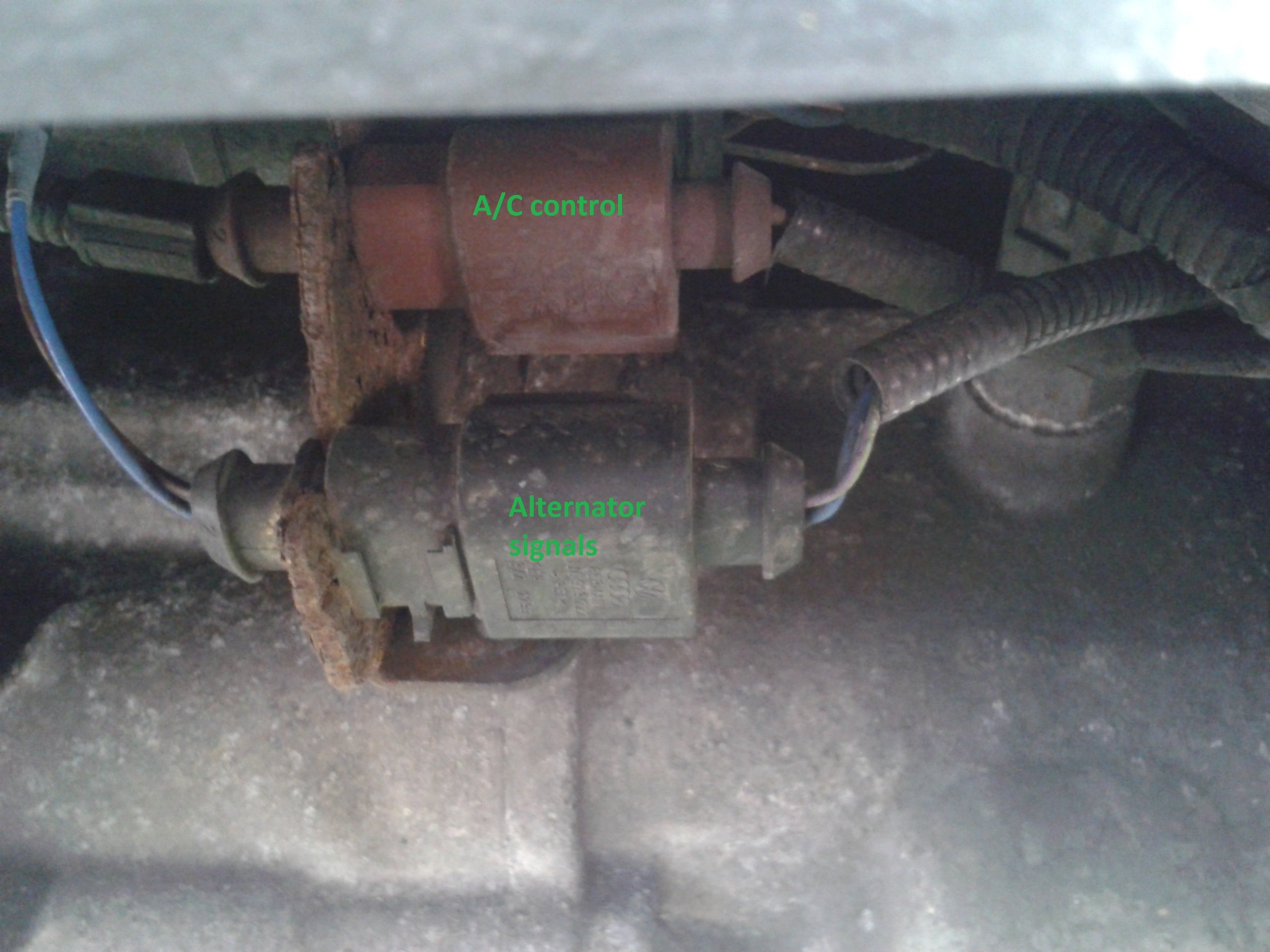

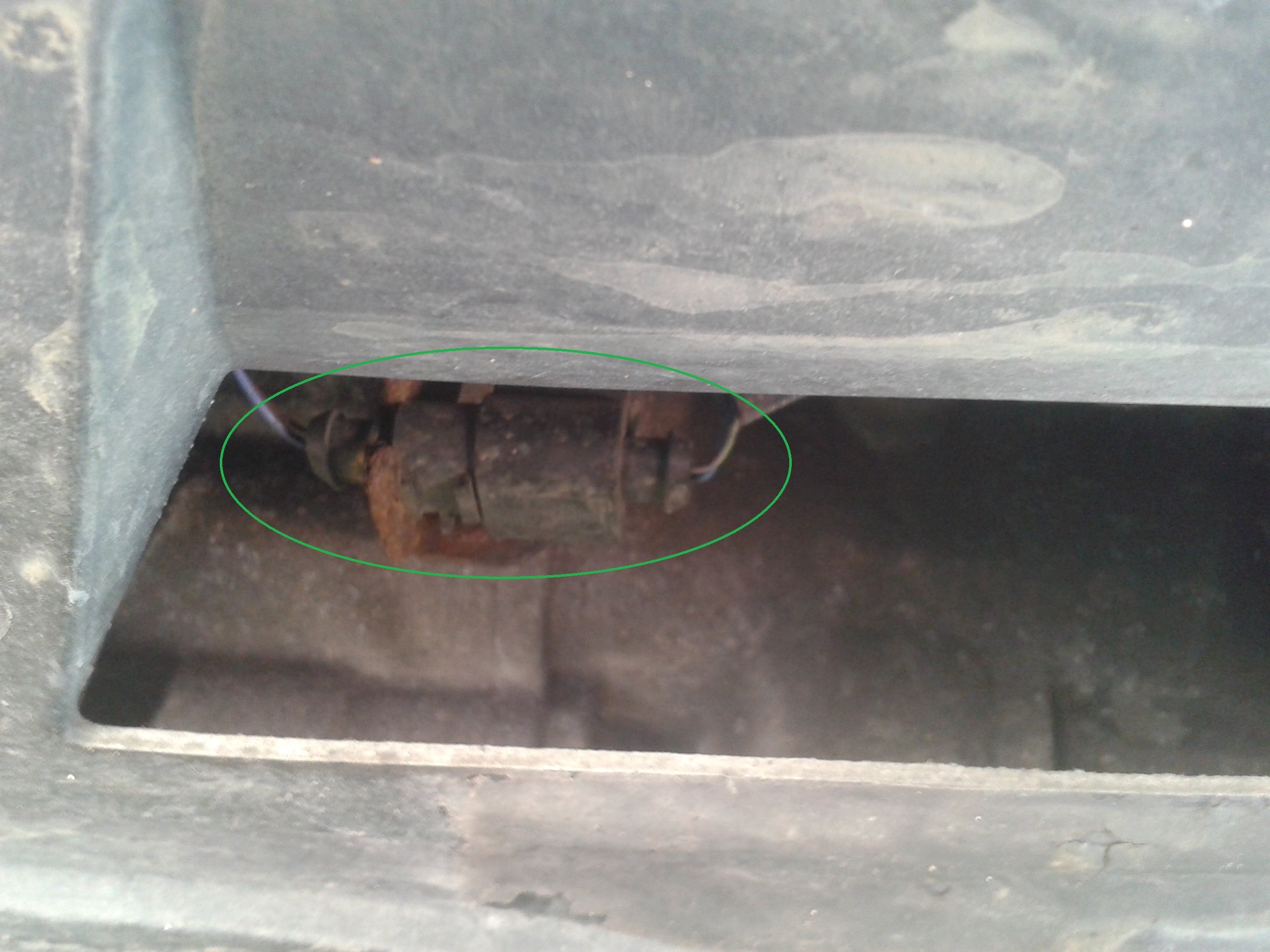

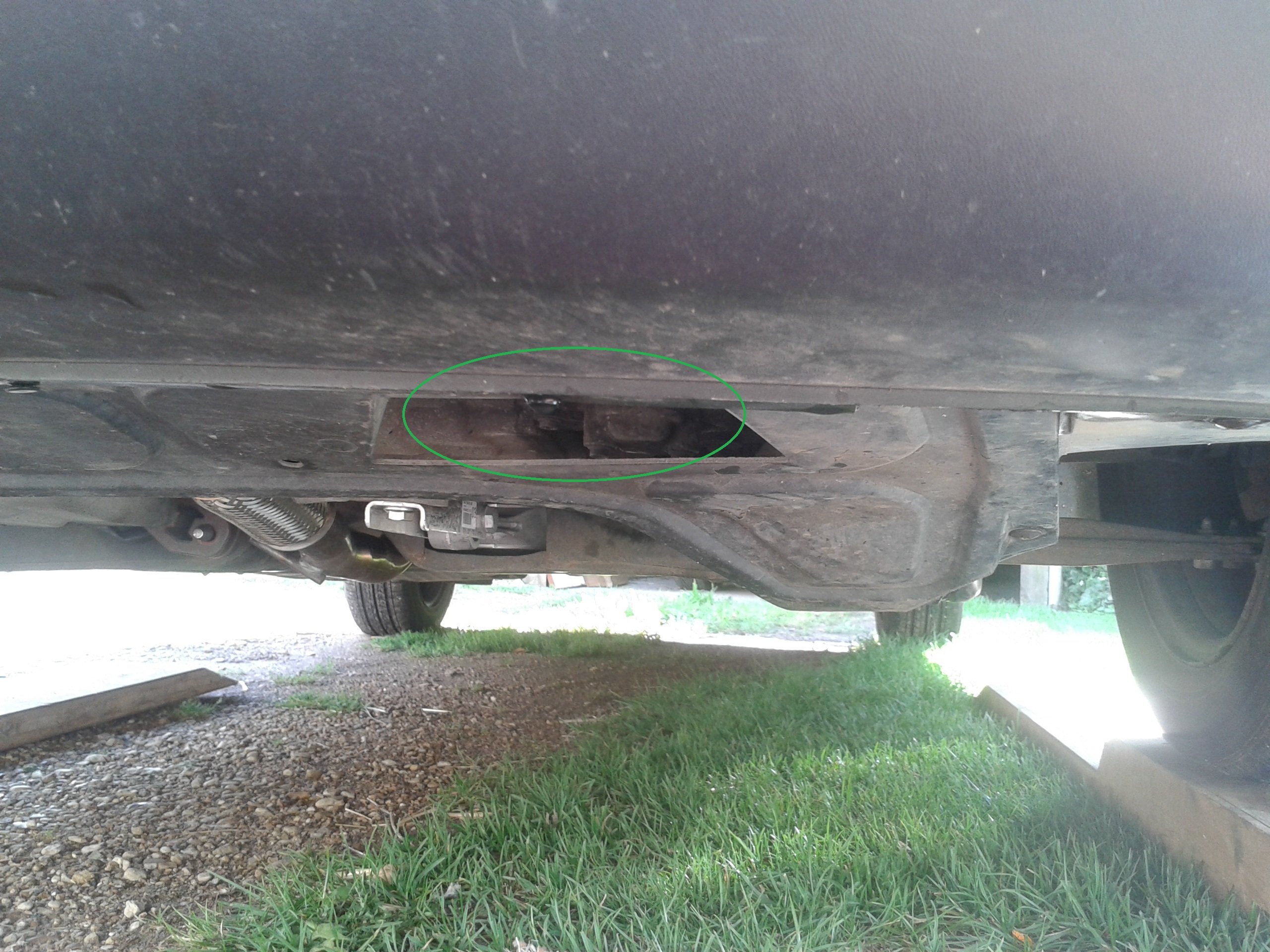

OK, given that your scan is showing the very common DFM wire fault, it will be well worth your while having a little look under the car in the vicinity of the front of the gearbox.  There's a bracket there that holds a bunch of connectors, including the alternator signal connections and the A/C solenoid valve connection.  Super-common for wire breakages to occur in this area.
Some photos of where to look. This is actually my petrol-engine 9N Polo, but I think other than the undertray maybe being different, the location of the connectors will be very similar.
With luck you'll find broken wire(s) on both alternator and A/C connectors and fix two birds with one stone.
