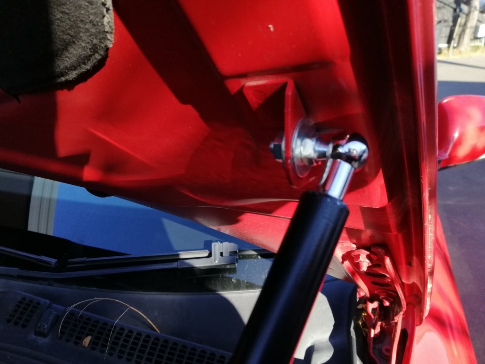

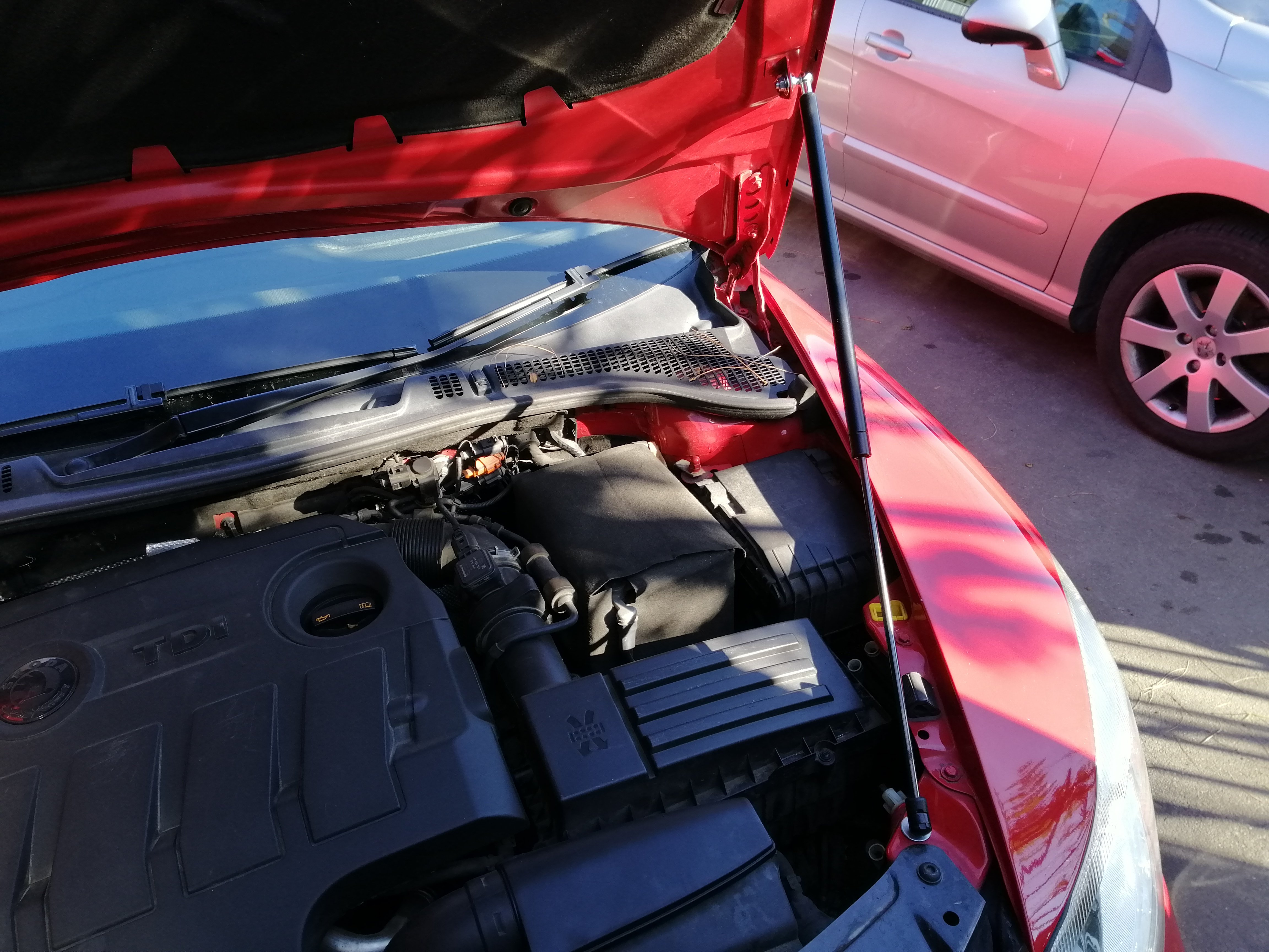

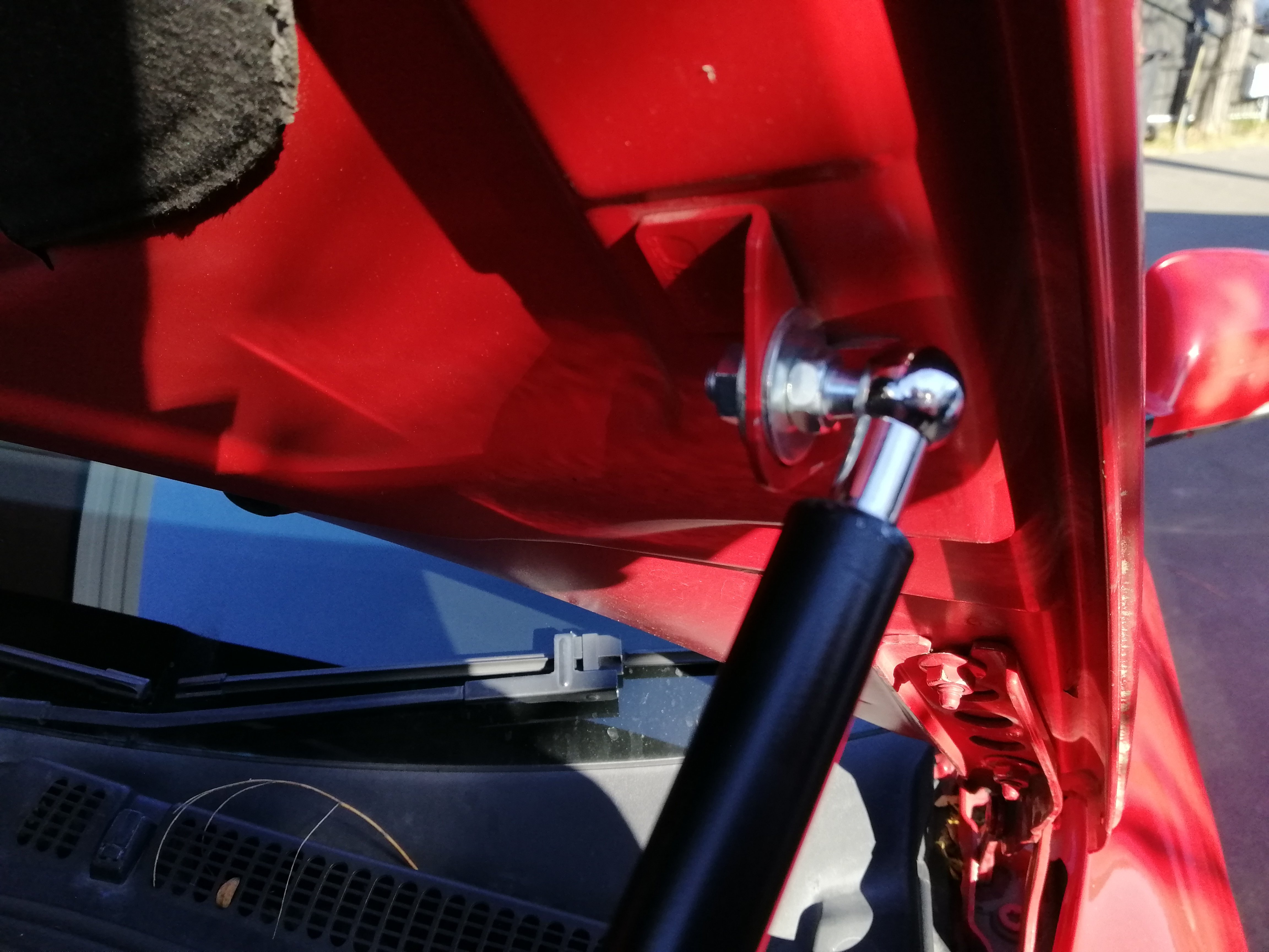

Update - I ordered and have now installed the Ali kit provided by softscoop.
The quality is not too bad for the fact that it's from Ali. It came packages with the strut, the mounting piece and necessary hardware, as well as a horrible microfibre cloth.
Installation was easy. You have to remove the FL head light assembly to be able to bolt up the mounting point to the chassis, but nothing major. At that point you can plop on the bottom part of the strut, and you can remove the factory bonnet strut from the hood by pulling on it. The grommet had to come out sadly, and had to be cut off in order to get it out. While supporting the bonnets weight with your head (like a real man), you just tighten the top bolt and you're away laughing.
The fact that its only held on by one side is not ideal, as others have said, you do get a bit of flex when you first try to get the hood to close but it's nothing major. Other than that, it supports the hood surprisingly well, although it does look a bit out of place. The strut is very Chinese so you do get a bit of "rubbing" when the strut fully extends but for $18 USD you can't complain.
Overall, it's a great little upgrade for $18. Few pictures below to show finished product.
