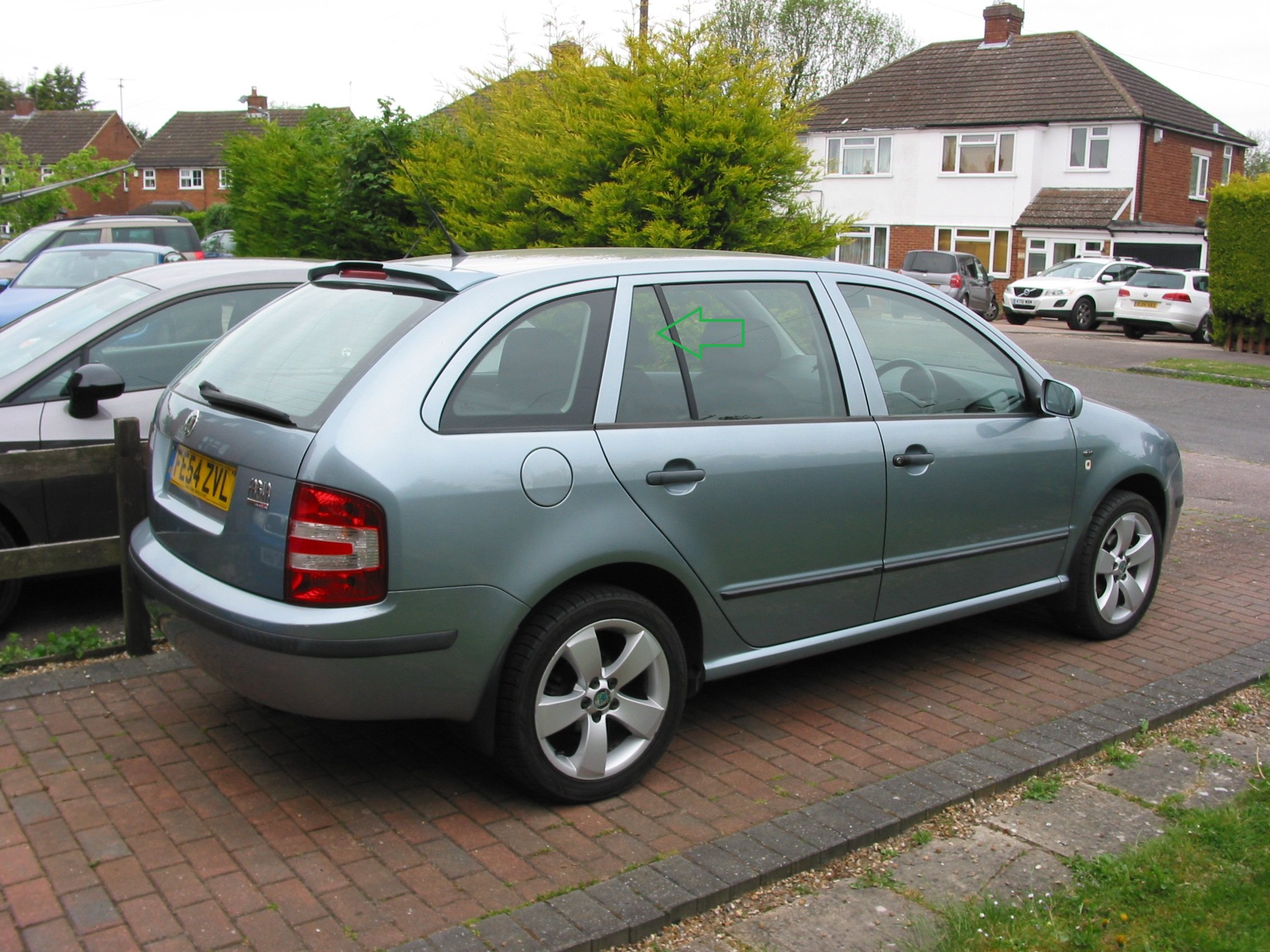

So assuming as you have taken the door card off you mean the one in the door.
The main window glass has to come out and the rear 1/4 light comes out with the whole channel and seal.

Which window has been broken? The quarterlight in the door, the wind up and down window in the door or the window in the rear body pillar?
The wind up one
12 minutes ago, barbecues0da said:
The wind up one
So not the one I arrowed?
It's not tricky to fit but it is a pain. I did my rear door quarterlight months ago and the longest bit was vacuuming out the glass, bits of which were in the boot and as far as the dash and front footwells. You are best taking out the regulator carrier. This may be held by bolts or by rivets which have to be drilled out. The glass is held to the regulator by a white plastic double pin, one inside the other, which are reached through a central hole covered by a black rubber bung. This must be re-used and is inserted in the new glass very carefully before the glass is fitted.
