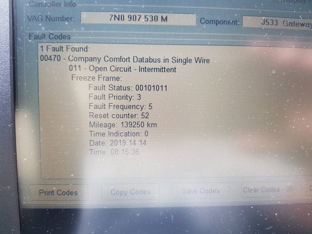

I tested my SO2 FL a few moments ago and I found an error I don't know how to fix.
I must tell you I activated the whipe function of the instrument cluster and before it no such error had appeared.
I took a picture of the log and post it here.
Anyone?

It's probably a bad wire or connection.
CAN bus uses a twisted pair of wires, both are used to send the same information but use opposite signals. That error suggests the comfort CAN bus has a fault on one of the two wires so is only using one wire to communicate.
Given its intermittent, I'd clear it and see if it comes back.
If it does come back, post a full autoscan rather than just a picture 🙂

Comfort canbus is in single wire mode.
Look in the MBV of gateway and see if the network is down and on what side. Then it’s a case of checking units and wiring harnesses for breakages.
