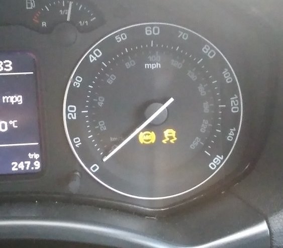

This is the 2 lights I'd lit up on my car recently and I too was getting conflicting advise on wether it was the speed sensor that plugs into the back of the hub or the ABS sensor within the hub but I at least knew it was the right front wheel which a decent scan should tell you ....
in in the end I needed new pads and discs and all round and got my garage to replace both hub and sensor whilst they were in ... Mechanic still isn't sure which it was that caused as neither looked that bad but problem is solved ...

Hi ok thanks for the input at this time I have only the ESP light on and never had any ABS lights on.............yet. Had the car a year and of course it's not time.
