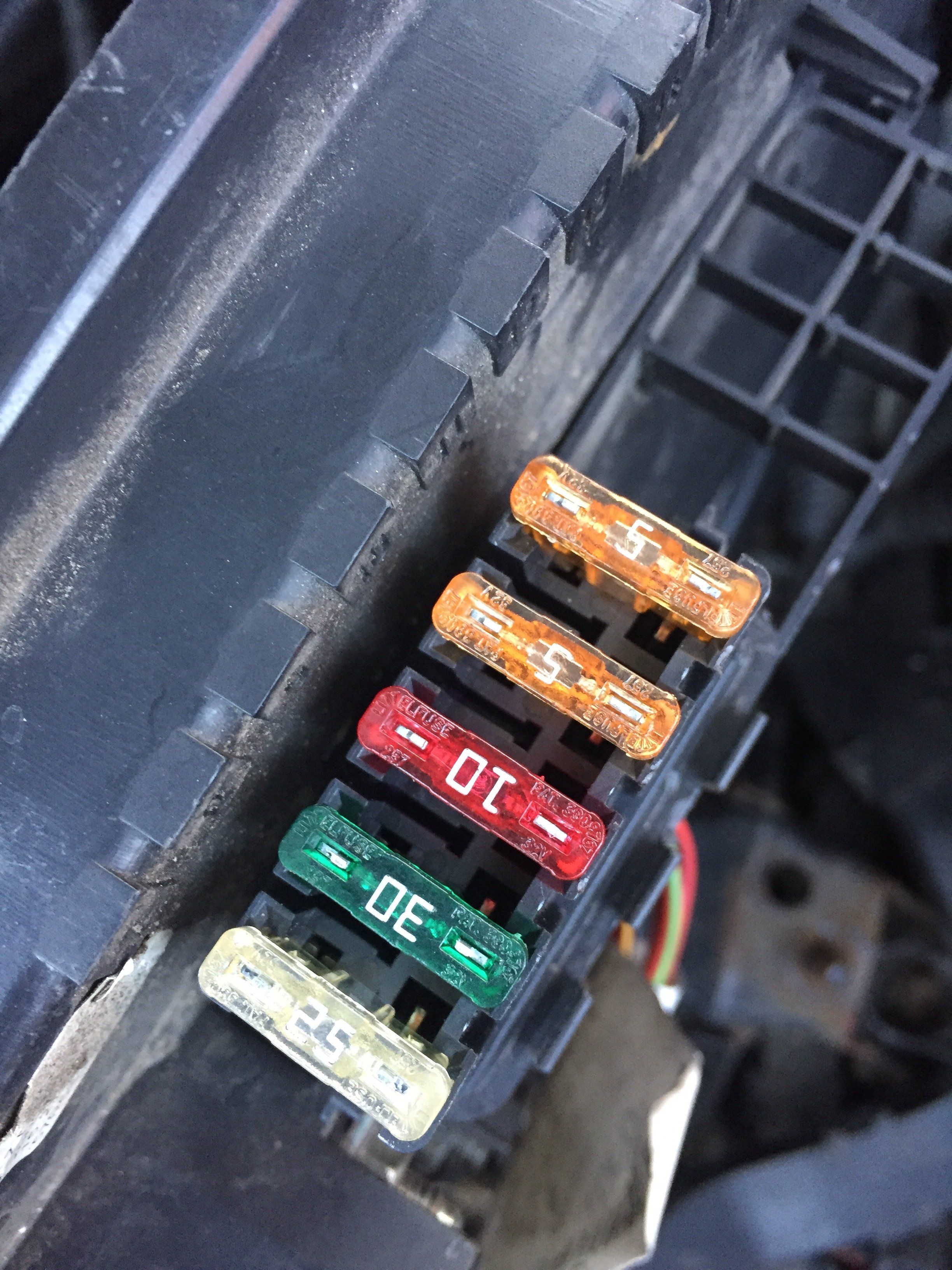

You should check fuses since the relays are switching ok.

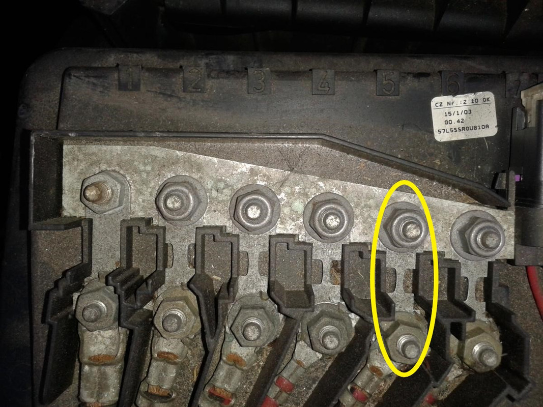

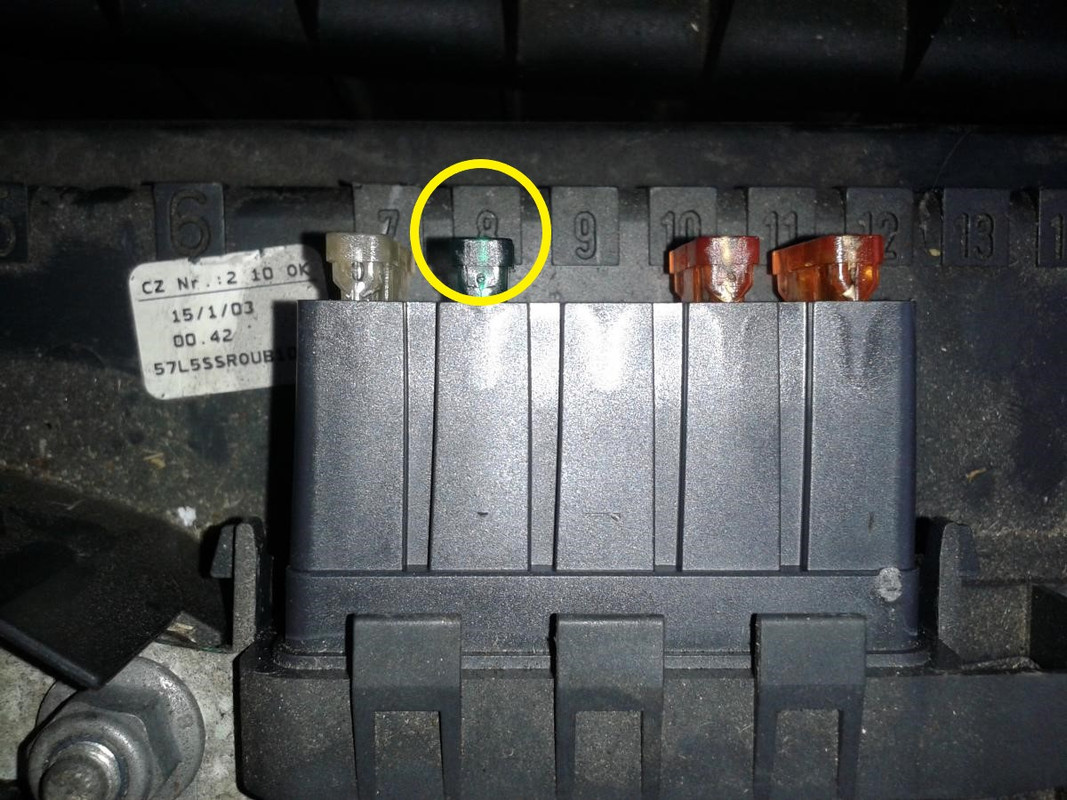

Fuse 8 (30A) and fuse 5 (40A)  at the battery...
I’ve tested fusses all okay I’ve also cleaned the connectors on all wires that sit on top off battery
