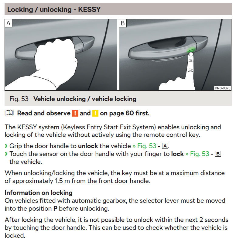

How are you trying to lock it?
If you are grabbing the handle then thats your problem (as you are trying to unlock and lock at the same time).
Touch the rectangle at the rear of the handle with the back of your hand and the car should lock.
(the only reason I say back of your hand is it’s impossible to ‘unlock’ the car at the same time this way.)

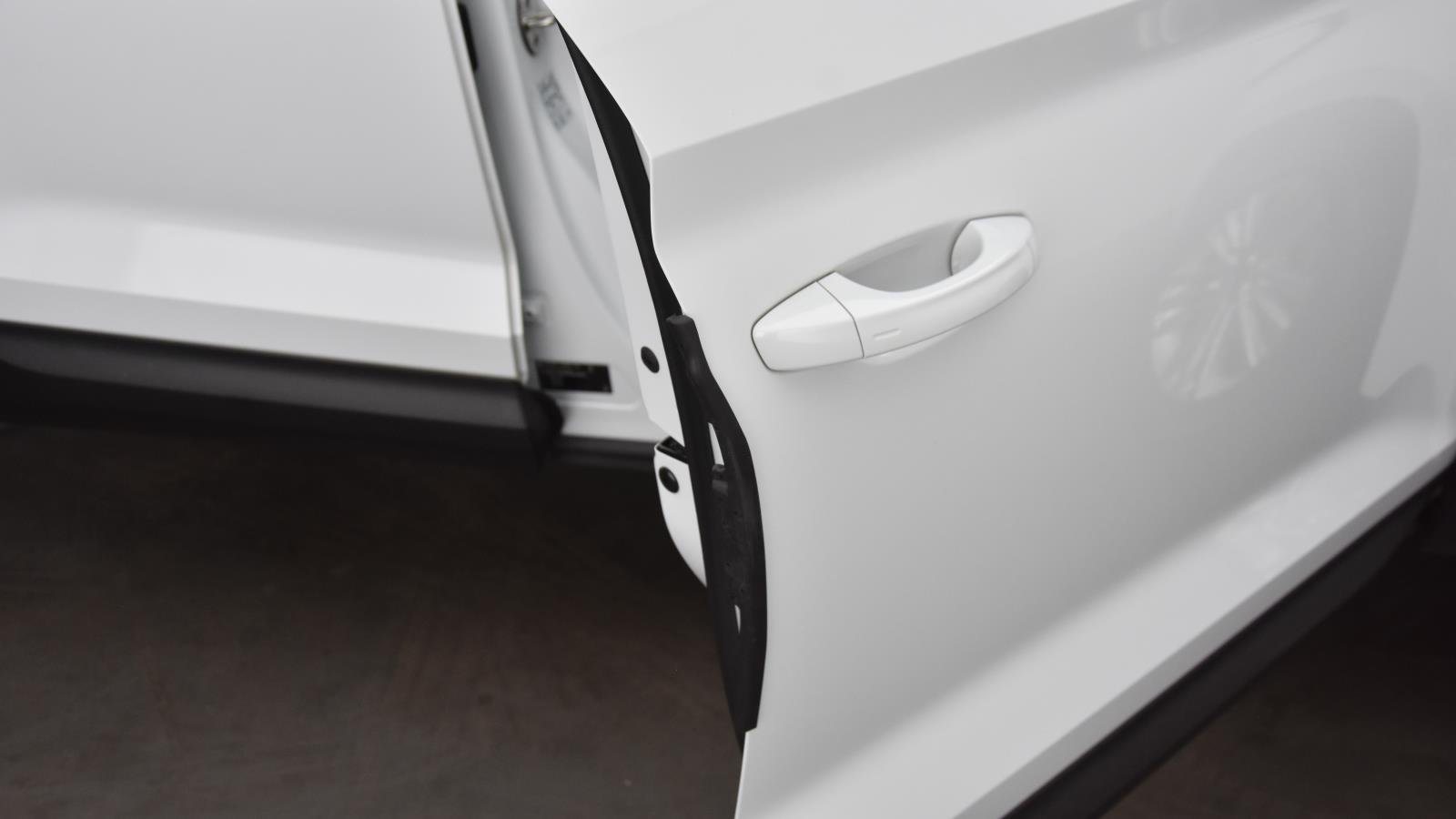

On the passenger door there is a raised part that when touched locks the doors. On the drivers side this is flush with the handle.

So you don’t have the rectangular indentation on the door handle?
