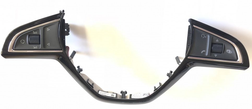

I have been able to buy an MFSW with flattened bottom and DSG paddles (5E0419091 BT CXA) from a 2018 Octavia. This handlebar has the VIEW button, so I would have to transfer the multifunction buttons of my current handlebar.
Unfortunately, my current steering wheel controls have no inputs for the plugs coming from the DSG paddles.
That's why I have to look for the same steering wheel controls as my current MFSW.

Over de wielbedieningen; die van het nieuwe stuur komen niet overeen met mijn MY13-knoppen, kijk hier beneden.
MY13 MFSW-functies, dus ik heb momenteel (maar heb er een nodig met DSG-ingangen):
MY18 MFSW-functies die in de MFSW waren toen ik hem kocht:
Dus ik kan de knoppen (3V0919719F) van de MY18 MFSW niet gebruiken en deze zijn te koop ..

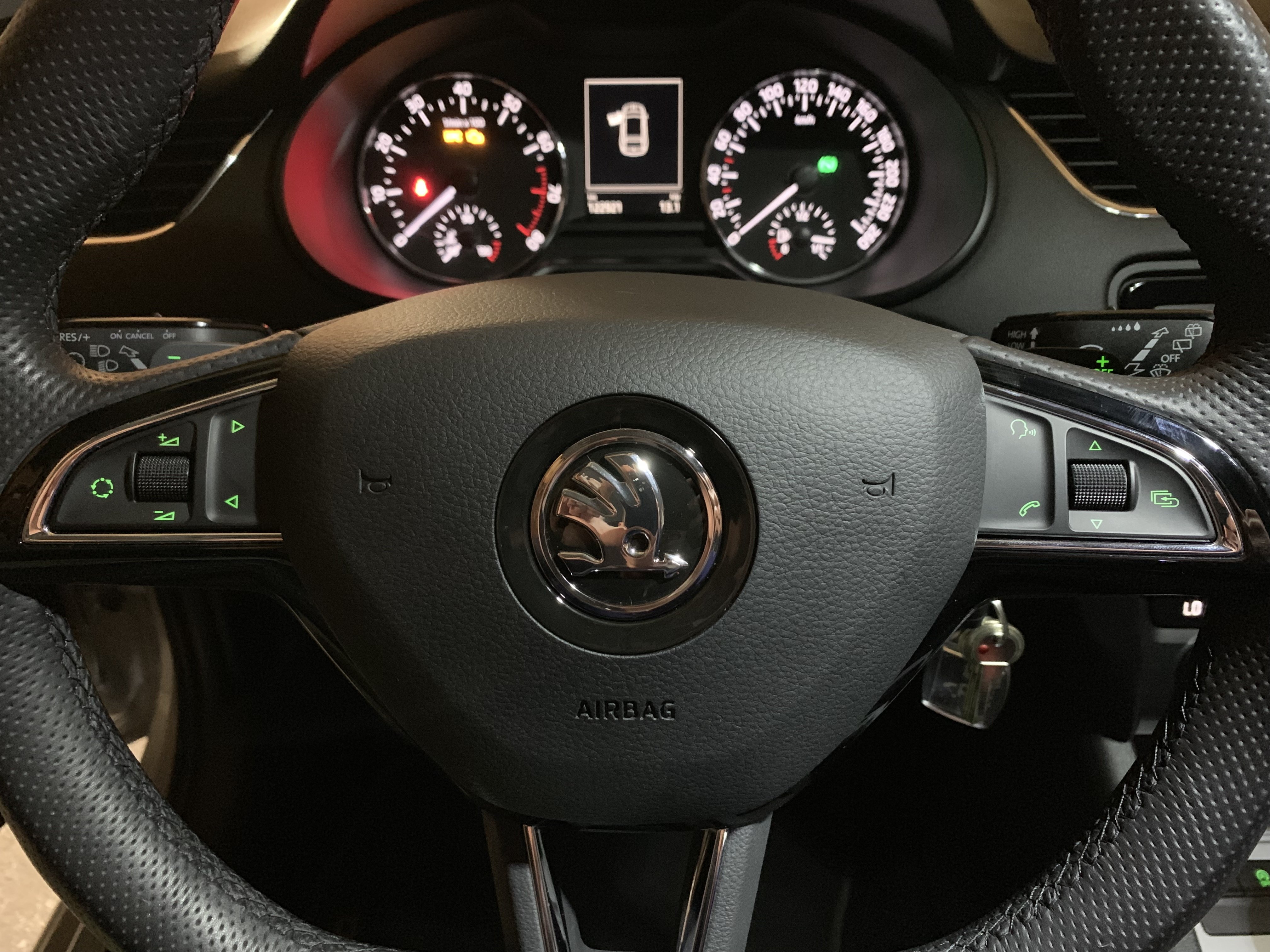

It finally works well!!!!
How did I finally fixed it? Well our Czhech friend was right!!!! White DSG-paddles CAN'T communicate with green buttons.
Now I changed white DSG-paddles for green ones, it works as it should be!!!! I didn't need to code it with VCDS, it just was plug&play.
For the record; I got a 2013 Octavia DSG-7 with a MQB Gateway MID!
So now this is how it looks like...... Happy man!
