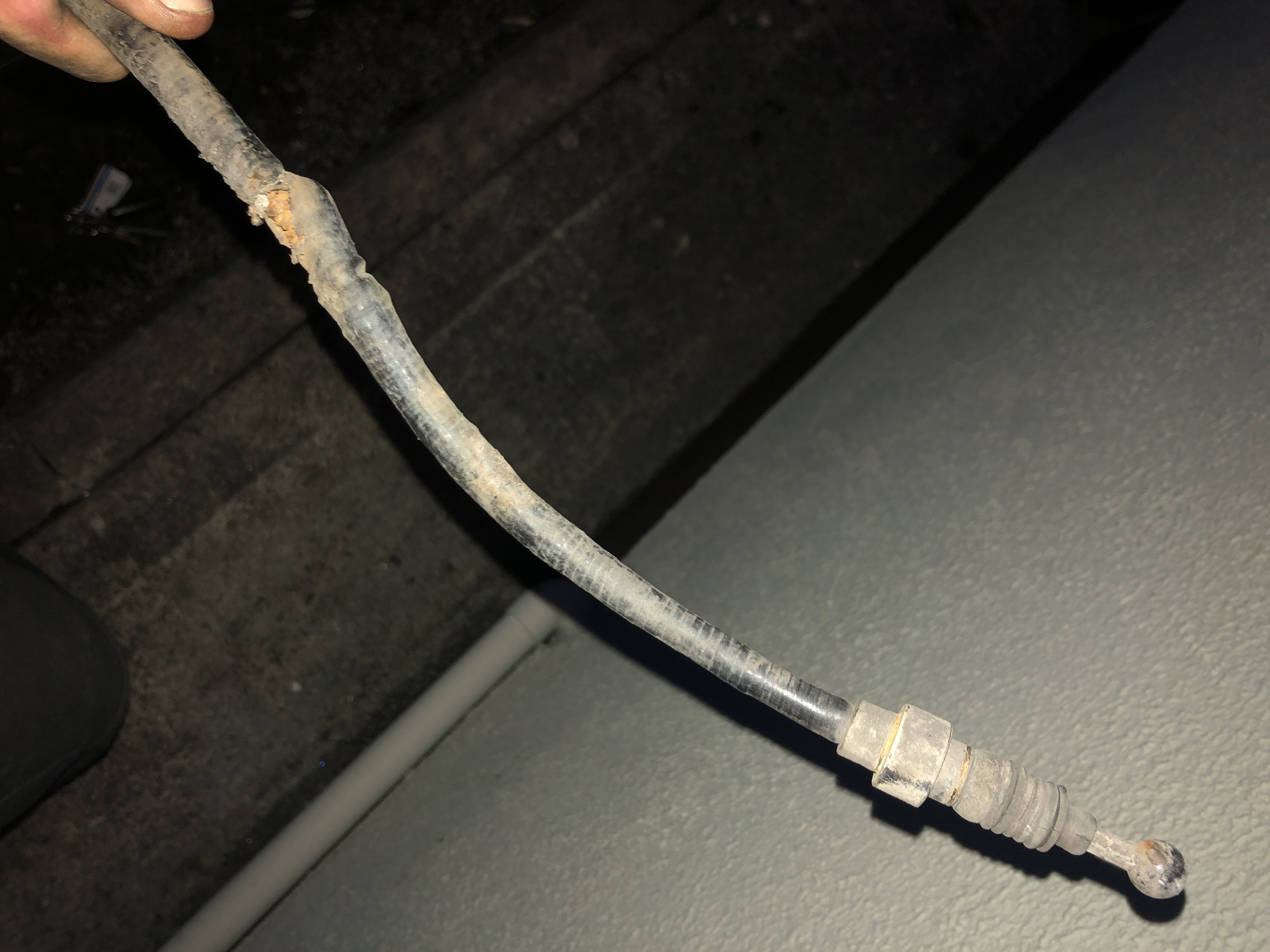

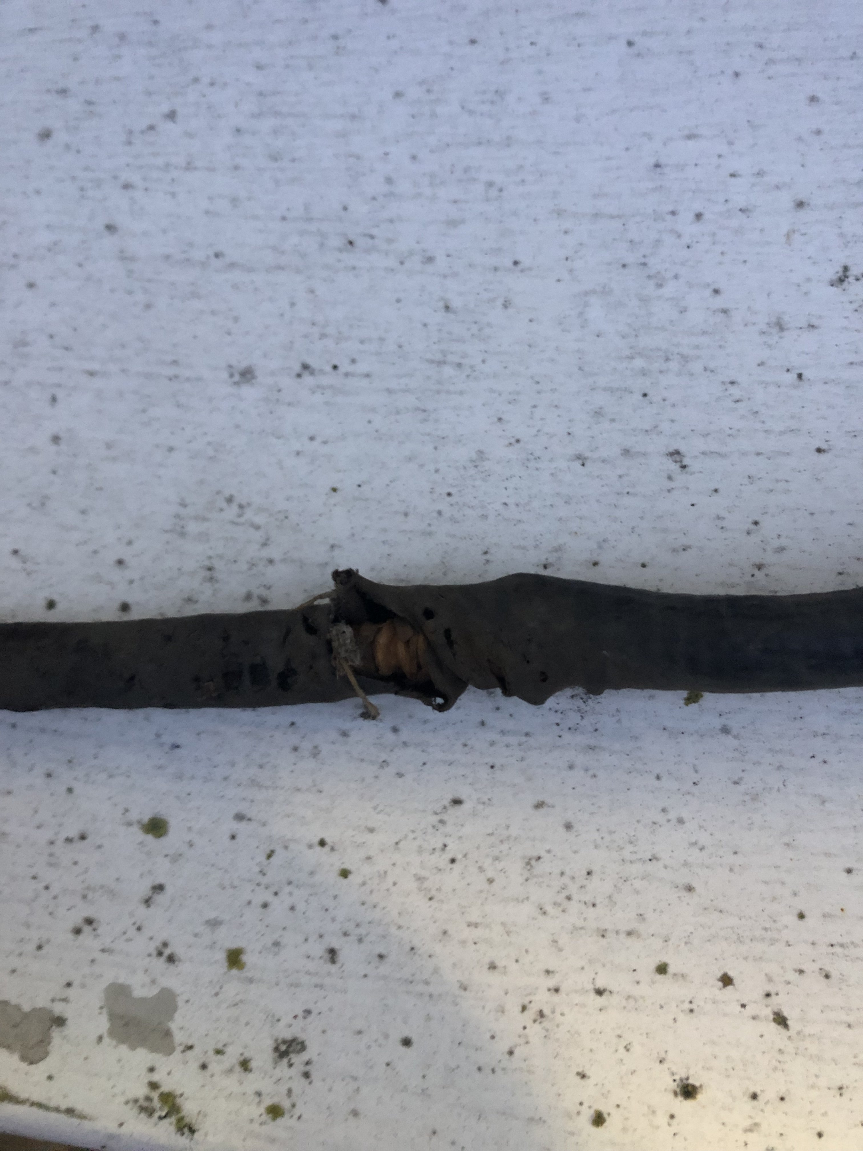

So finally got around to getting the cables replaced. All seems to be back to normal, see attached for offending problem, hidden behind the spring hence why I didn’t see it on initial inspection and only because evident when I got properly under the car.
also had my timing belt and alternator pulley replaced so I’m sitting on 472’000 km with a recently replaced fan belt, timing belt, alternator pulley, and a new clutch and flywheel within the last 2 years, so she should keep me going for another while at least!
