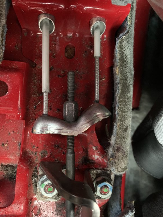

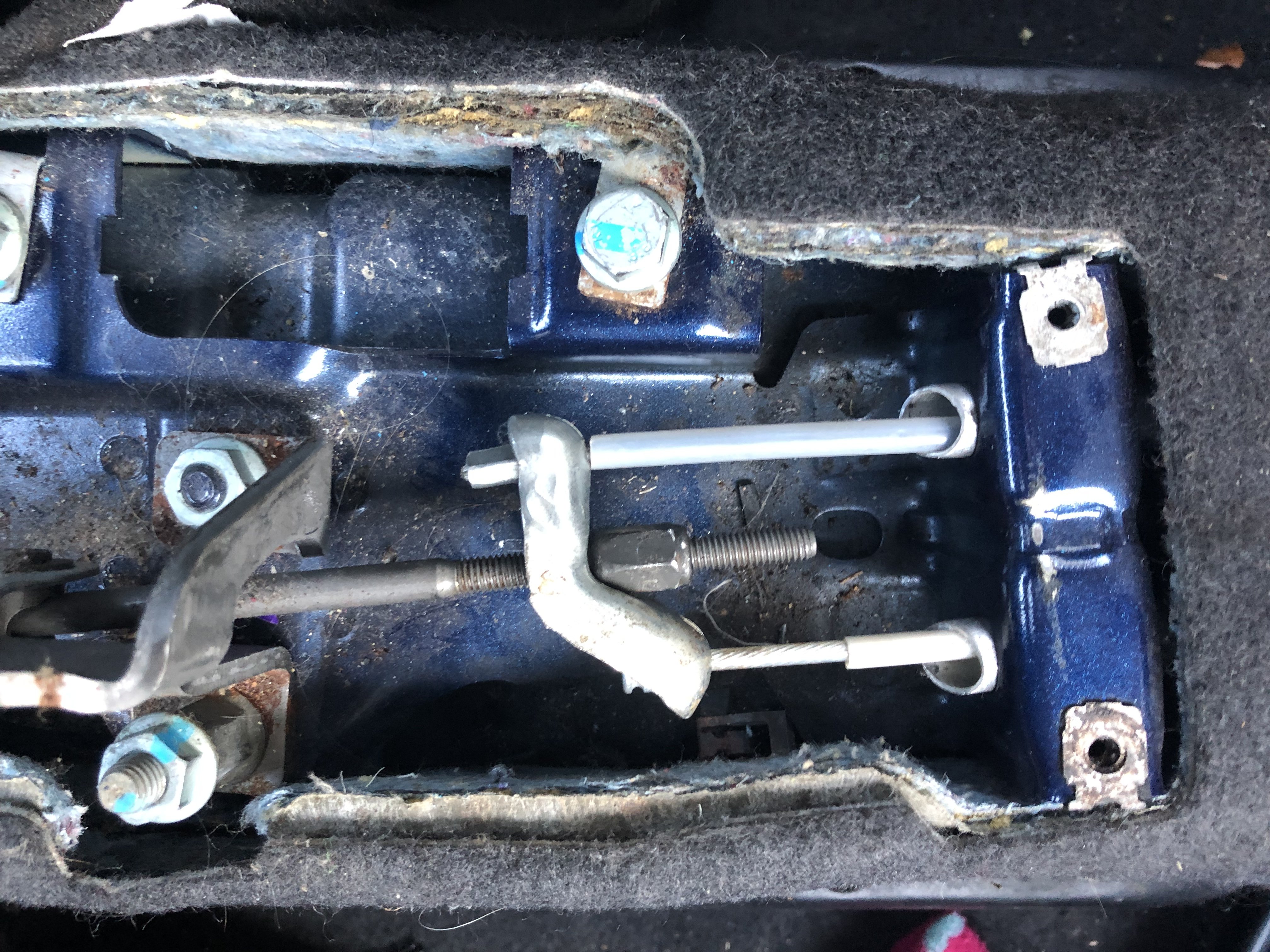

these are photos of the handbrake on and off

Looking at the pictures I’d say you have a rear calliper sticking. Or a snapped cable. Check the arms on the callipers are both back on the stops.

That metal bracket shouldn’t be bent like that. Every octavia I’ve seen has this, they’ve clearly used week metal. So when people yank the handbrake to hard it bends that bracket making it not pull both the cables straight. Now this could also be the wires stuck or callipers.
This bracket should only have a slight curve to hold the wires. Not bent into 90 degrees.
I’d check to make sure the callipers are not sticking, and no resistance in the wires. If not replace that bracket.

That was my thought aswell, compared to diagrams i'd seen of the part i thought it was bent a bit more than it should. Now luckily enough replacing the cables that bracket only costs 4 euro so i was going to do that aswell while i was at it. so i'll see from there if that plays a significant part.
I don’t think it’s bent, it’s just off centre
Agreed, based on literally every hand brake I've ever adjusted at the lever.

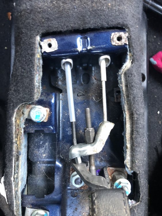

  • Administrators
This is mine. I actually saw this bend as I was applying the handbrake and again as you’ll see one side is pulling the cable* more which came up at the garage saying exactly the same thing. How the left side looks is how it should be, the right has been bent back...
Sean, when your new bracket comes upload a photo, as I swear they’re not meant to be this bent. Be interested if I’m talking rubbish! 🤣
