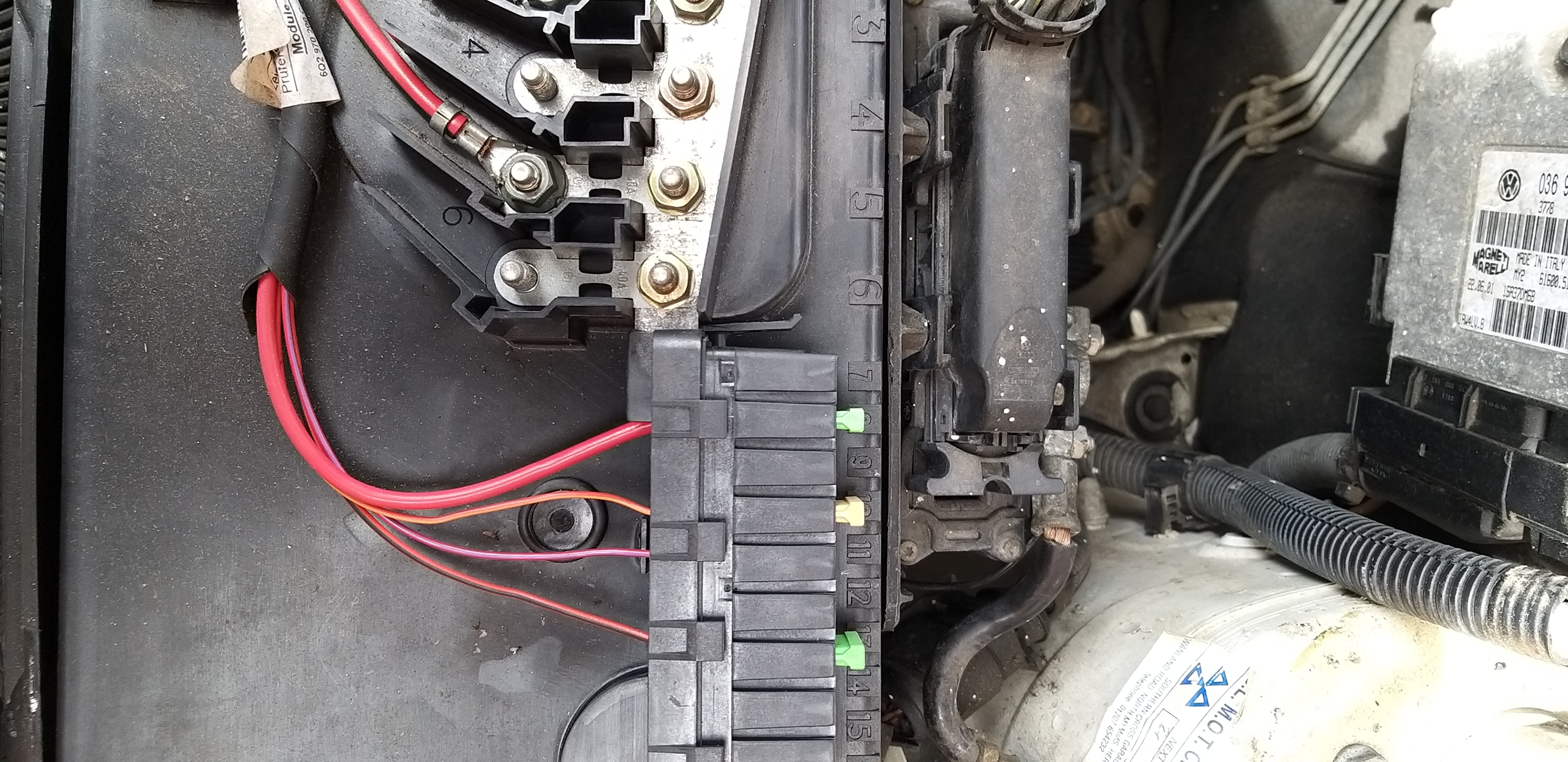

Hi. Can anyone help? I've lost the No.11 fuse from the battery cover.  Can anyone tell me what size is it? The 3 remaining fuses are 2x20amp and 1x5amp. Also, when I turn on the ignition, the warning lights flash like mad and the car clicks madly and will not start. I've taken the battery out and it's charging.  Thanks
What engine?
can you post a pic?
It's a 1.4 auto 20190811_123747.thumb.jpg.59f740d142187c89b69b4cd5d35adcc7.jpg
#11 is a 5amp for the aircon upto 2006 from 2006 it's still a 5amp but for the onboard power spply unit
