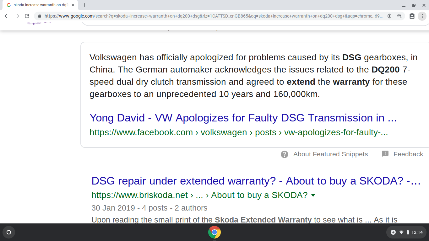

so ask in writing if the Warranty on the DSG was increased in Israel as in some countries to 160,000 km / 10 years

1 hour ago, Roottootemoot said:
Good
Thanks for the info!
I'll check with them on Sunday and will update

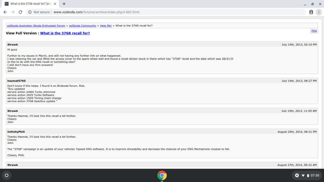

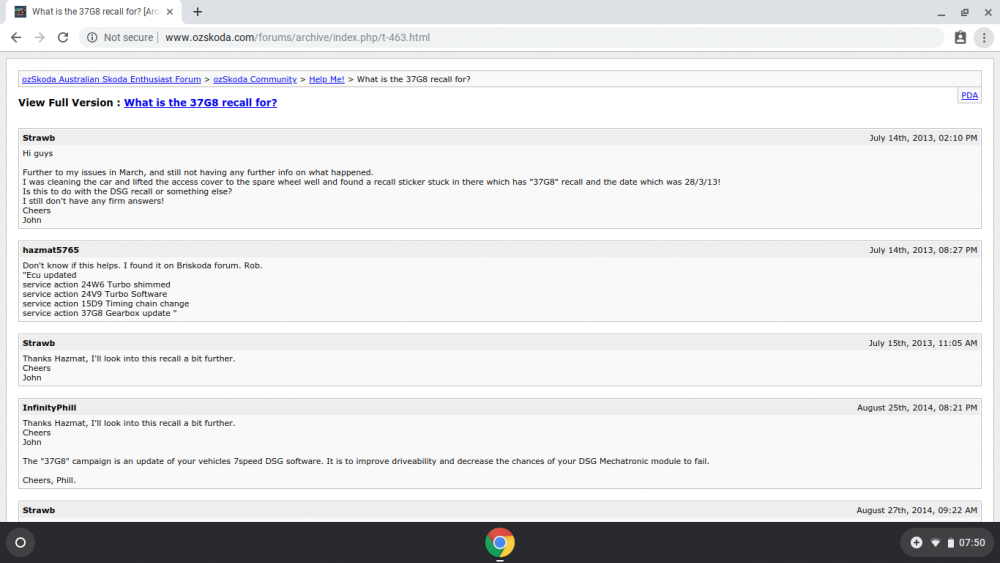

Ok, so i just spoke with them today morning (with the Skoda service) and they told me the gearbox got only through "software update" was part of the campaign to 37G8, so they didn't replaced the mineral or the oil.
What does it means?
They also mentioned that for any trouble with the gearbox i need to pay from my pocket and there is no warranty for this campaign.
Please help me what should i do?
What does it means?
Well, it definitely means that you haven't correctly understood or translated what you were told, if that was correct.
Mineral is a type of oil; as are synthetic oil and vegetable oil. So you don't change the the mineral and the oil independently. If I've kept track correctly, some VAG transmissions are subject to a recall to have the oil in them changed from a synthetic oil to a mineral oil.
& not all DQ200 DSG's from 2009-2012 had the Synthetic oil changed from Synthetic to Mineral oil and had a Software update in Europe / UK
because Skoda / VW / Audi / Skoda said they had mineral oil in from the factory.
Some of those are failing in the UK now with the 'Flashing Spanner' symbol.
Those in Europe that had Mineral OIl in should maybe have had '37 G8' carried out, the software update, but i had never heard of it being done.
I have asked in the Fabia MK2 section if anyone has in the pinned DQ200 Service campaign thread.
