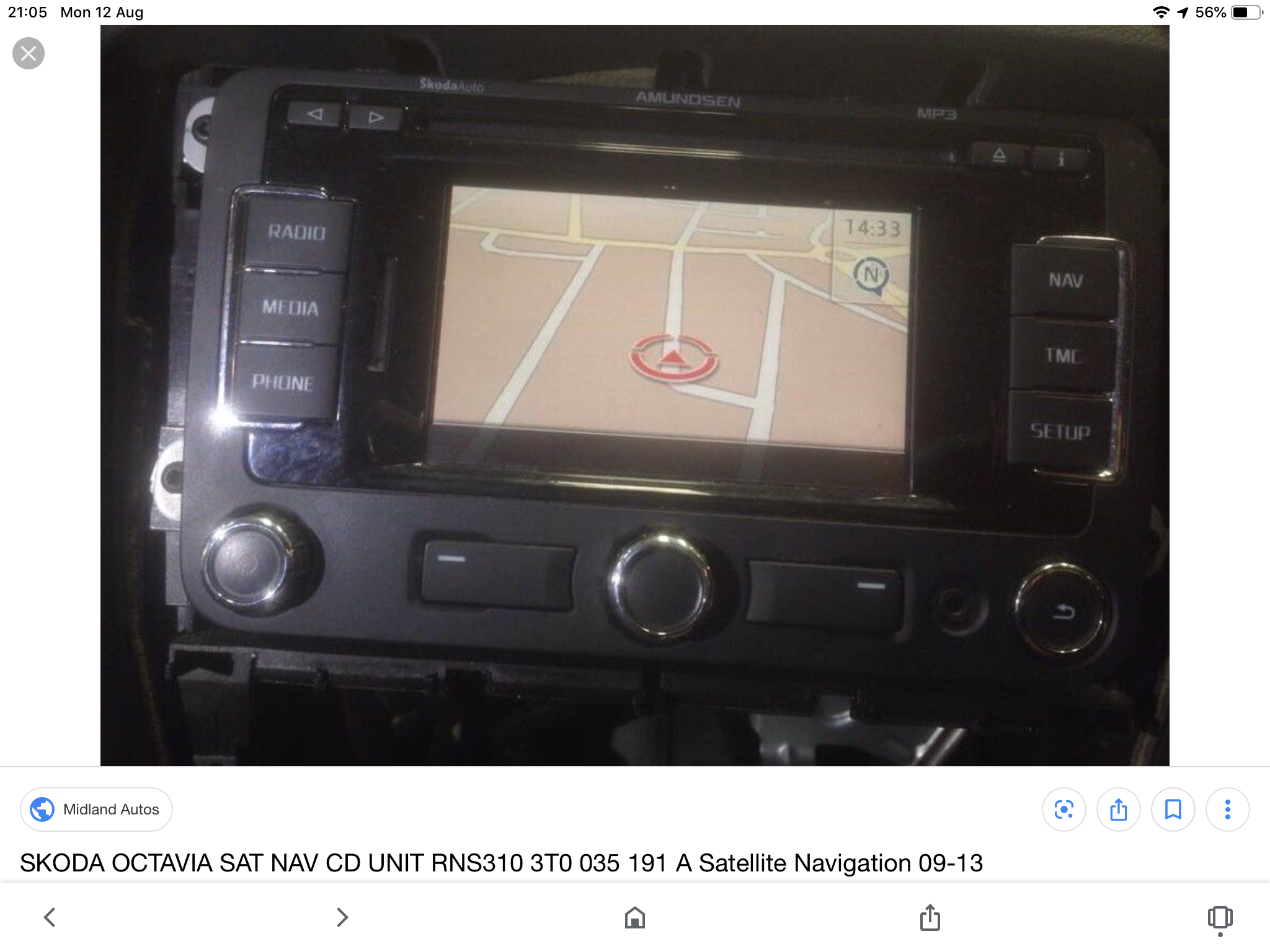

I have a Skoda sat nav. No sd card. Can’t see a sd slot in glove compartment. There is a slot on the side of the screen. How do I find out what I need. Thanks
The picture is similar to the sat nav I have.
The Factory fit for your car is the newer RNS315.
That said the RNS310 may be OK.
@Rustynuts is the expert on here.
Similar, or the same?
If you can use sat nav without the SD card (or perhaps a cd) then you have an Amundsen+. Updated are via a new SD card which is unused, as once used they lock to the original unit they're used on and can't be transferred.
Dealers will probably sell you a card which will render your unit unusable (V11 or V10) but you can pop onto eBay and buy V9 maps (which are stable and will be fine) for the VW RNS315 for about £25.

More or less, yes. You have to tell it to copy the card onto the machine, but other than that it's as you say.
