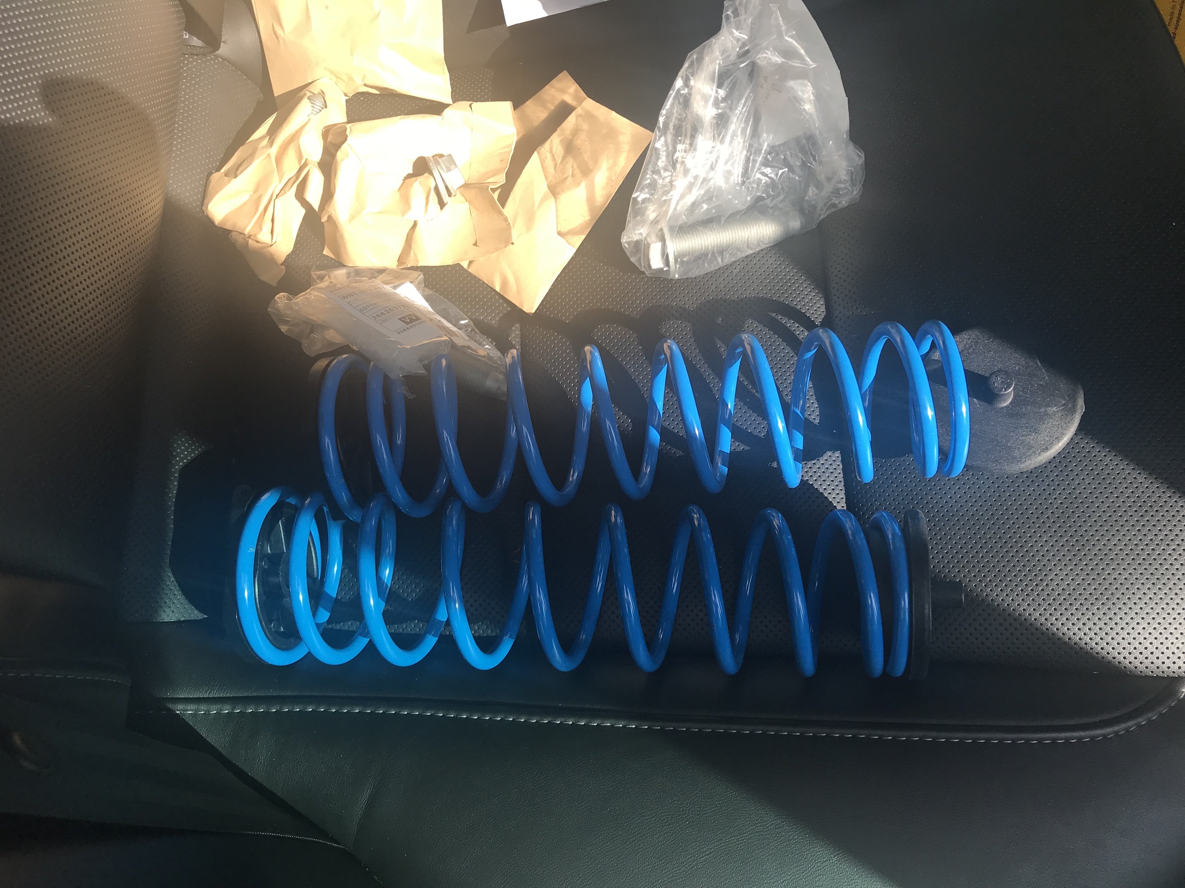

So.... I went for a MAD kit which utilises an additional internal spring which raises the ride height very slightly ( which I don’t mind as I retrofitted a removable tow bar and an AGM battery set up from the 3.6 Superb in the boot.

I have also ordered the Bilstein B6 rear shocks as being a 12 plate, my shocks will be tired by now anyway.
Still waiting for those to arrive so don’t have any pics yet.
TPS supplied the new nuts and bolts required for the swap out, watch this space.

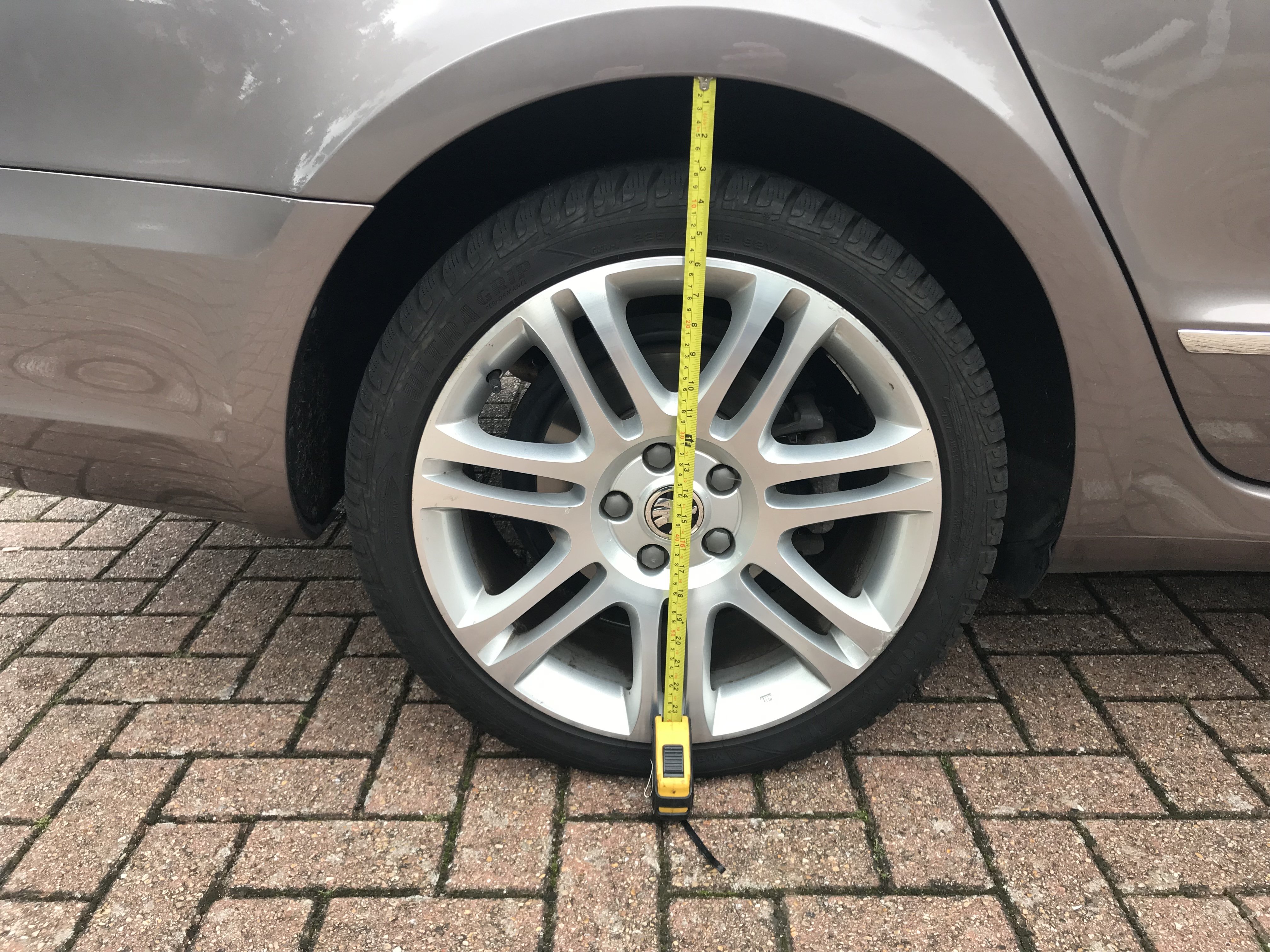

I  will post ride height info here when I've fitted the kit as still waiting for the shocks to arrive.

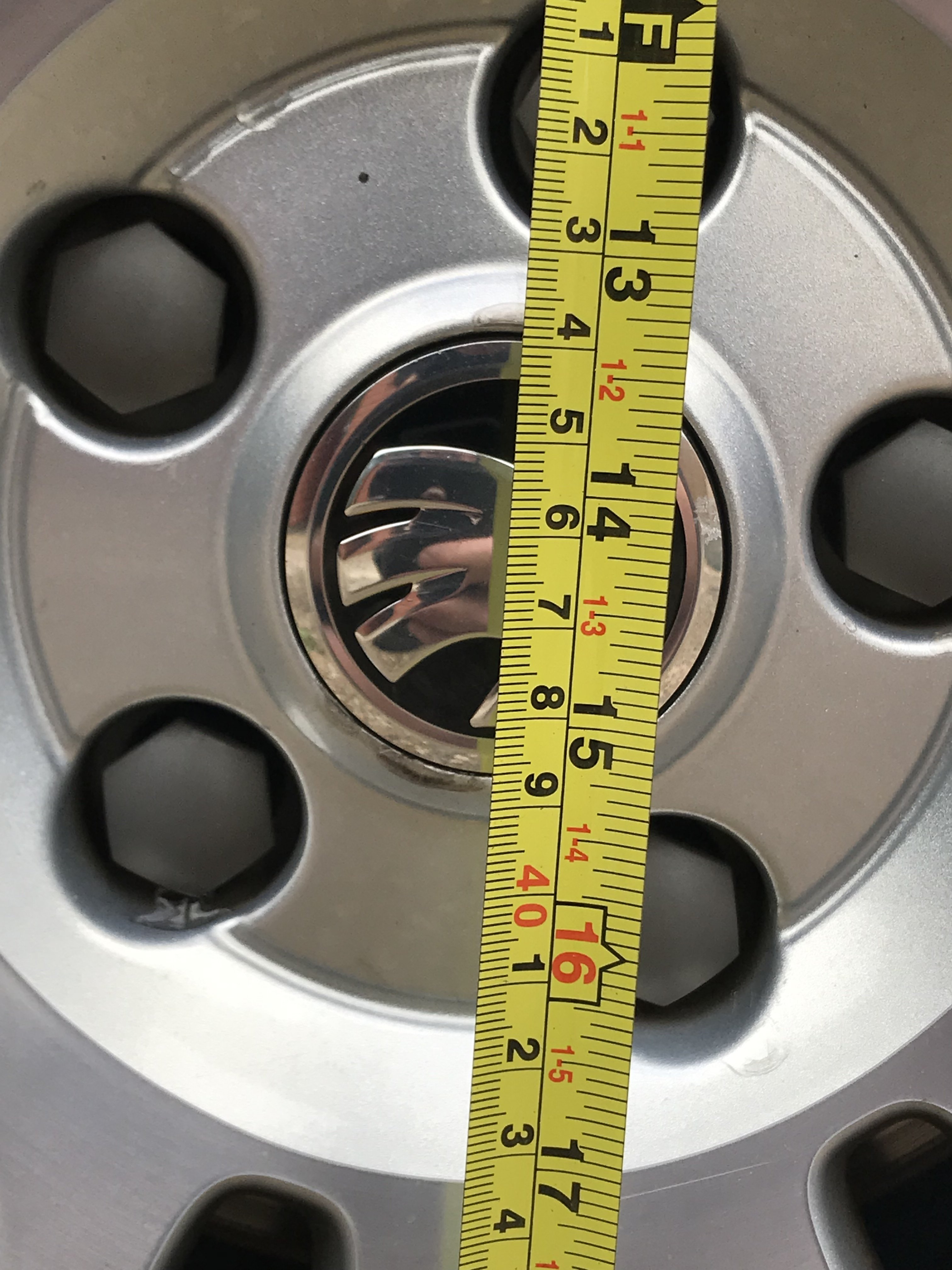

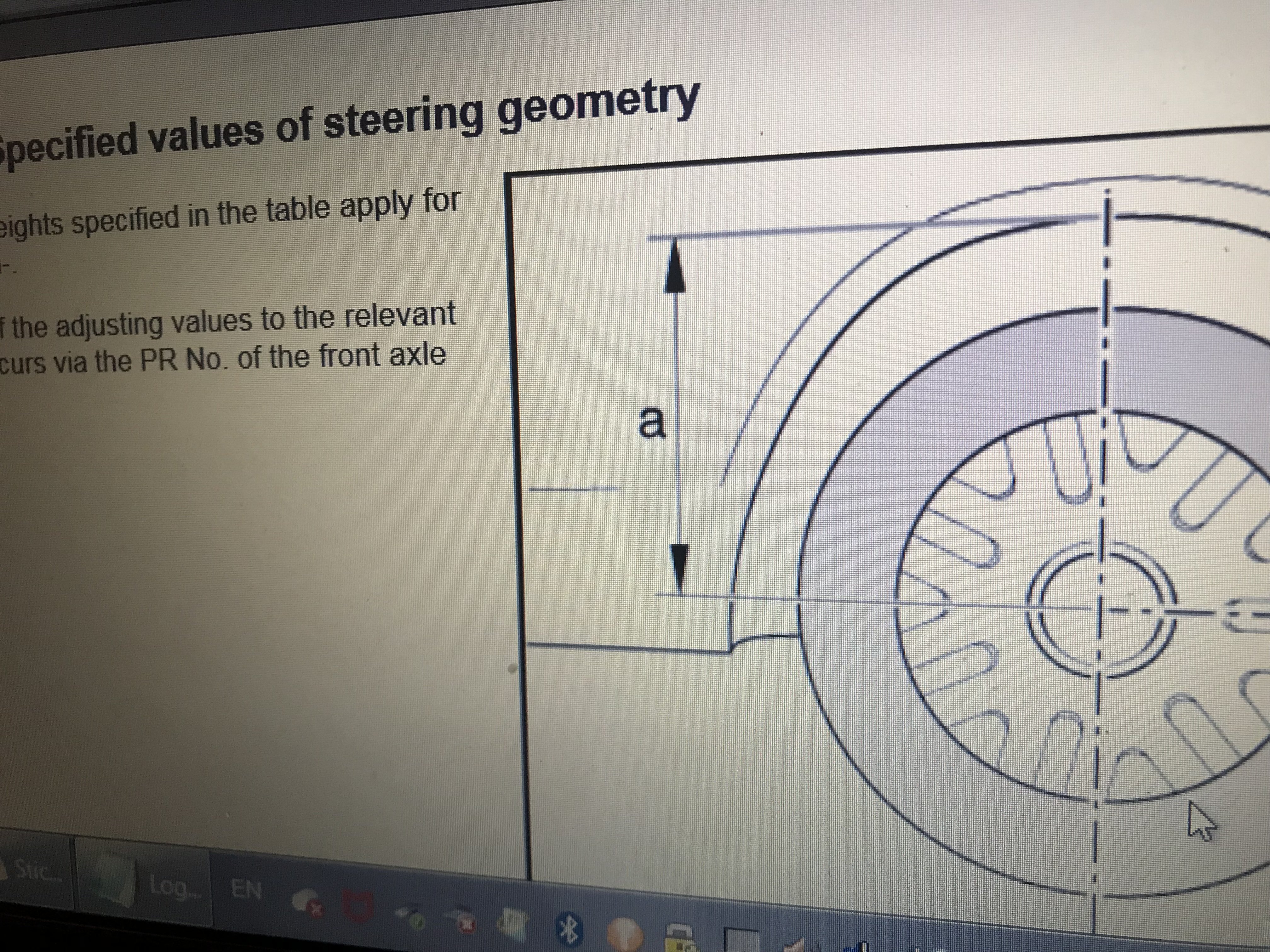

With the battery mod and removable tow bar it measured quite low at 365mm unladen.

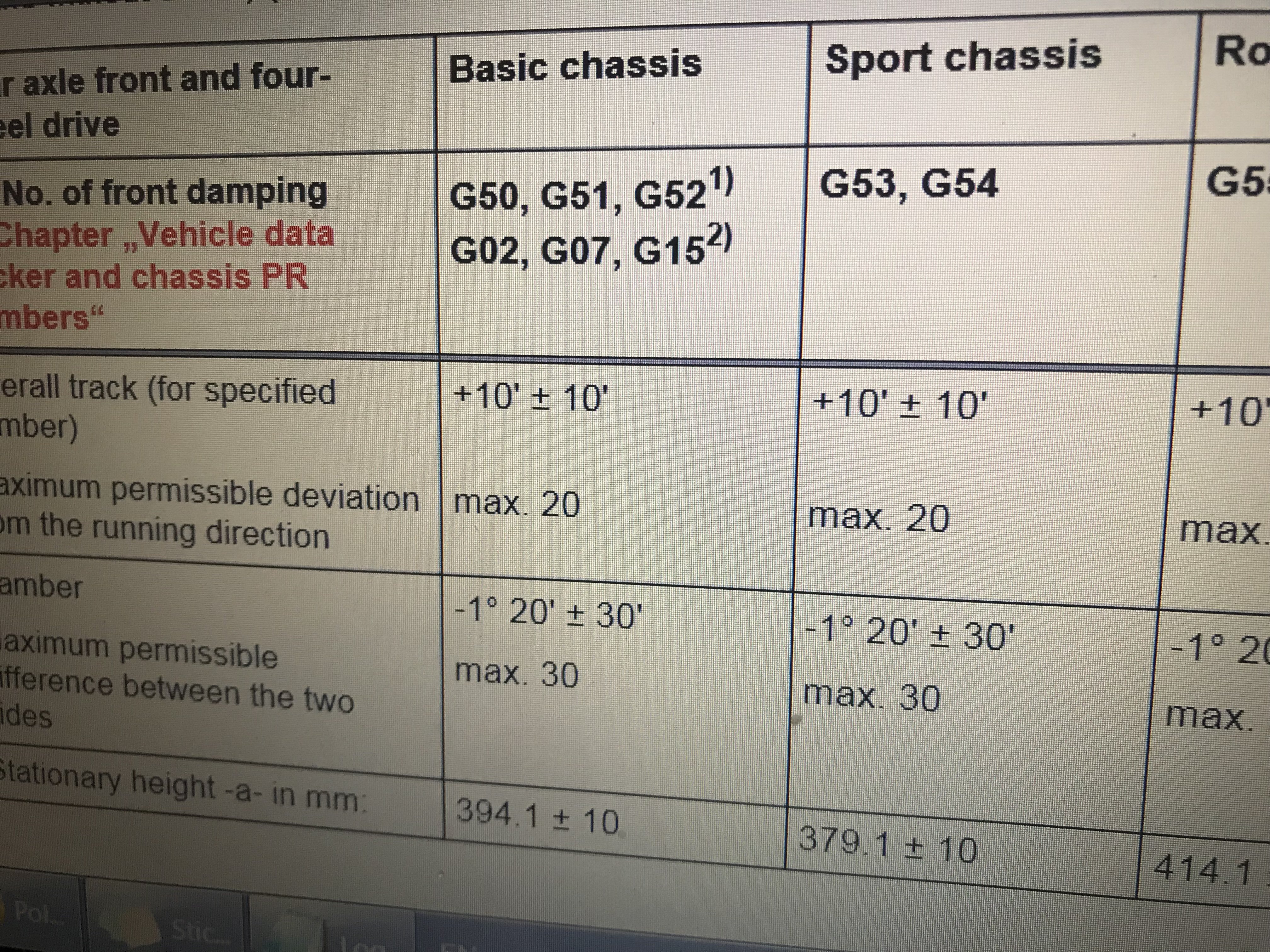

Looking at dimension (a) from the manual states the reading should be between 384 and 404mm.

When setting the torque of the new bolts, you need to compress the suspension(just used a second jack)  to the measured dimension (a) to set the position of the hub so as not to twist the rubber bushes. I left the springs out while setting (a)  to make it easier to torque the shock bolt as with the assister springs and the normal springs, it was starting to lift the car off the jack. The manual says to strap the lift to the car body to prevent this happening.

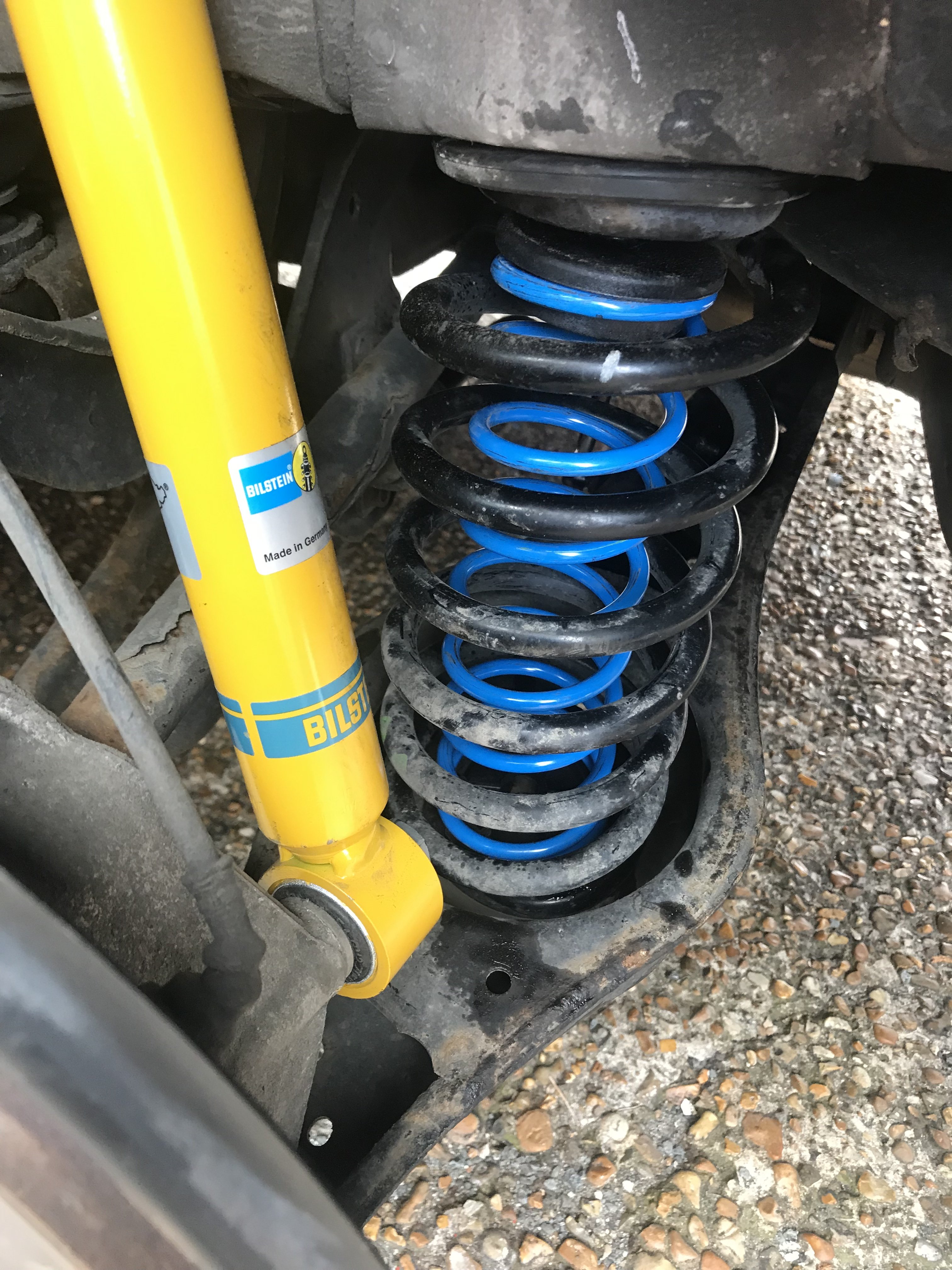

imageproxy.php?img=&key=66c1d7df650950daMuch happier with it now.

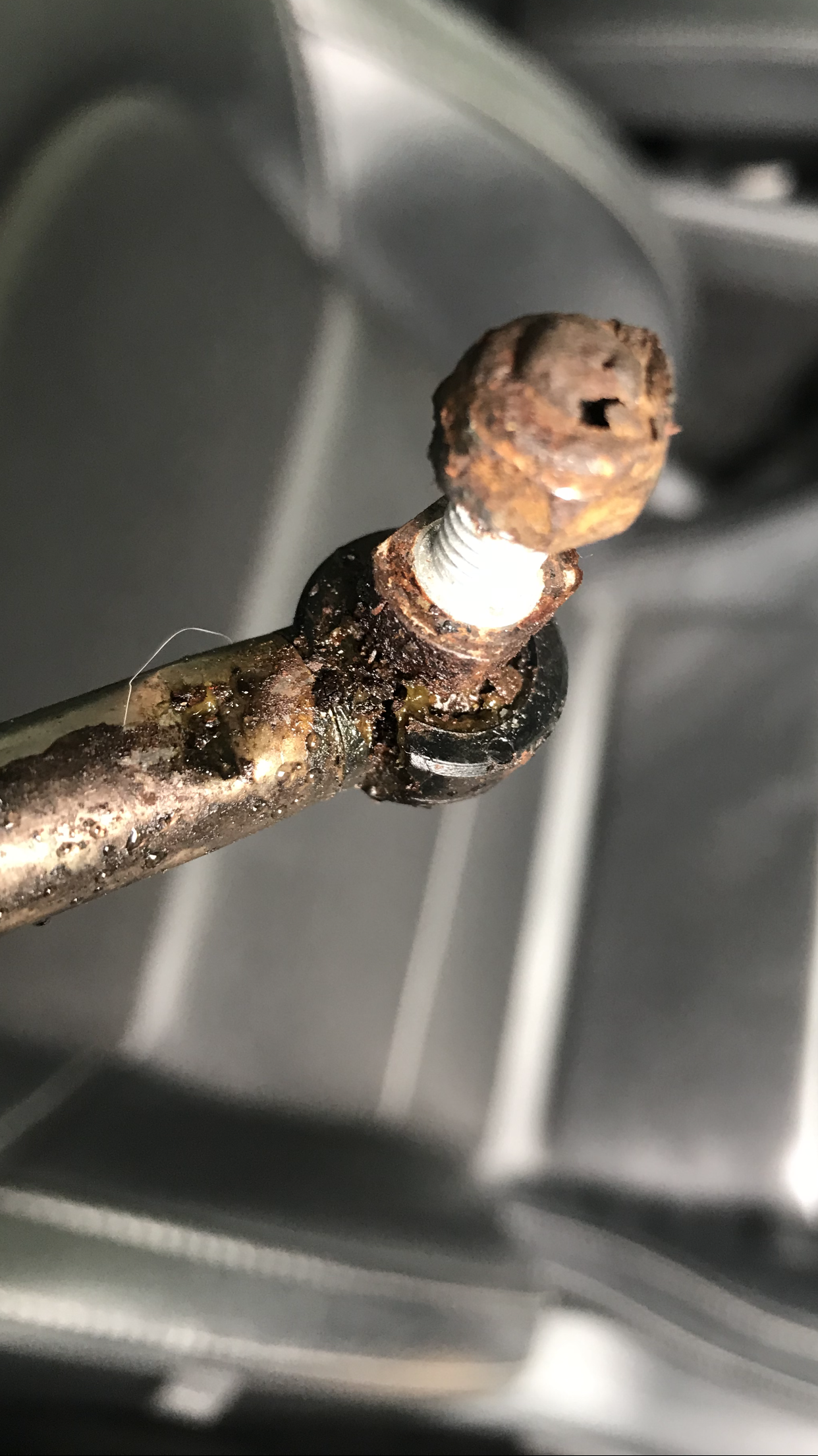

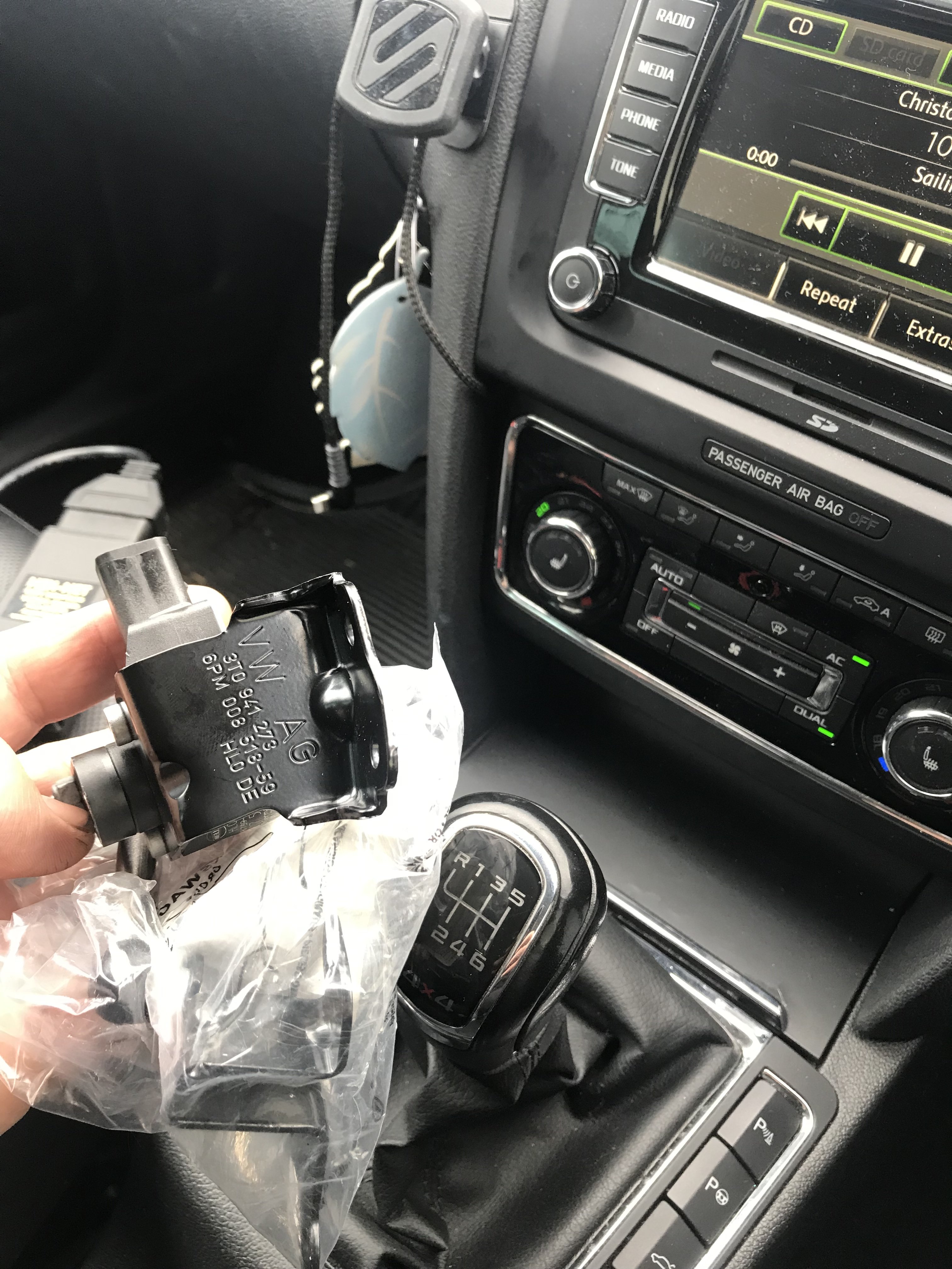

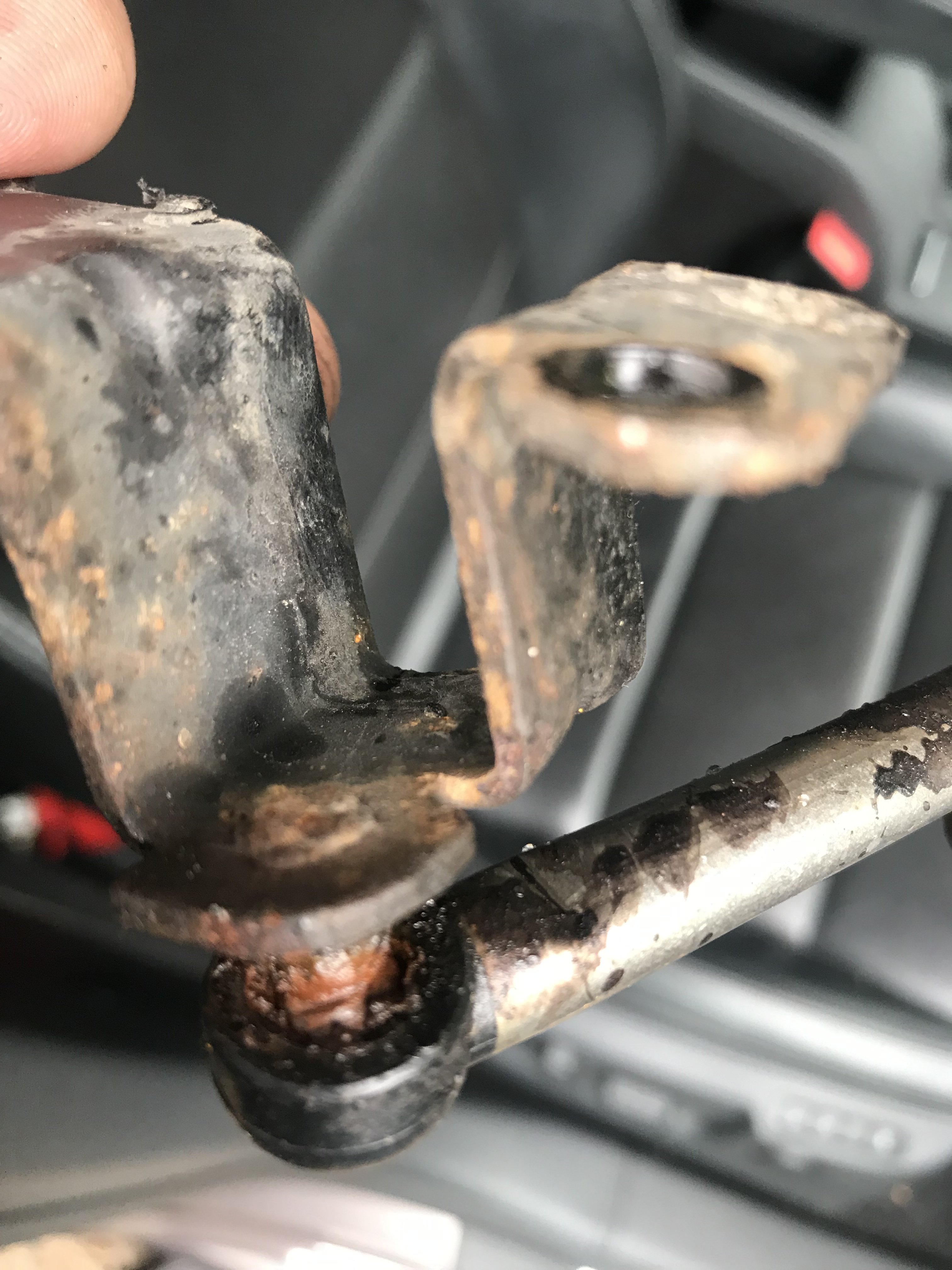

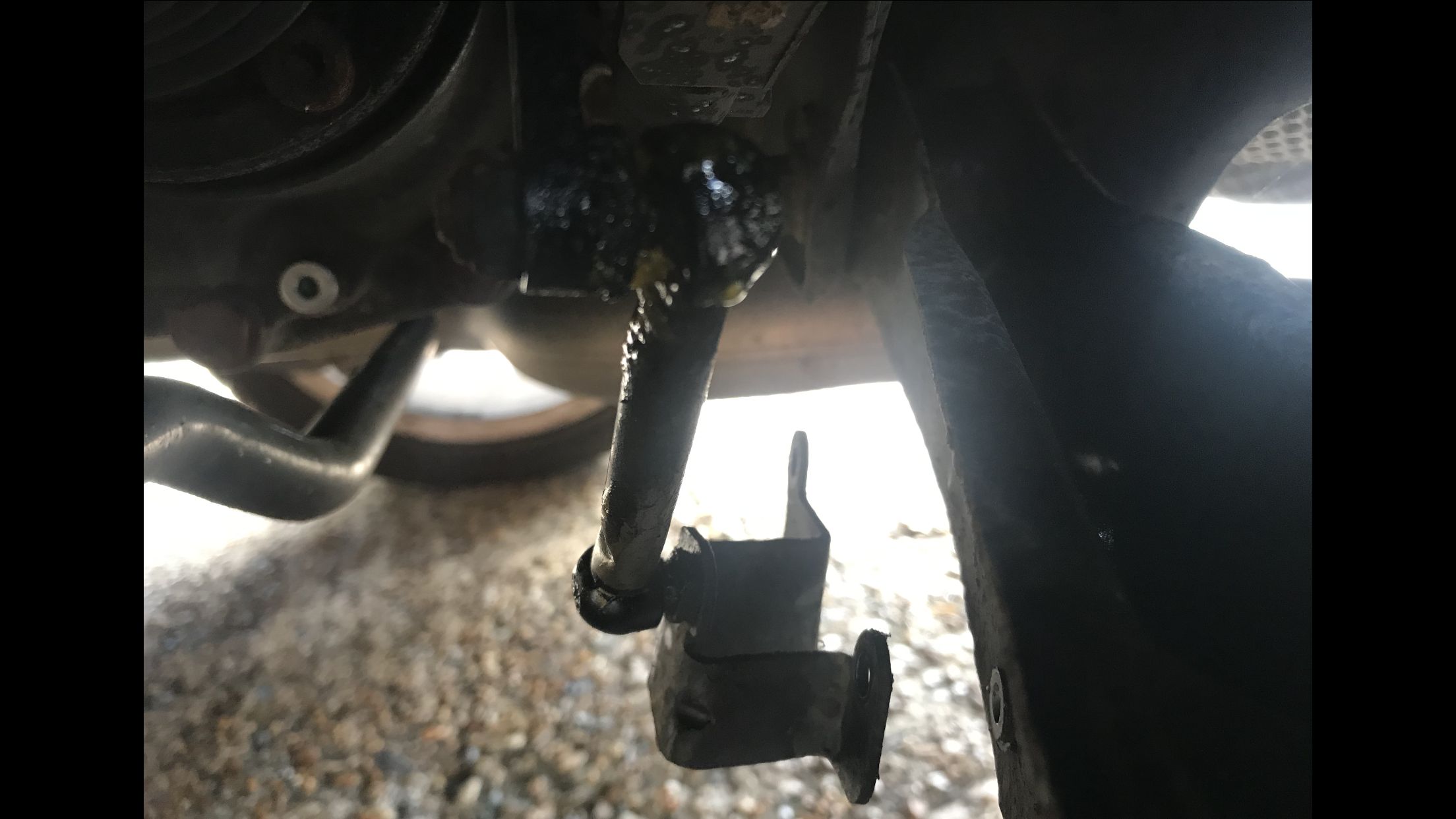

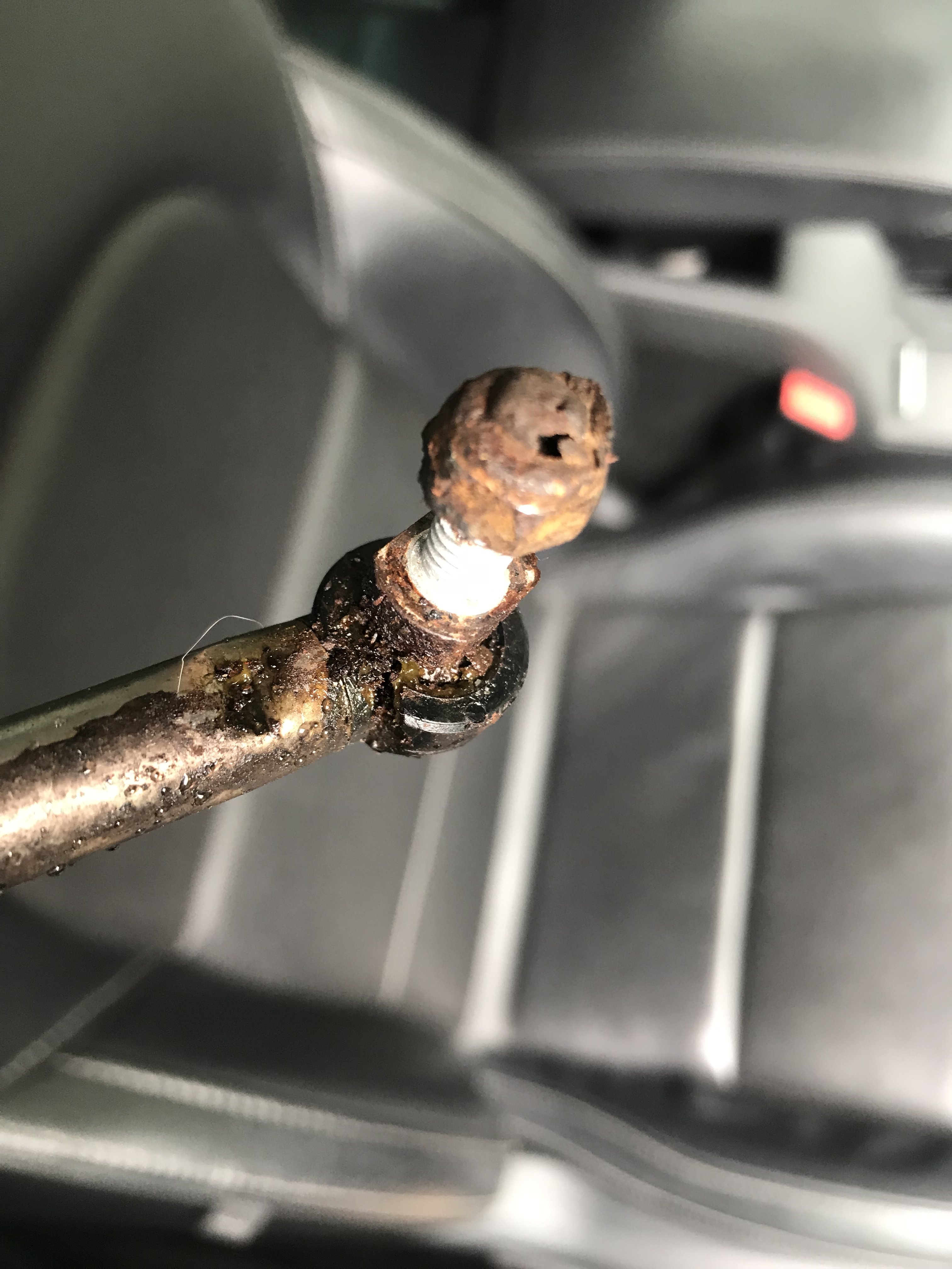

Had to order a new ride height sensor, the ball link was seized solid and broke the plastic  end which was hanging on giving the suspension movement, glad I spotted it prior to the off, would have been a mare to sort in France.
Just need to do basic settings and borrow a beam setter at local MOT station.

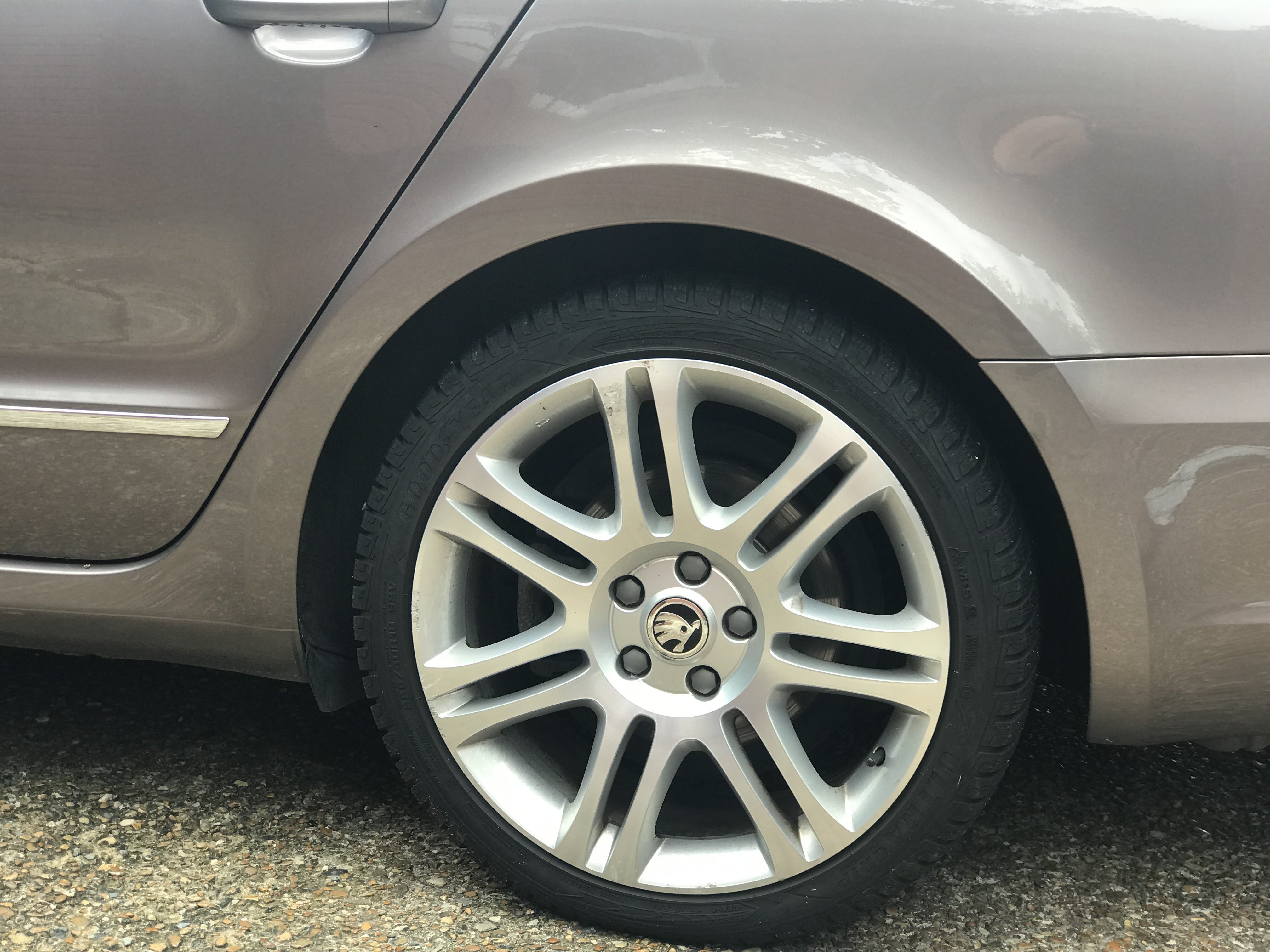

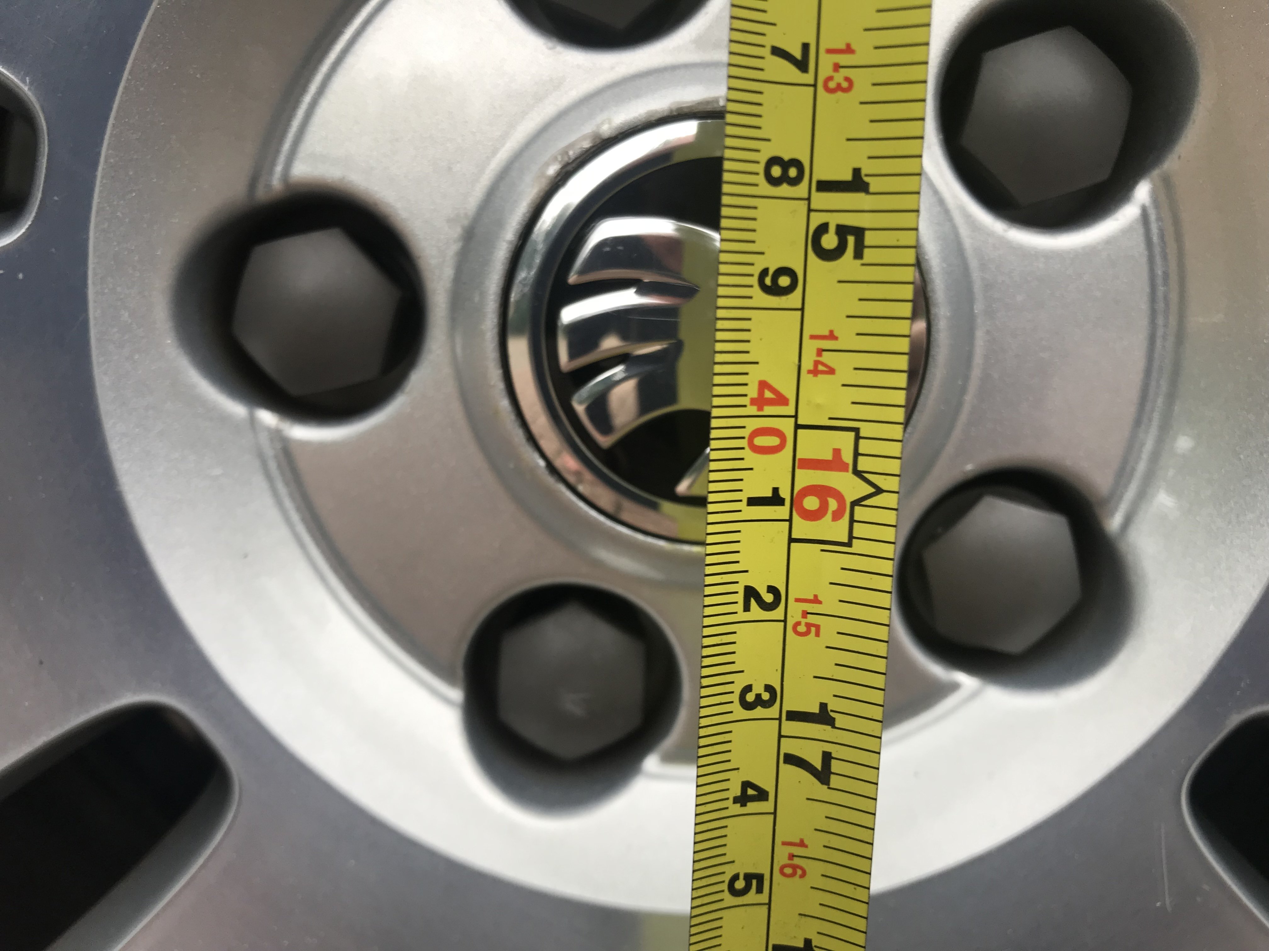

Happy with the ride height too 394 mm ish
The ball is seized solid, filled the new link joints with plastic friendly grease and replaced all five corroded mounting screws.

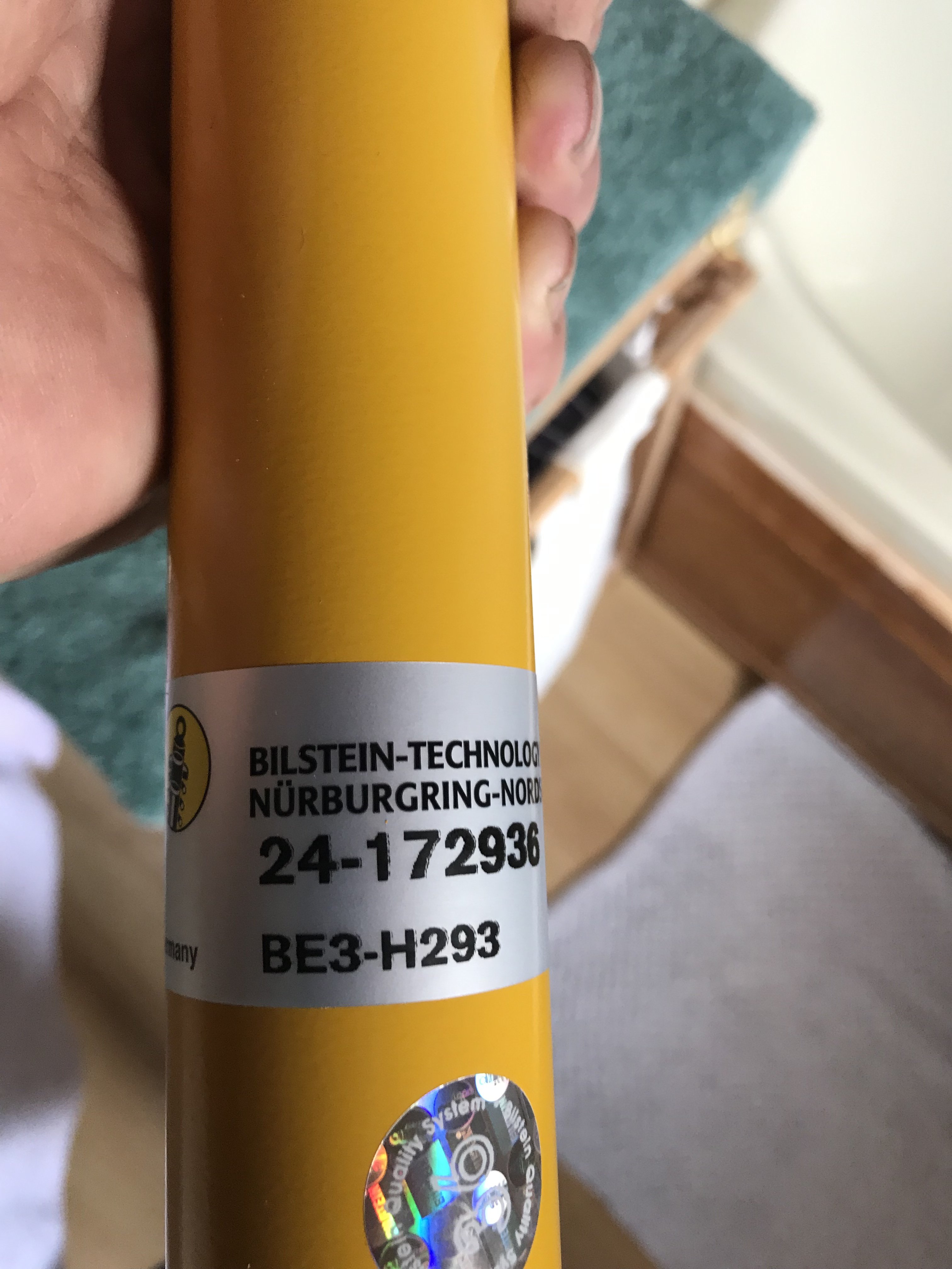

From these guys:
Go to the store and put the info in for your car as may be slightly different part number (prob not though).
Mine is a 125kW diesel estate with 4wd.
The shocks do not come with a dust cover/bump stop, if yours are split or broken, they do a kit, or you can buy genuine from TPS/ or Skoda (if not in trade).
The price is each so DONT forget to order two in the drop down menu.
It comes with it’s own top nut which is a different thread to the Sachs which was fitted to mine so don’t waste money buying genuine top nuts.

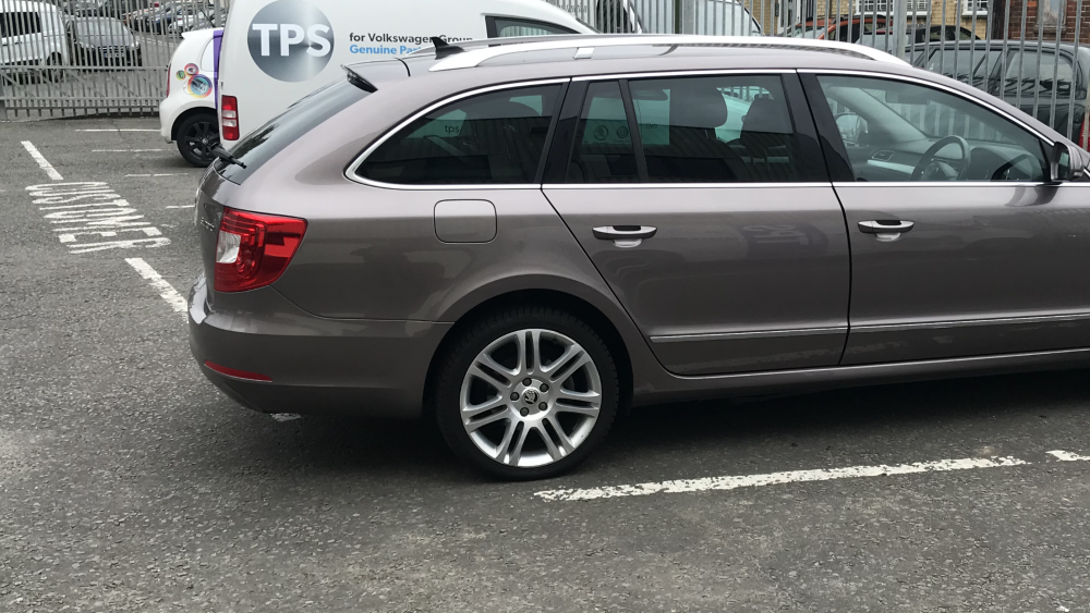

Well impressed with this setup. Very smooth drive, just stopped for first refuel North of Troyes on the A26. No bouncing around like before when loaded. No bump thump you sometimes get with sports suspension (which this is not, go for the B8 type if you want that).
