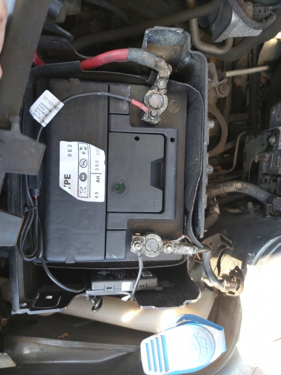

Hello I just had a look and I cannot see any fuses initially?
Did you lift the top cover on the battery?
Yes I have I could not see any fuses
You have lifted the whole thing off. The cover separates into two.
Oh okay I see thank you :)

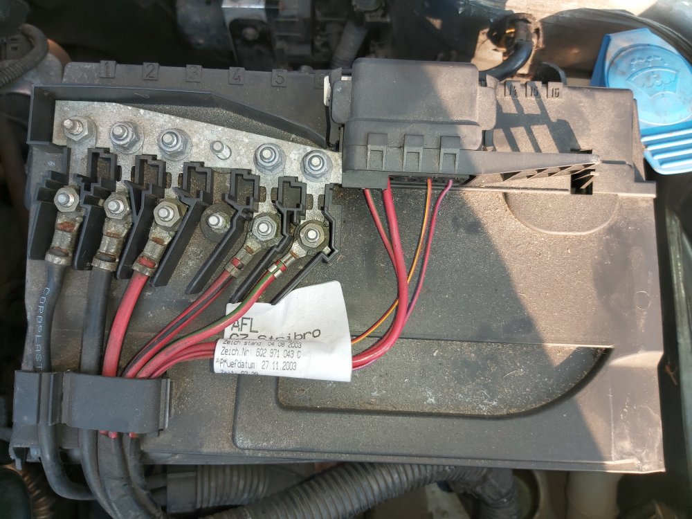

Try to get a close-up of the right-hand one of those, with red/green wire going to it, or give it a gentle push in the middle to see if it cracks in half.

They are known fail this is true. Always worth checking that fuse first though.
Oh okay I see the wires seem to be fine and are not broken even when I nudge them. So can the whole ABS pump be removed from the car quite easily ? From what I have seen its sitting on a bracket so would it be easier to take the bracket off with the pump connected to it ? I will probably try to get it reconditioned so I will not have to pair it to the car :) just need to know if it's difficult to get out.
