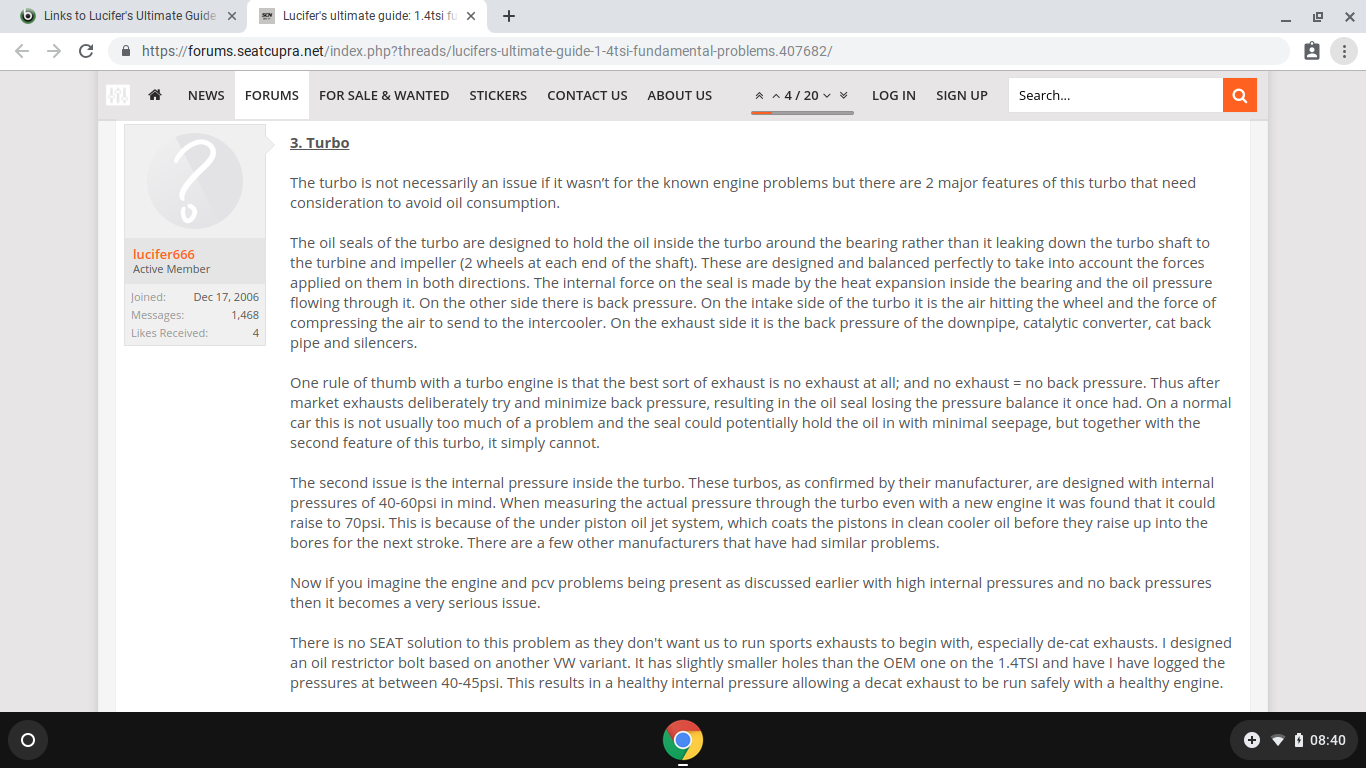

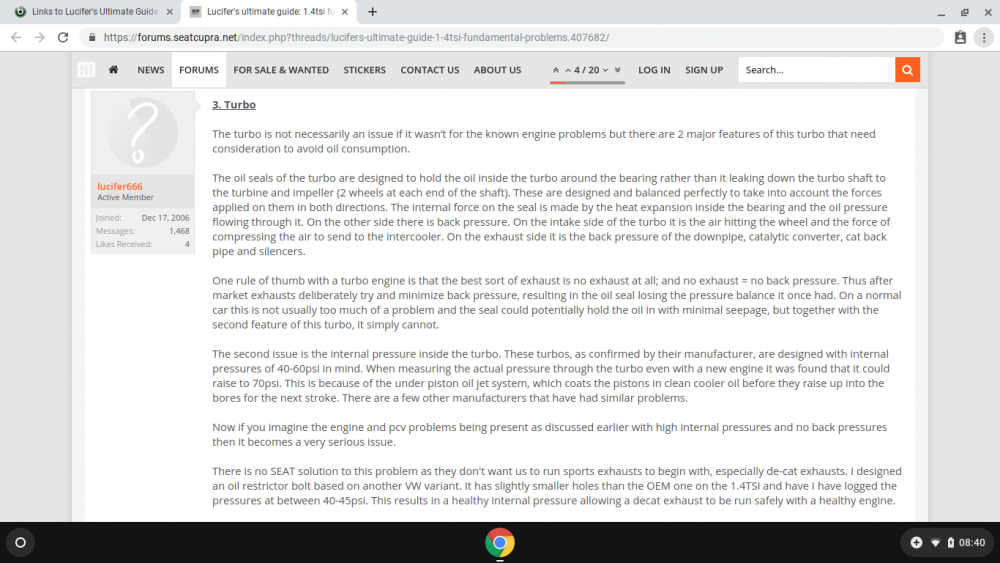

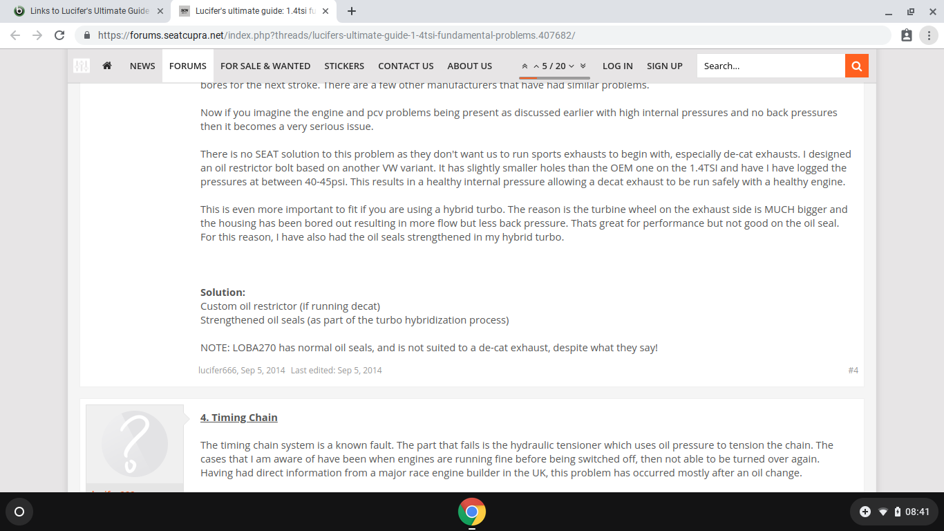

Lucifers Ultimate Guide Part 1 & 2 Links pinned up the page.

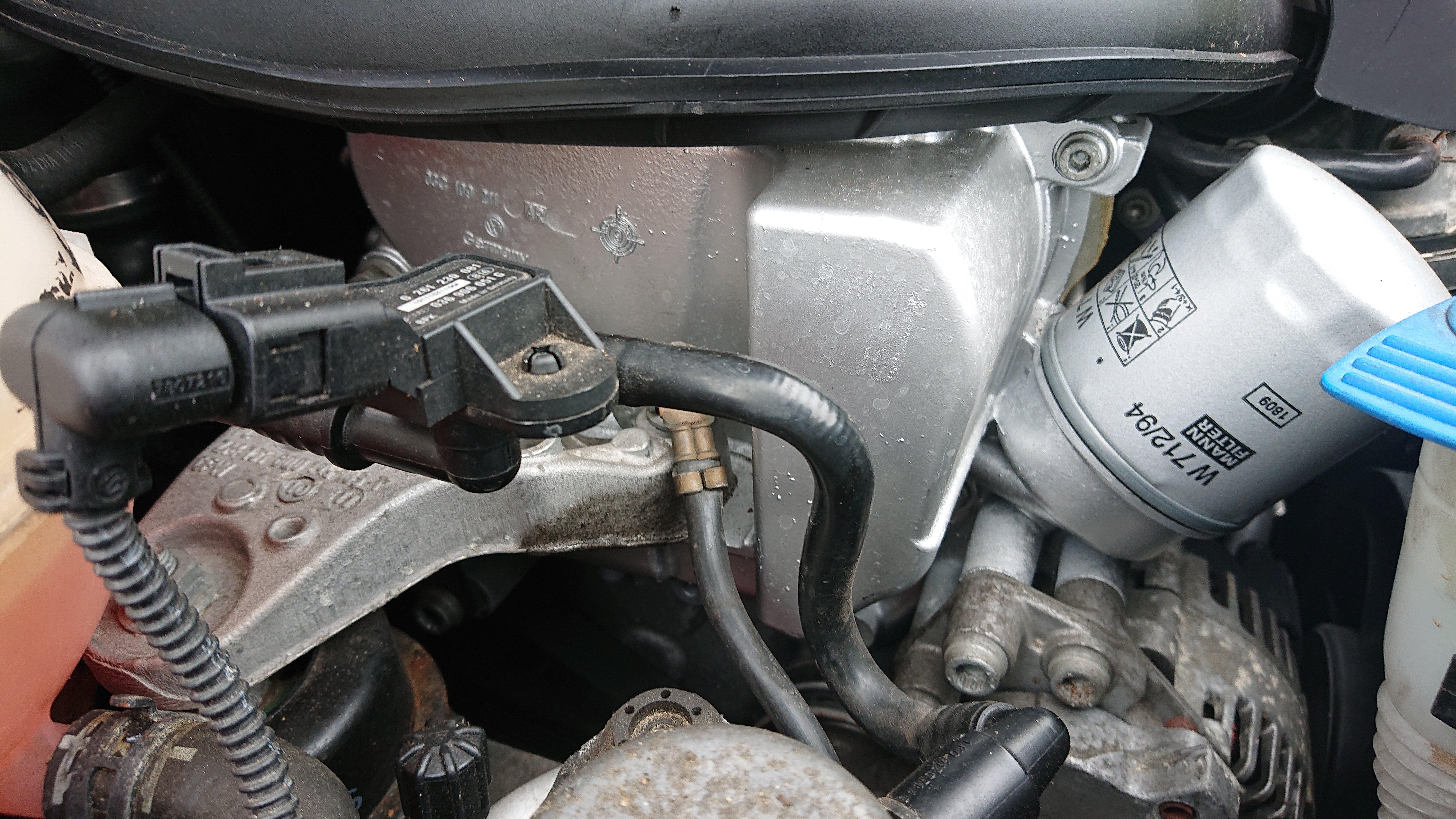

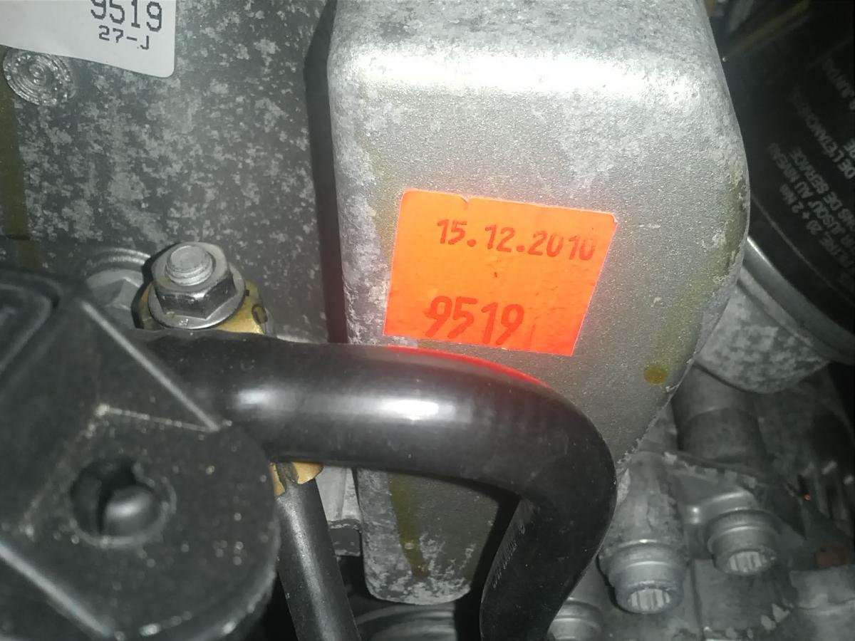

Look at the small orange sticker for a build date of the engine.  Driver side right hand drive.
Refurbished or new.
Look at the 4 numbers and see if the 4 on the ECU match.   eg 9519

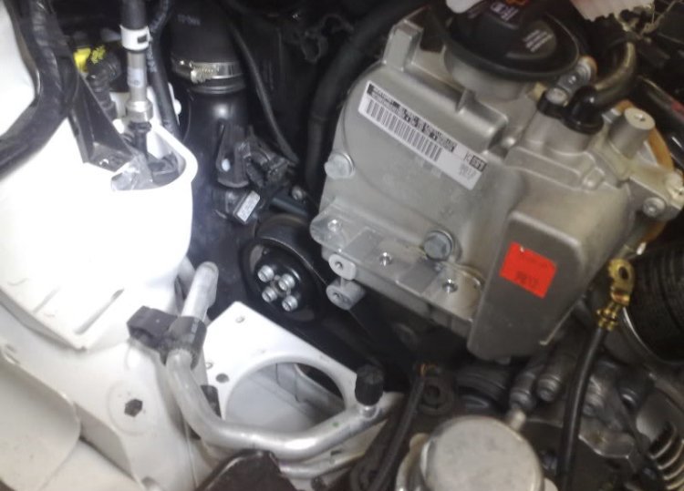

No stickers on mine nothing

To my eye and i have seen a few that is a 'refurbished engine from the VW plant in Germany' or some other plant.
Looks not as well painted though, and the bar code etc is usually there.
*Nothing wrong with that if a VW refurbished, it might well have the later Oil Spray Jets.*
