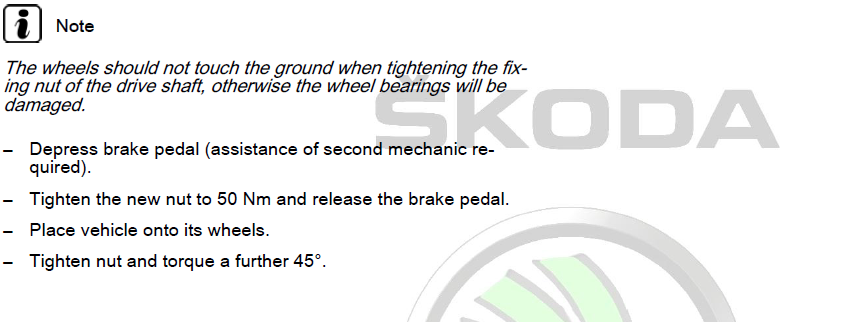

My Haynes book for 6R Polo agrees with what you wrote, I'd think that not much has changed over the years in that area.
Yes, it's the same. This extract is from the Fabia III 2015 > Workshop Manual.
Thanks a lot for clearing that up!
