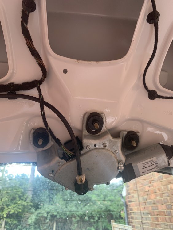

finally took the boot trim trim off to explore the leaking rear wiper.
The motor works fine and it appears the pipe is in tact but it’s obvious it’s been leaking for a while now and it’s coming from the little black plastic nipple and assembly that attaches the pipe too. I expect there’s a small hole somewhere

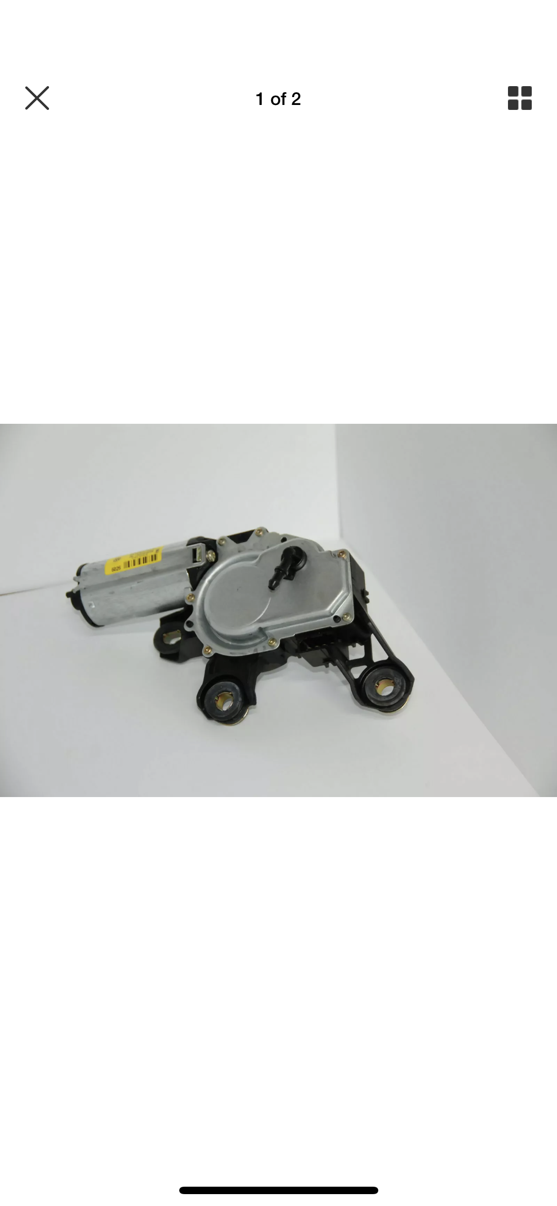

I have found a brand new Valeo rear wiper motor part number Vw Seat Skoda Audi Rear Wiper Motor 1J6955711G
I’m guessing it’s for a MK5 golf or seat Leon MK2 but will this fit an Octavia?
photos of the part look very similar to the broken part on my vehicle as per below. Any one got any ideas?
The motor is still working but the black connecter with nipple is leaking which no doubt means the motor will fry itself soon!

Thanks that’s really useful however the link to one on aliexpress is for an estate as it doesn’t have the water connector.
ill have to keep searching as my original point was surely any motor from across the VAG range should fit as they all look the same
